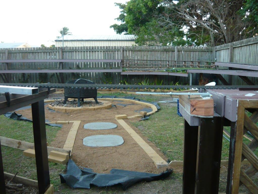

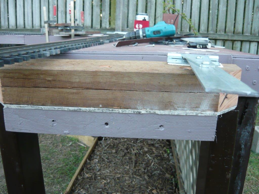

The new mounting block has been made from wood and work on the first hinge has started.
Unfortunately I used some hardwood from the $2 per 1.2M rack and it is cut crooked i.e. 32mm on one side and 30mm on the other.
Luckily I have 2 different sized mounting bolts and the longer one just happens to bring the hinge top level with the baseboard.
I have used a couple of shims to get the hinge top level with the approach baseboard.

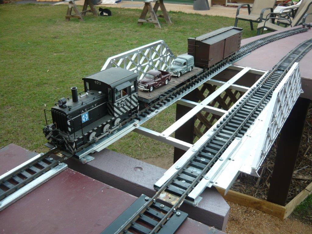

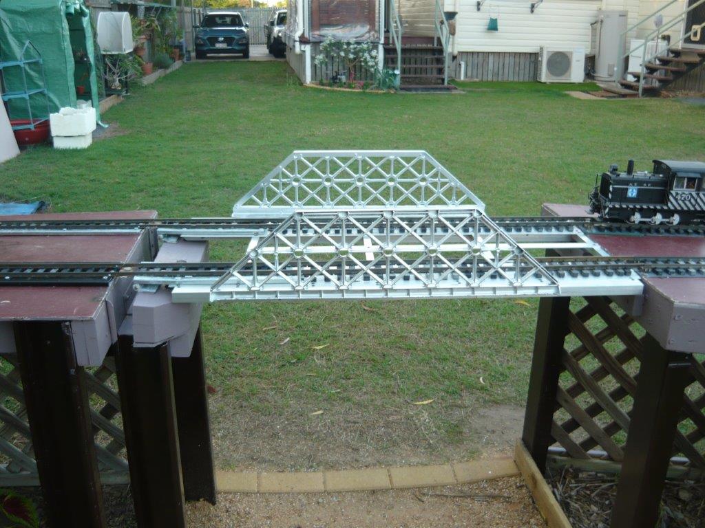

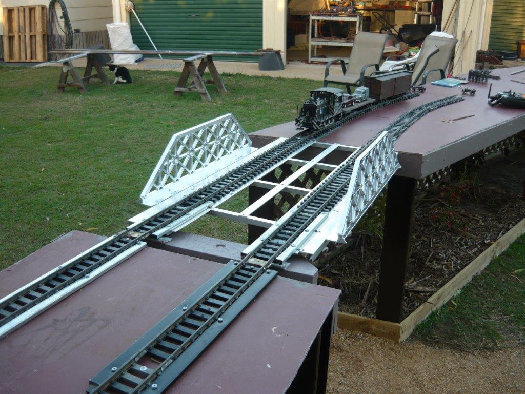

The lift up bridge is finished!!!
From a concept put forth by a modeller Korm Kormsen who frequents a US forum of putting the hinge under the track, as opposed to the convention of having the hinge joint above the track, to the finished thing has been a Ben Hur type production.
Trains can now cross the entrance to the firepit area with no problems.

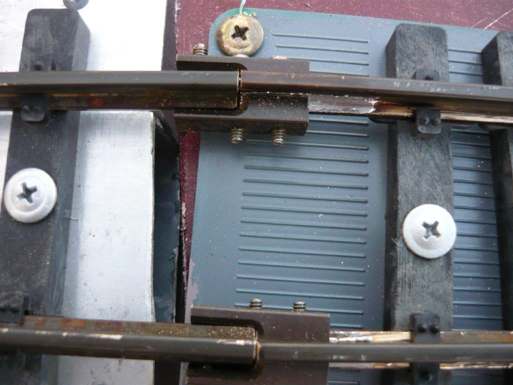

Bridge non hinge end is located by using "Hillmans" lift out bridge clamps.
All that need to be done is to design and manufacture a safety device that stops trains from running off the edge when the bridge is open, I use battery power so breaking the track circuit does not apply, some form of physical barrier will be required possibly even a catch point.
More thought on the safety device is required, any suggestions folks???
Blog will be updated shortly.
