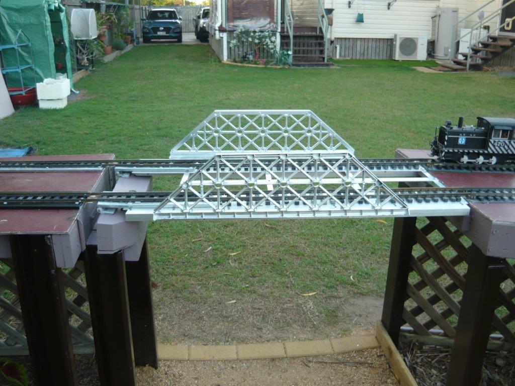

Re: Lift up bridge questions
The lift up bridge is finished!!!
From a concept put forth by a modeller Korm Kormsen who frequents a US forum of putting the hinge under the track, as opposed to the convention of having the hinge joint above the track, to the finished thing has been a Ben Hur type production.
Trains can now cross the entrance to the firepit area with no problems.
Bridge non hinge end is located by using "Hillmans" lift out bridge clamps.
All that need to be done is to design and manufacture a safety device that stops trains from running off the edge when the bridge is open, I use battery power so breaking the track circuit does not apply, some form of physical barrier will be required possibly even a catch point.
More thought on the safety device is required, any suggestions folks???
Blog will be updated shortly.

As for the open side, could you have a spring loaded plate which is held down by the weight of the bridge when closed but springs up automatically as it is opened? A suitably positioned hook/latch could then hold it up in position.
Depending on the actual design it might be possible to have the plate counterbalanced rather than spring loaded?
just a few thoughts.
You presumably don't need anything at the hinge side, since the bridge itself would be in the way of a runaway?GAP wrote: Thu Jun 18, 2020 9:28 am

Philip's idea sounds good, but I tend to go for the simplest solutions. I'd just have a piece of wood with a couple of dowels that slot into a couple of holes either side of the track. Of course, being non automatic, you'd have to remember to slot it in when you raise the bridge.
I have a couple of lift out bridges on the PLR, and so far I've never forgotten to install them when running. However, neither is on a main thoroughfare so there's very little pedestrian traffic through them when trains are running.

A slot-in barrier would probably be the simplest way to solve the issue and be perfectly adequate for the situation if it was for one person to control. In this case though, especially with the fire pit in the centre as an entertainment area, it looks as though other people, family members and guests, might have to be considered for access and each would need to be advised on the method, and importance, of ensuring the system was employed at all times. Children would almost certainly forget and adults might not appreciate the idea of being 'told' what to do.
An automatic system would be my own preference.

Graham, if you have another "bridge" hinged at the opposite side to the train bridge hinge, slightly lower, when the bridge is lifted, to get past you would then need to lift this other section up, creating a physical barrier.

My thought at the moment is a lever with the pivot offset that the bridge pushes on when closed, so the end under the bridge is down and the other end is up.
This connects via a simple linkage to another lever under the base board again with an offset pivot so that the linkage end is also up and the other end is down.
On the down end of the second lever there is a bar at 90 degrees across it that has 2 rods pointing up.
These rods slide in a tube and protrude between the sleepers when the the second lever moves up ie when the bridge is open and will be in the path of a loco.
The loco will hopefully stop at the protruding rods and not derail but just sit there with wheels slipping, unless of course it is one with a traction tyre which adds a different dimension to the solution.
I would need a fence along one track as it is close the the edge of the baseboard but that is easily doable and would fit in with the theme easily.
I have considered putting some sort of barrier between the rods that slips into a slot cut in the base board but that involves cutting rail and adds an alignment issue.
Hopefully I have explained the idea clear enough.
More though may be required
Edit;
Just had a thought instead of rods just sticking up the could operate boom gates that cross the track, they would look a bit more elegant.
Its amazing what a cuppa can do for the thought process.
