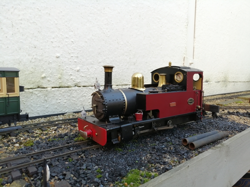

She passed inspection by the owner today after a run around the RWLR so the workshop is ready for new work:
The newly painted boiler wrapper getting it's first outing (the two tone colour scheme may not be everyone's taste I suspect but I like it).
