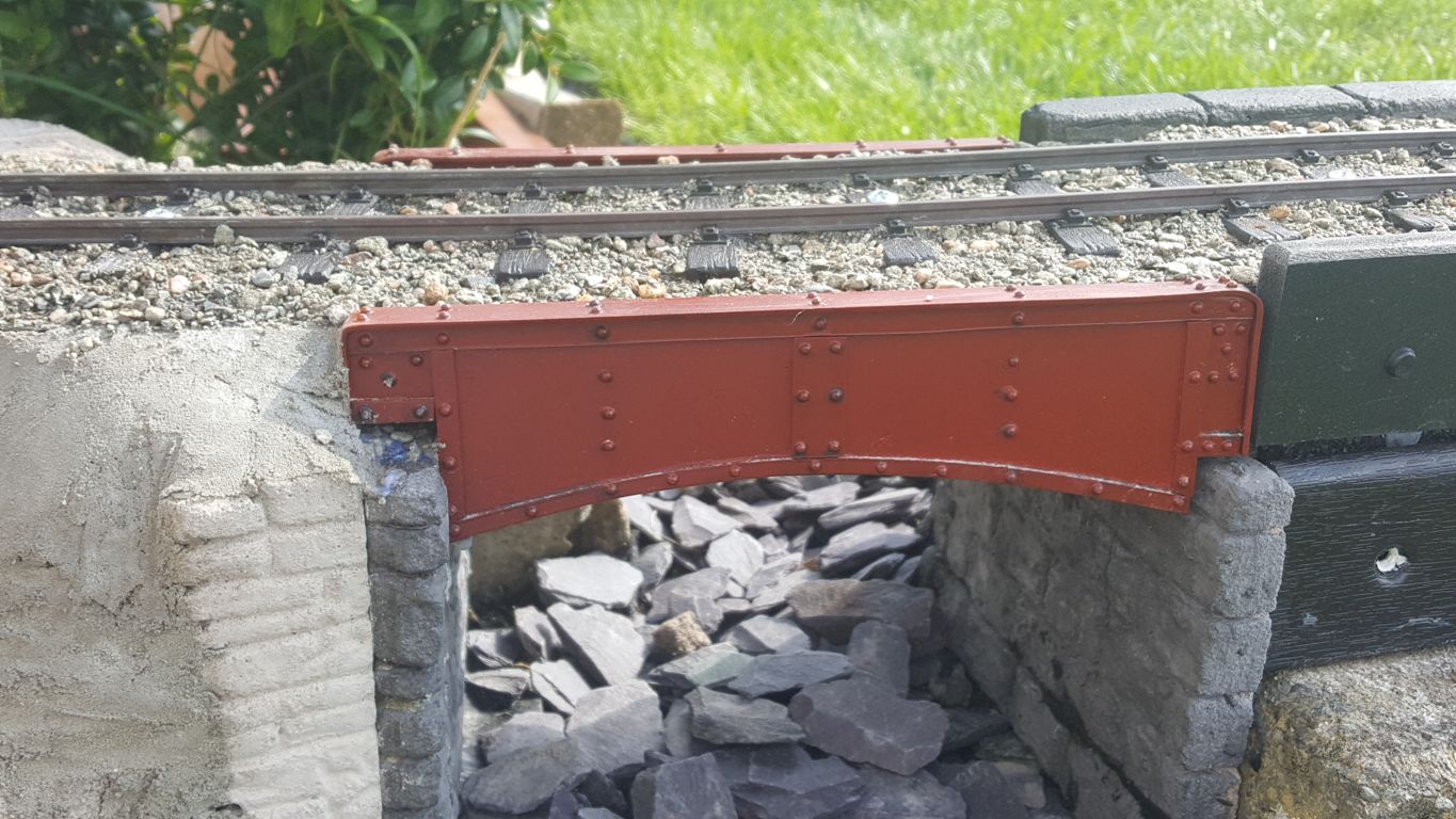

I have pretty much finished the bridge now and it has been fixed in place (with Stixall). Because the bridge is on a curve and the existing causeway is quite narrow, I have fixed the bridge unprototypically with its upper edge at rail height, which means it won't foul locos and rolling stock on the curve. Apart from the moans from the health and safety rep about no protection for PW workers, I think it looks okay, and have invoked rule 8*.
Today has been untypically wall to wall sunshine, but eventually the glare relented enough for me to get photos with somewhat less contrast.
This is the view from the garden side with the River Greta represented by blue slate chippings.
I oversprayed the parts with matt clear lacquer, which for some reason looks a bit shiny in these photos.
2018-09-05 14.09.01_edited.jpeg (203.36 KiB) Viewed 107000 times
And the view from the field side.
I have also reballasted this section, and thought I would show my weatherproofing which stays in place for 3 or 4 days. They are just cheap polytunnels from Wilkinson's, which spike into the ground either side of the ballasted area. As there's no ground to spike into on the field side here, it's supported by plastic clamps to the fence wire.

That looks really good Phil, top marks.
Could you get around the fencing issue by fixing iron posts on the outside faces rather than on the tops? Possibly even cantilevering them out by a few mm? Just a thought, depends on how tight the clearances are to start with.

May I ask how thick your moulded concrete 'stone' panels are, please? It's difficult to judge from the pictures but they look about 15mm?

philipy wrote: Mon Sep 17, 2018 2:12 pm Phil,
With nothing better to do, I'm cogitating my stream bridge again, and your thread a few weeks ago resurrected a related idea on my 'to do' list from years ago.
Shouldn't you be wafting cool air over memsahib and providing daiquiri by the pint? :lol:
I think the wood formers I used were 18mm deep, so not a bad guess. I also incorporated a piece of galvanised wire mesh to provide some strength lengthways. Even so, a couple have cracked, but the wire stops them falling apart.
