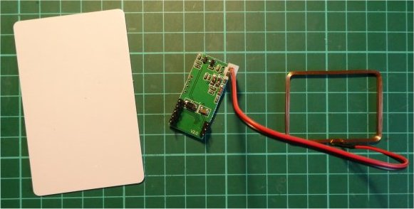

I've fitted an L&B open wagon with various experimental circuits. This includes a location device, sound and eventually a camera.
I've looked at various ways of impementing location detection. Ideally GPS would have been good but it isn't accurate enough at this scale. There is also magnets and Infra-Red which is commercially available for LGB type layouts. I've tried magnets, with two sensors either side of the wagon and that sort of works but in the end I decided to opt for RFID (radio frequency identification) contactless cards.
There are two main types of contactless cards Those that operate at 125kHz are used in security and access control. Those that operate at 13.5Mhz are used in banking and concession bus passes. I've tried both but have chosen 125kHz because of the greater range and the aerial is easier to hide.
card reader.jpg (31.78 KiB) Viewed 14502 times
The cards (painted and hidden with ballast) are placed under the track and the card reader is located in the wagon with the coil underneath. As the wagon passes over the card it will register the card number and from this the location will be known. The cards can be read at a distance up to 3cms but because the train is moving, the coil has to be placed closer than this to give time for the card to be powered and to transmit it's serial number.
The location id will be sent as an MQTT message for any other device to see. The hand-held controller and PC controller will display the named location and locos will use it for automatic operation.
The components within the wagon are:
   PCB containing Wemos D1 mini microcontroller, step-up regulator and Dfplayer sound chip
   RDM6300 125Khz control board
   Lithium battery and associated charing/protection circuitry
   Loudspeaker
   Coil (underneath)
The automation schedule is programmed using a simple code. This is downloaded from a textfile on the Raspberry Pi when the loco is switched on, so it can be easily changed. A future option will enable the hand-held controller to select from a number of different schedules.
