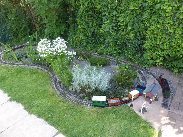

To continue the story with a re-post of a photo from my thread in Railways & Layouts, the approximate "natural stopping points" on my railway are as follows:
TRAIN RUNNING CLOCKWISE:
1. Loco nearly at exit from viaduct, whole train on viaduct.
2. Loco just past platform, some of train in station (sometimes it scores a direct hit with the train stopping in the station).
TRAIN RUNNING ANTI-CLOCKWISE:
1. Loco just off viaduct, train partly on viaduct.
2. Loco approaching station, usually near the solar light that is just about visible (this is where I think I should place an outer home signal!).
Obviously the exact locations are rather variable!
I originally laid out the railway thinking that the natural direction for running was anti-clockwise - the view of the train being best from the patio area (to the lower left of the photo); I had a risk-averse approach to facing points. However, it turns out that overspeed derailments - always a risk with manual steam, at least in my experience, and always on the viaduct curve - are most likely in this direction! And the facing point has never been a problem yet.
