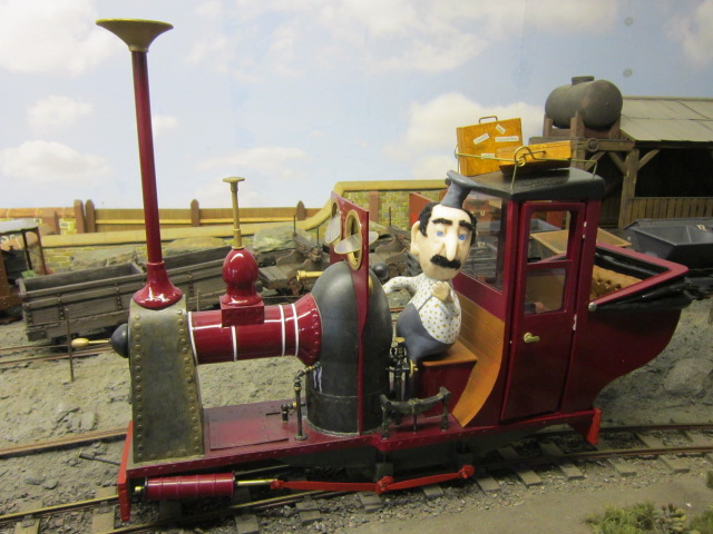

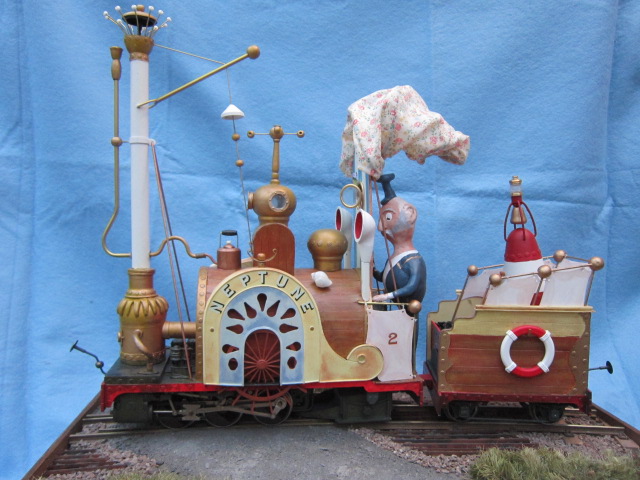

I can see a tunnel would help to disguise the loop on your line but I made a point of not building one myself simply because I occasionally run my Emetts which are a larger scale (about 1:12) and are much taller than any 16mm stock.
They would soon be free of useless attachments such as chimneys etc.......

I like the idea of Emetts running on my line to aid the entertainment value for visitors
even a blue tank engine for the little tackers
