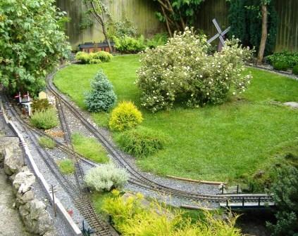

stoker:115496 wrote:Regarding track, Peco does look very expensive in our sizes, but LGB looks 'toylike'....until I studied several threads within the forum where the huge depth of LGB track has been concealed with plenty of ballast,is this the way to go?
LGB code 332 and some hand made wood sleeper points and Xing laid on floating track bed. Just spiked every 36" or so.
If using wood sleeper try to make sure the track bed is in full sun, avoid shaded ares of garden. Annual "basting" with "Cuprinol" or similar recommended for wooden stuff. Or just keep it indoors
45 mm ?....Beauty is in the eye of the beholder. I never really notice the "toy like" element". Especially after 12 years of "weathering". Code 332 stuff is very robust unlike.......

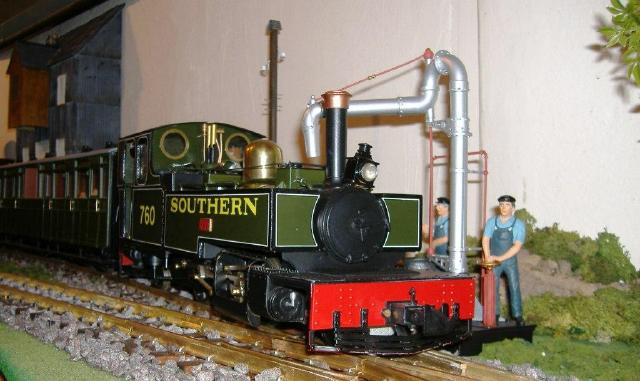

Modelling W&L @16 mm .......45 mm gauge is near as. OK, old one to pitch but....
Yes, that is 2 ft gauge (32 mm on bright new 45 mm) L&B in picture. Max.
