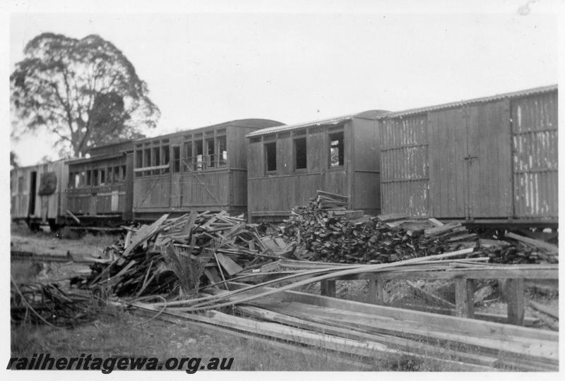

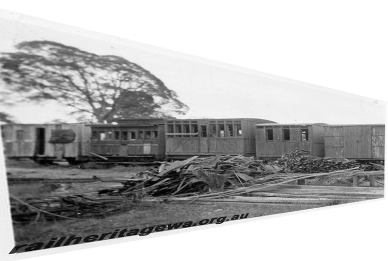

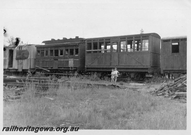

Australia is the spiritual home of corrugated iron engineering, but I've never seen it used for anything on rolling stock except the roof.
At Last, Annie! I've found you an Australian wriggly-tin-sided van - and not too different from your design for your Kotanga Tramway! Another item from the Millars timber empire, Western Australia.
And look along the RIP track: a four-wheeled carriage not too different from your Kotanga Tramway design.
David
Annie
Post by Annie » Sun Jan 31, 2016 1:50 am
Brilliant David. What an amazingly useful photograph! Thank you so much for finding this photo for me. There is just so much useful detail in this photograph I can use.
Ha! - the wriggly tin brake van shall go to the (tramway) ball afterall.
And as you say David that coach is so very close to what I'm building for the Kotanga Tramway. The diagonal iron bracing is an interesting detail too
Seeing that short three windowed coach made me smile though as I'm in process of building a coach for the mining company's tramway that's so close to that one it's not funny.

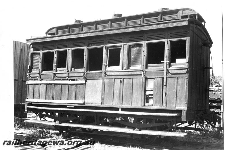

Annie:116001 wrote:that coach is so very close to what I'm building for the Kotanga Tramway.  The diagonal iron bracing is an interesting detail
The smaller coach to its left is interesting too as it has a Tropical double roof, the air gap and slight overhang all helping in the heat - a bit.

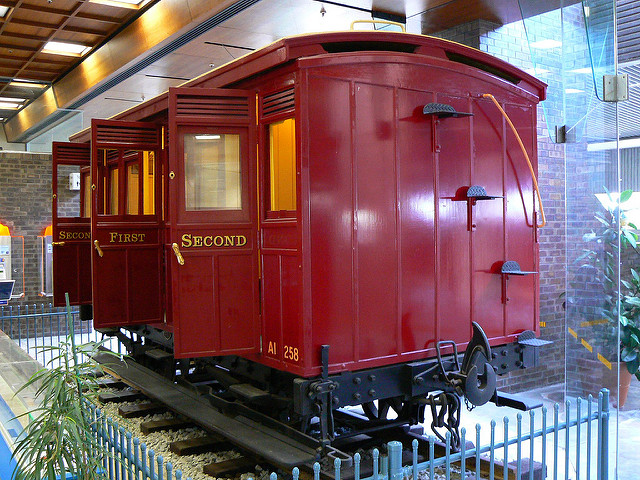

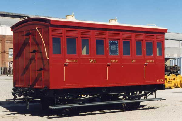

Meanwhile here's a restored WAGR coach like the derelict one with the funny roof. I don't know where it lives, but if it's Yarloop then it will have perished in this month's disastrous bushfire.
David
Annie
Post by Annie » Mon Feb 01, 2016 1:22 am
That's a lovely wee coach David. Now I'm trying to find an excuse to build one just like it :lol:

Just found the classification, measurements and more pictures of the little Tropical carriage.
WAGR Class AI (that's Alpha Indigo, not Alpha One) built by the Metropolitan Railway Carriage & Wagon Co, Birmingham England.
This particular 'cascaded' specimen used to be the Viceroy's car, hence the preposterous clear-storey, presumably to clear the plumes of his official hat.
      The rest of the class had plain roofs with lamp pots as per the restoration photo above and workshop photo below.
I'm gobsmacked at how absolutely TINY it is!
Length 16' (4 900)      Width 7' 6" (2 300)     Height excluding clear-story 10' 6" (3 200).
This new-to-me close-up shows a lot of characterful detail that my old eyes don't pick up from a view in gloss paint:

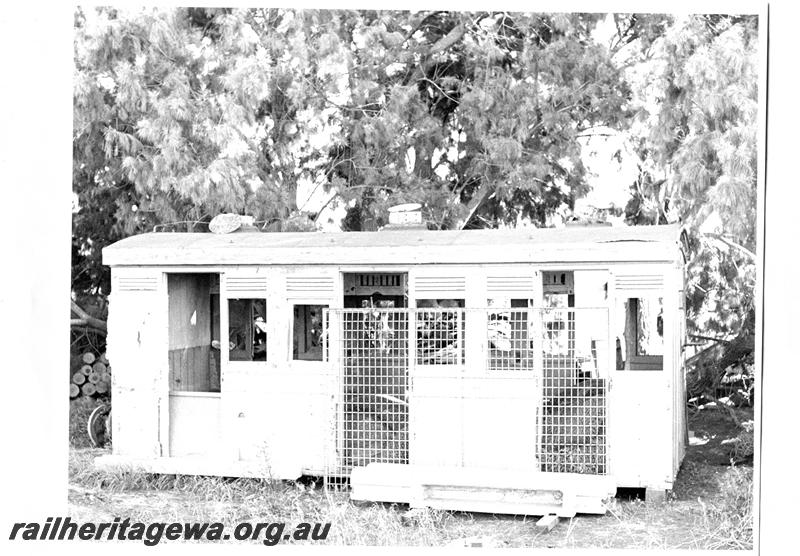

and here's another wreck in use as a caravan - presumably the one that's been restored:

   and here's a workshop view at the late lamented Yarloop workshop showing Viceroy's car with clear-storey back left, standard car back right, standard wagon underframe under construction foreground:

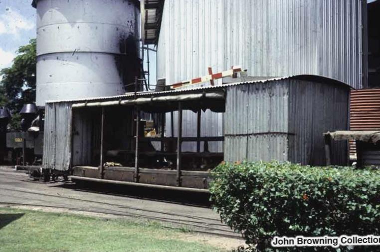

Post by Annie » Thu Feb 25, 2016 8:00 am

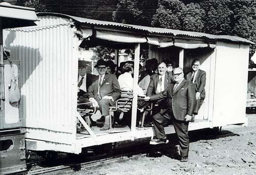

Photographed at Moreton Mill circa 1985.
Not been around much because I'm having a go at On16.5 at the moment.
tuppenced
Post by tuppenced » Thu Feb 25, 2016 9:40 am
Brilliant coach - thanks for that!
In 7/8" scale it'd be HUGE, but hey, it's an entire passenger train in one.
David 1/2d

Yes I thought you'd like that coach David. I'm going to have a go at one in 16mm just because everybody told me that no coaches were ever made from wiggly tin.

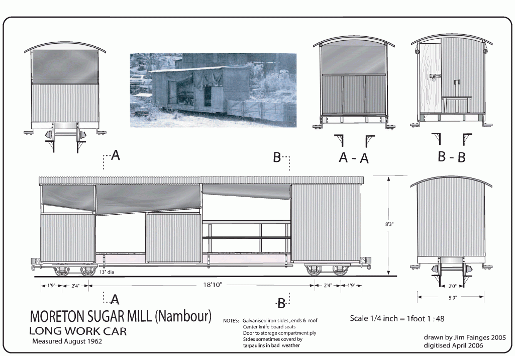

tuppenced:116448 wrote:In 7/8" scale it'd be HUGE, but hey, it's an entire passenger train in one.
Wouldn't be that big, as it's a 2' gauge cane tram vehicle, in 7/8 scale model form it works out about the size of a 16mm scale W&L pass carriage.
It's not technically a passenger carriage, as Moreton Mill didn't run a passenger service. It is their 'long' work car (as opposed to the 'short' work car) used on the navvy train for carrying the track gang and their tools. You will find a drawing of the work cars, including the matching tin shed on wheels used as a tool van, in the late Jim Fainges drawing collection.
The neighbouring Mapleton Tramway had a combination guard/passenger/cream van of similar appearance, but more conventional construction,that was used in public traffic.
tuppenced
Post by tuppenced » Thu Feb 25, 2016 4:09 pm
You're right, Graeme, it's the 27' Long Work Car - still a hefty couple of feet long in 7/8" scale:
I'd muddled it with this Behemoth:
which looks a fair bit longer to me. Could be an Optical Illusion:
Here's the Short Work Car you mention:

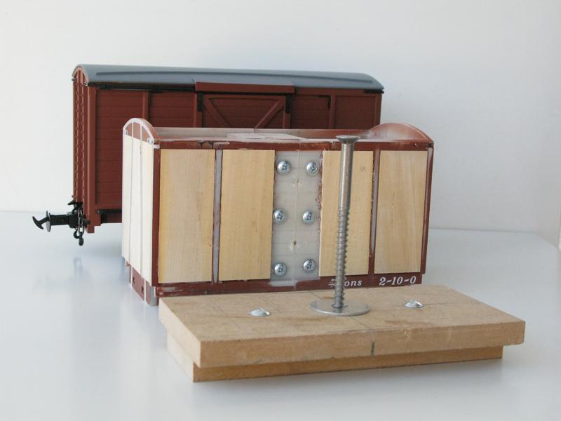

Post by tuppenced » Sat Mar 25, 2017 6:36 pm
tuppenced:116662 wrote:
tuppenced:115999 wrote:Annie, I've now found a crisper photo of said wagon: Image
and have made some slow progress with my Western Australia rake.
Here's the inner body (without corrugated), shortened from an Accucraft W&L van:

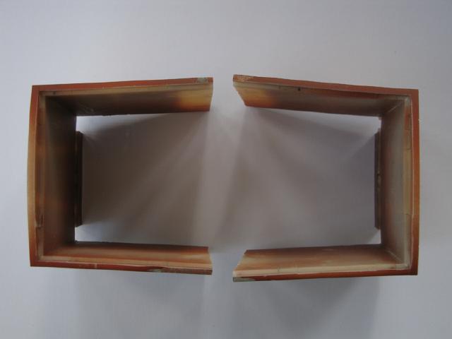

You might ask why the 'sep' headed screws, and so many of them.

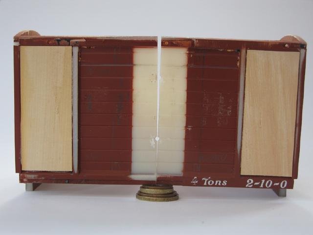

It's because when I bandsawed a chunk out of the middle:
everything looked OK for a while, until the poured urethane Relaxed, like this:
and it proved disturbingly difficult to get the two halves matching, let alone lined up, let alone fixed together solidly:

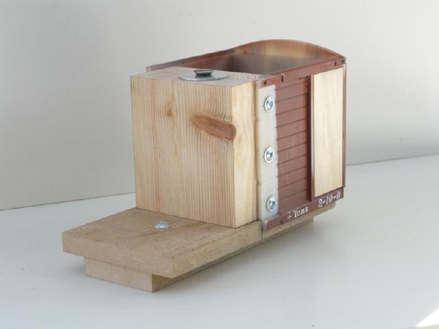

So I made up a jig (below, and foreground of first picture).
I held it in a vice, and it lined everything up for final trimming, drilling and screwing to a central block of wood that stays part of the van.
The new doors will cover the screws, and the underframe will be shrunk to fit.
By the way, the wooden panel infill (bits of wooden Venetian blind slat) is to prevent over-zealous fingers from crushing the corrugated sheathing. Hopefully . . .
