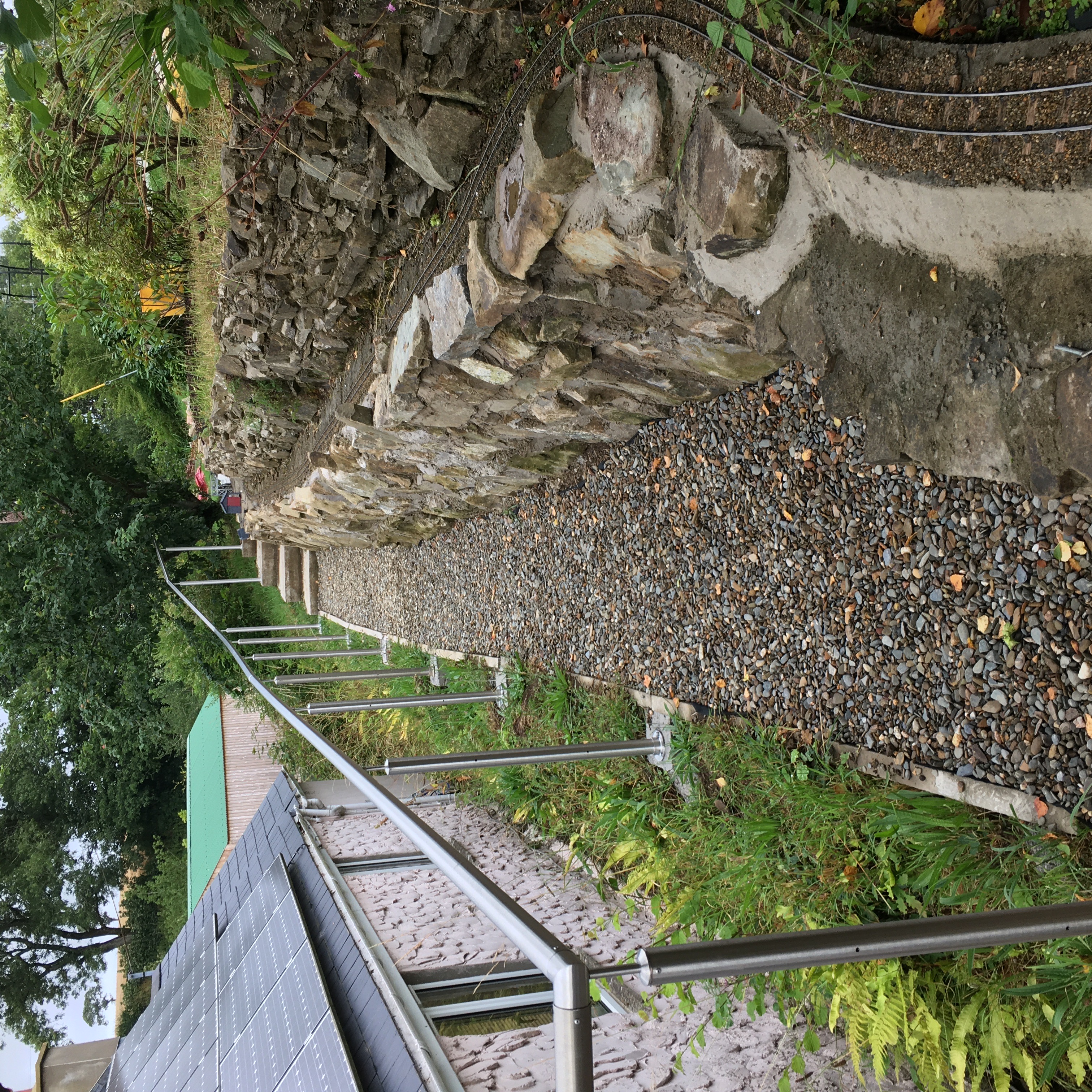

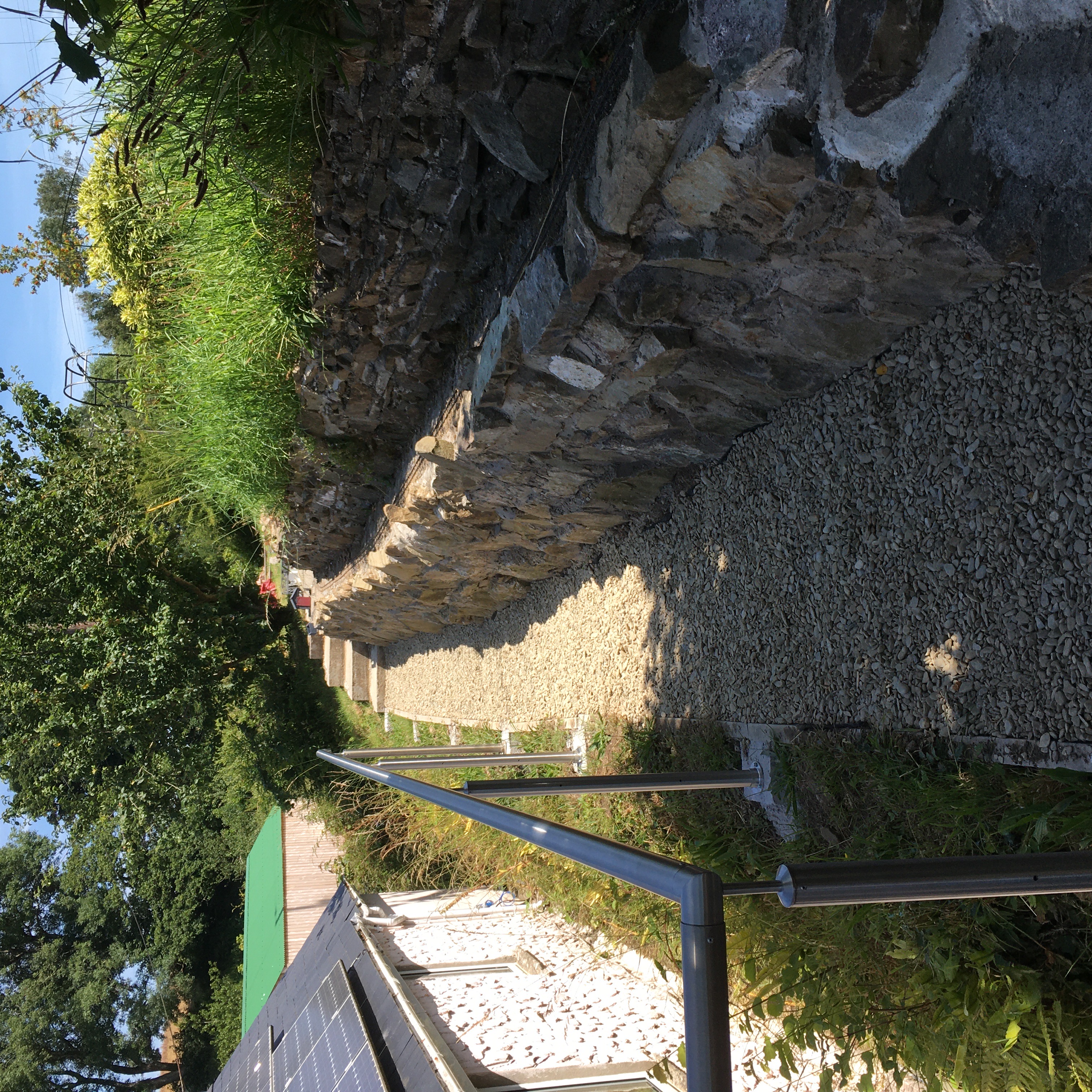

Things are still moving forward on the railway in the valley of the mill - even though it is a bit hot out there at the moment.
Firstly the path which follows the first extension behind the cottage is now almost finished. The membrane and gravel are in place, and half of the handrail is installed:

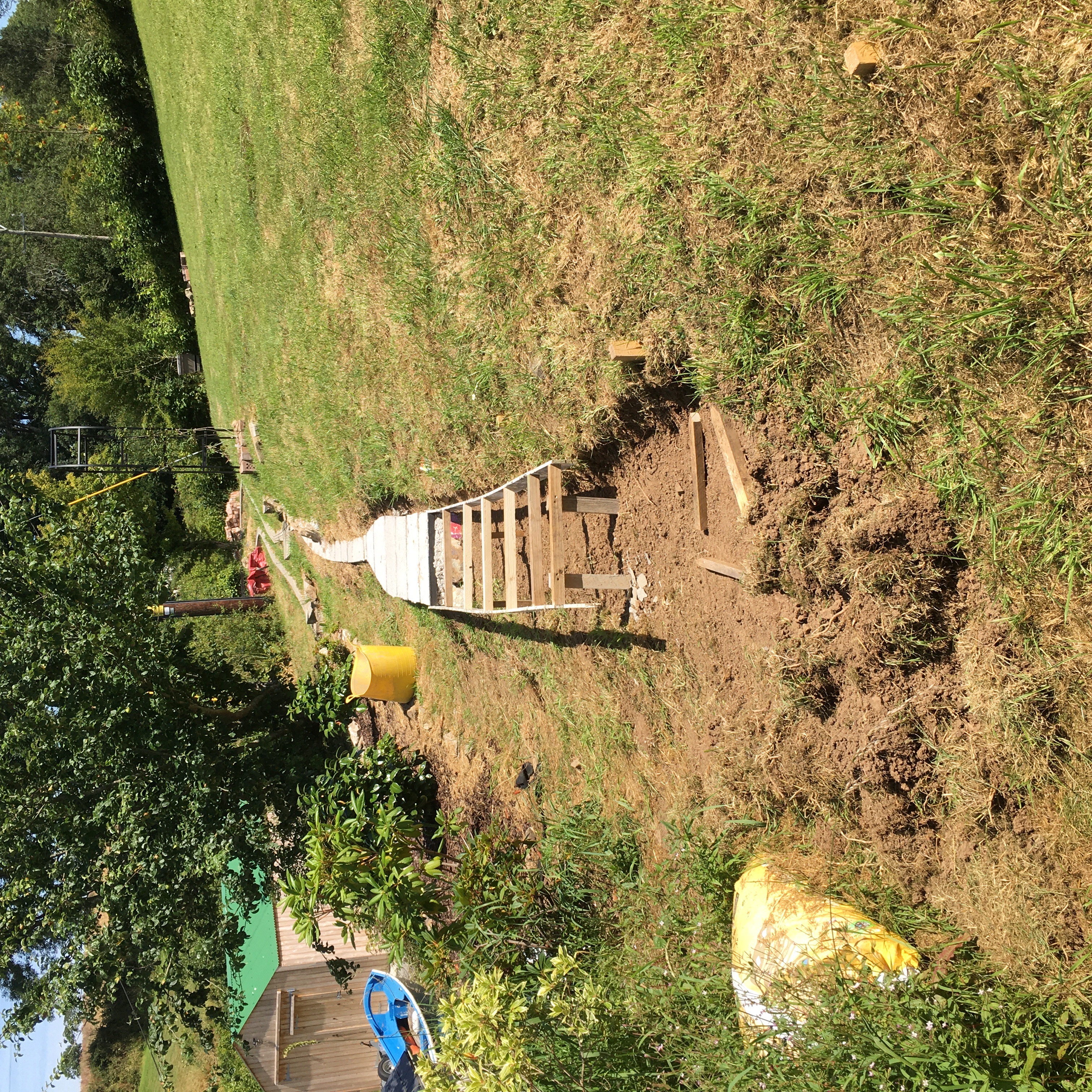

and the latest extension is well underway. I have now started to install the wider trackbed where the next passing place / station will fit:
I will go out there again later when it has cooled down to lay stonework under the plastic shuttering. Partly to act as shuttering and partly to reduce the quantity of concrete I have to wheelbarrow up a hill. It looks a bit odd at the moment but an explanation follows:

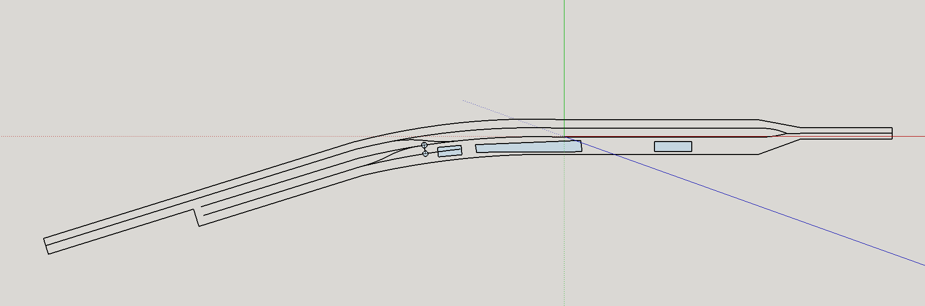

Screenshot 2022-07-16 at 14.37.20.png (35.74 KiB) Viewed 6560 times
This is roughly what I am attempting to create. The track comes in from the right, widens into a passing loop, and finishes with two parallel sidings. The inspiration for the layout is the Victorian arrangement at Tan-y-Grisiau on the Ffestiniog railway. That explains the tapered blue block which represents the station building which was a weird tapered shape. The two blue circles are wagon turntables with track disappearing into a goods shed. Lower down the loop is another rectangular block which represents a row of cottages.

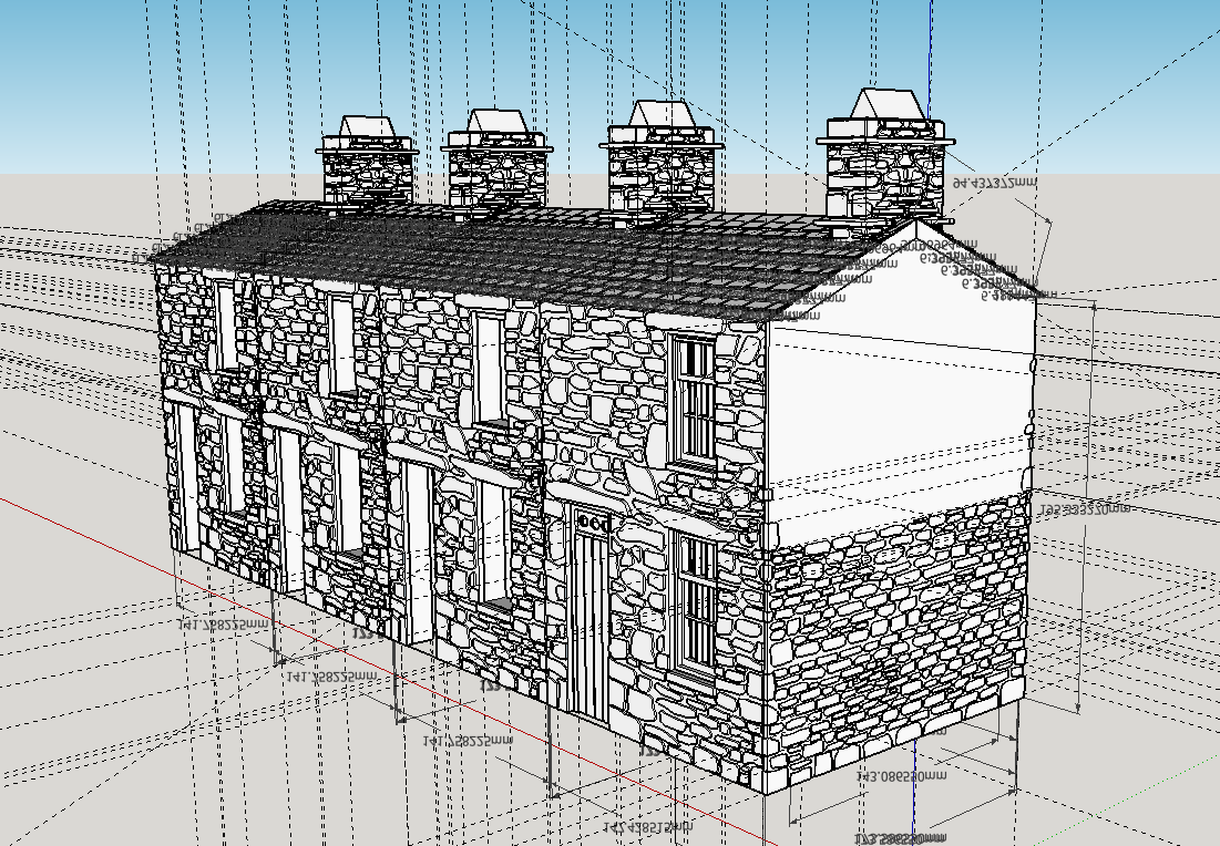

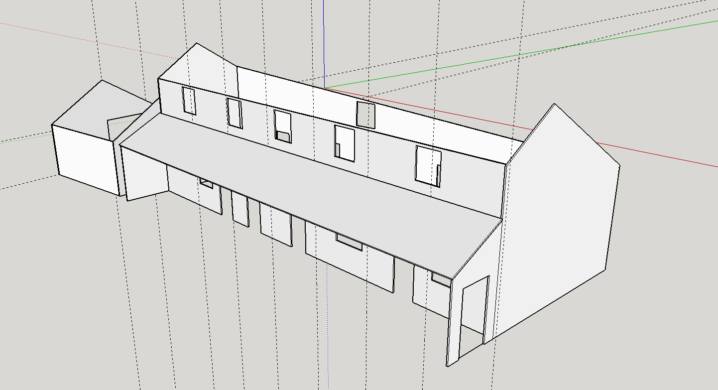

I have of course outline plans for the buildings which will be something like this:
Screenshot 2022-07-16 at 14.21.33.png (255.52 KiB) Viewed 6560 times
A row of four cottages based on the row of quarry workers cottages at the Welsh Slate Museum. I will add that to the 3 D printing section.

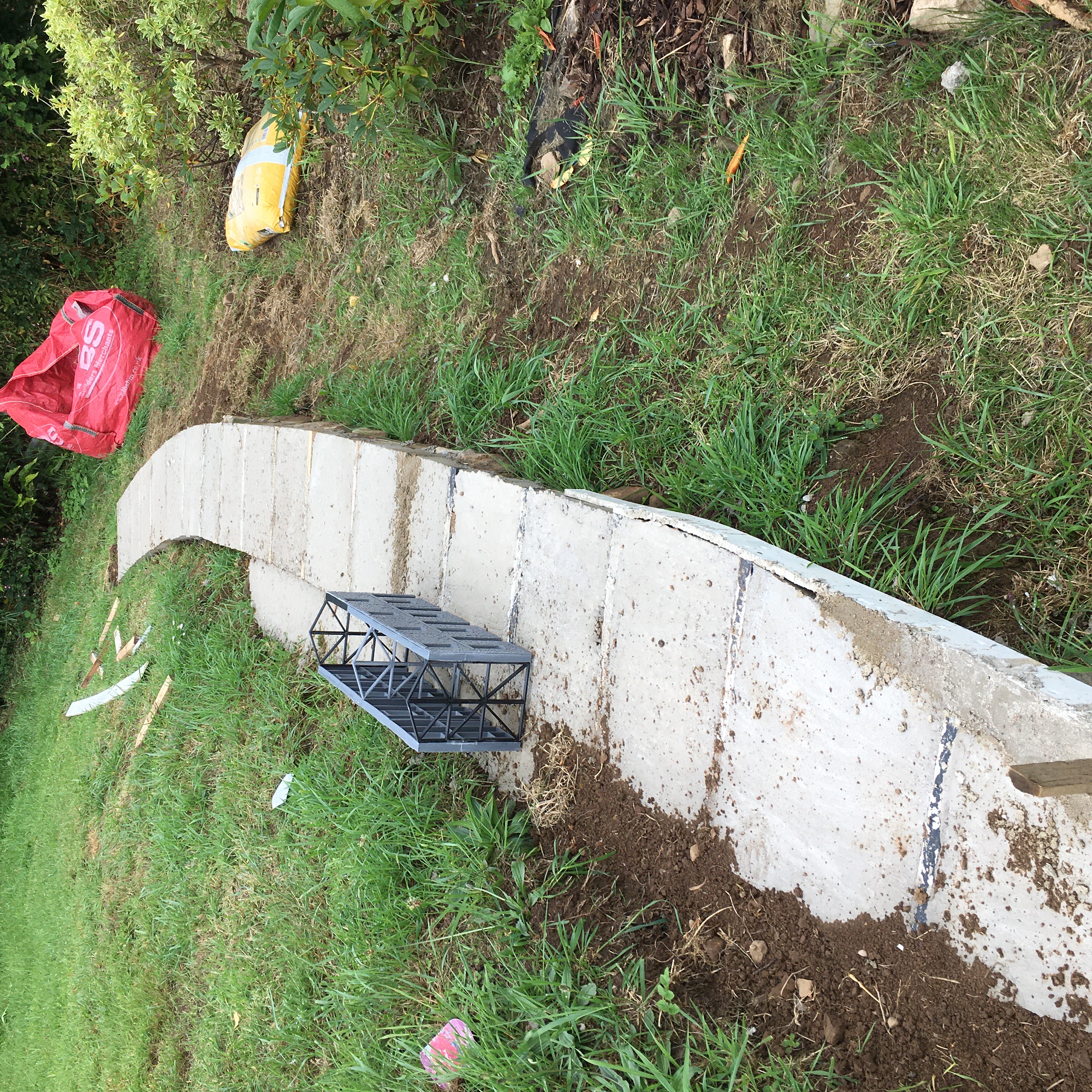

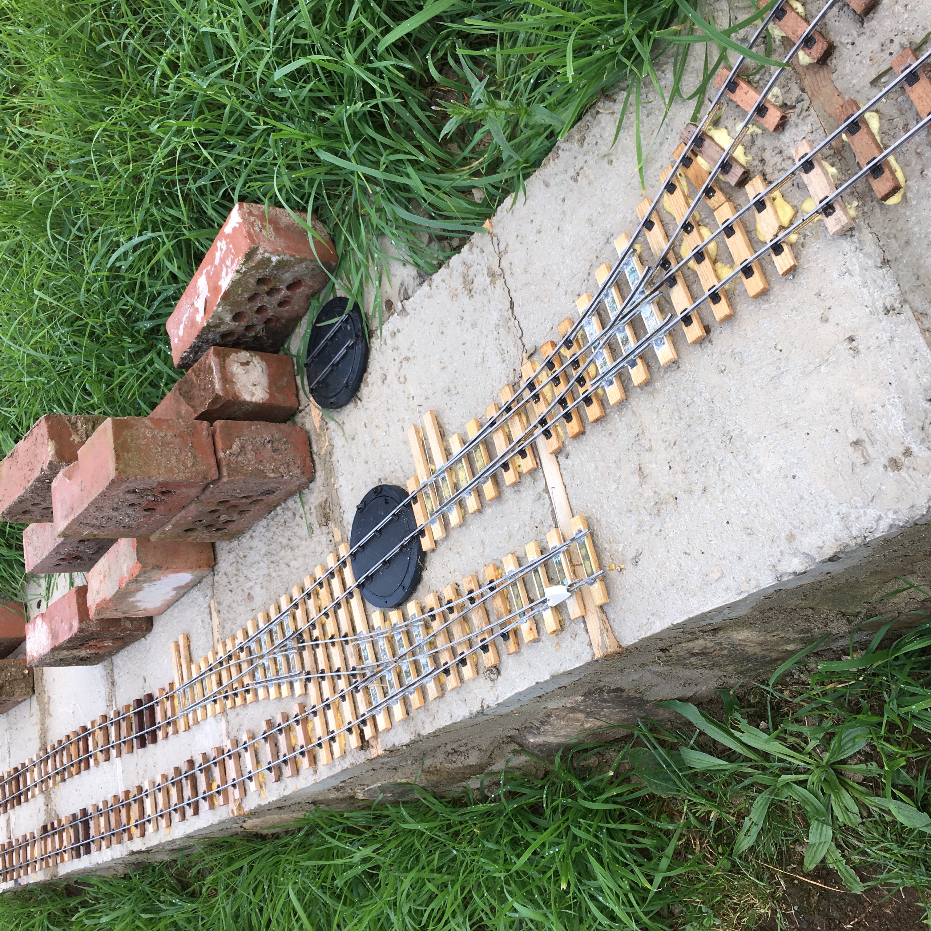

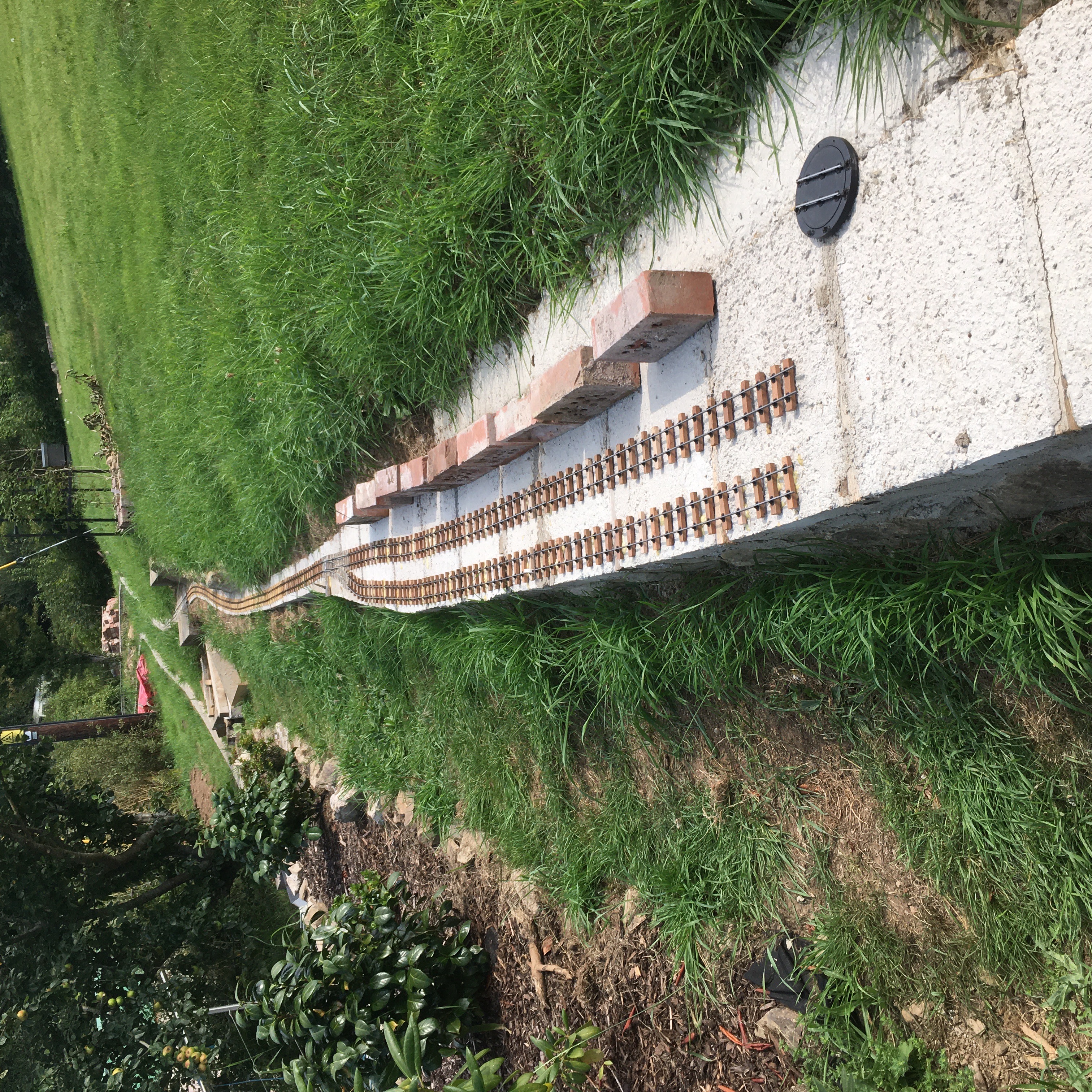

The track has reached the passing place at Tan-y-grisiau station:

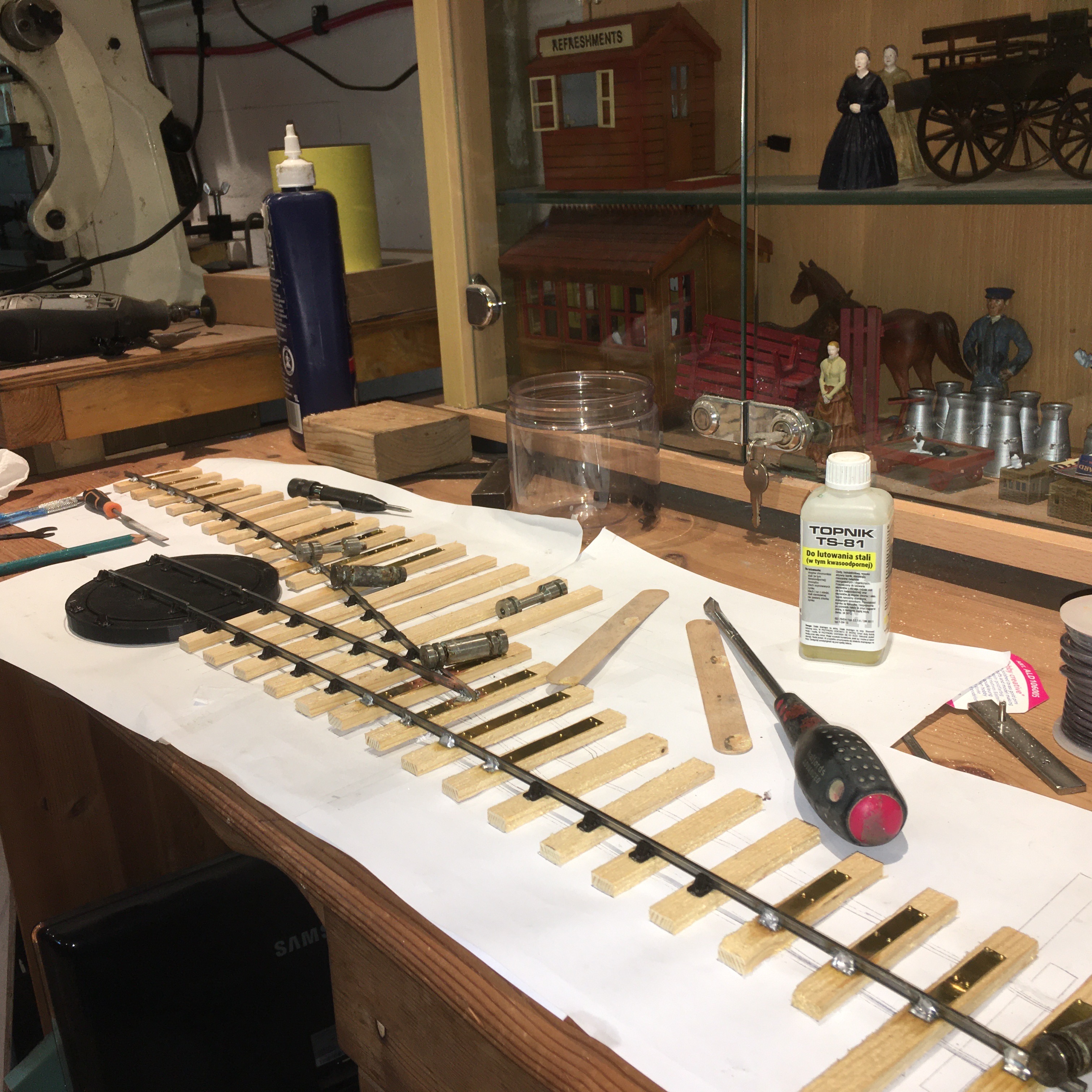

and I am now building a pair of points which will close the far end of the loop, and give access to the sidings:
They incorporate the wagon turntable. The turntable gives access to the goods shed, and beyond the turntable will be a left hand point and two sidings.

Posted: Mon Sep 05, 2022 8:42 pm
by Trevor Thompson

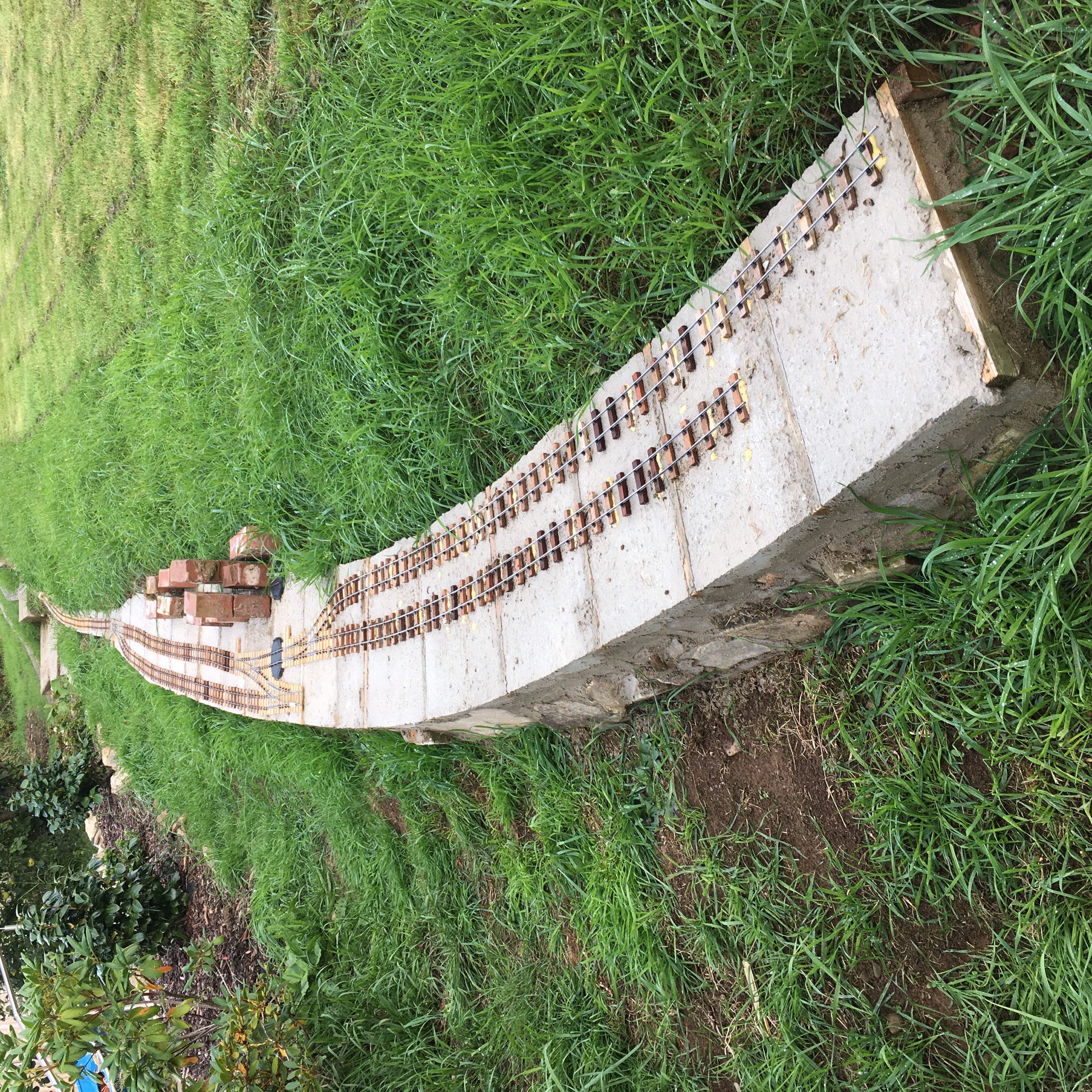

The track is almost finished. All of the point work is fixed in place and the sidings fitted. It is just the main line which will act as a head shunt for now which is left to lay:

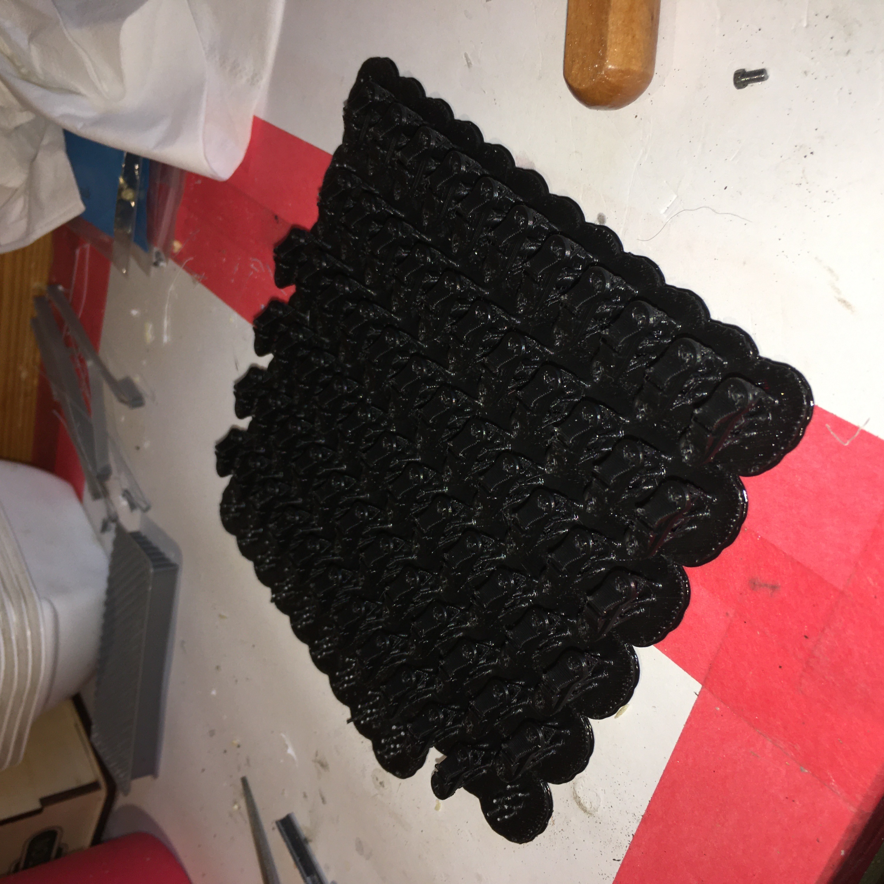

I have run out of chairs (which I buy from Cliff Barker) and as an experiment I have designed a chair to be printed the filament printer in ABS:
At the moment they seem to be very strong - and they don't seem to want to split along the filament grain. They even cope with being pushed into fairly tight holes being twisted in the hole and being pulled back out. So this is 80 of them. They are based on the type of chairs used on the Ffestiniog prior to something like 1870. While the ones I have been buying are intended for G scale they are very like the ones used on the Ffestiniog in the later Victorian period - and that is a fluke that I am happy with! So If these fail over a time it's back to buying them!
I am hoping for the weather to allow me to ballast the track in the next few days.

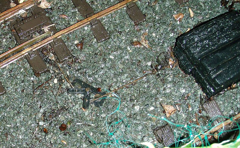

I am also thinking about cranks, rodding, and a ground frame to operate those points. Perhaps cranks and guides for the rodding could be printed? Dare I even print the ground frame?
I printed cranks and bases in PLA ( using brass screws as pivots) and they have been fine outside for 3 years so far.
In this picture the operating servo is hidden under a printed hollow pile of sleepers, also in PLA.
