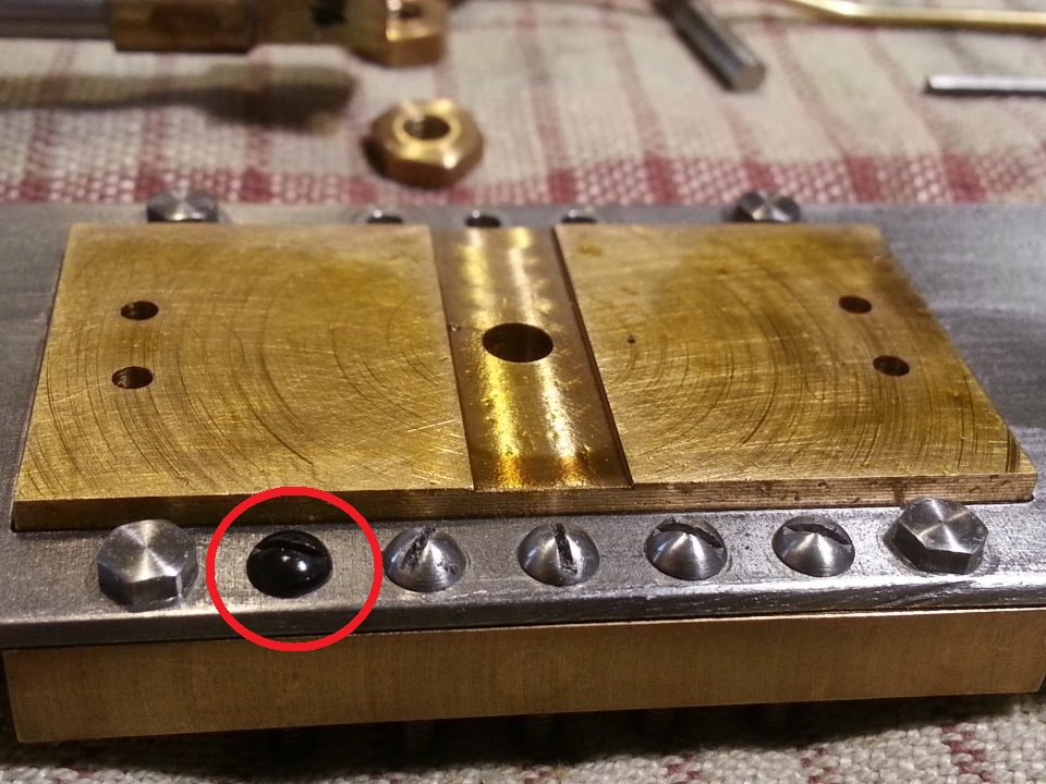

I have been reducing the head height of roundhead screws to fill all the holes that I overeagerly drilled for the cylinder port blocks. Standard height is too close to the face of the port block. The frames are going to be black so I tried oil blackening the head of one to try it out. It looks good. I'd rather not spray over the screws.

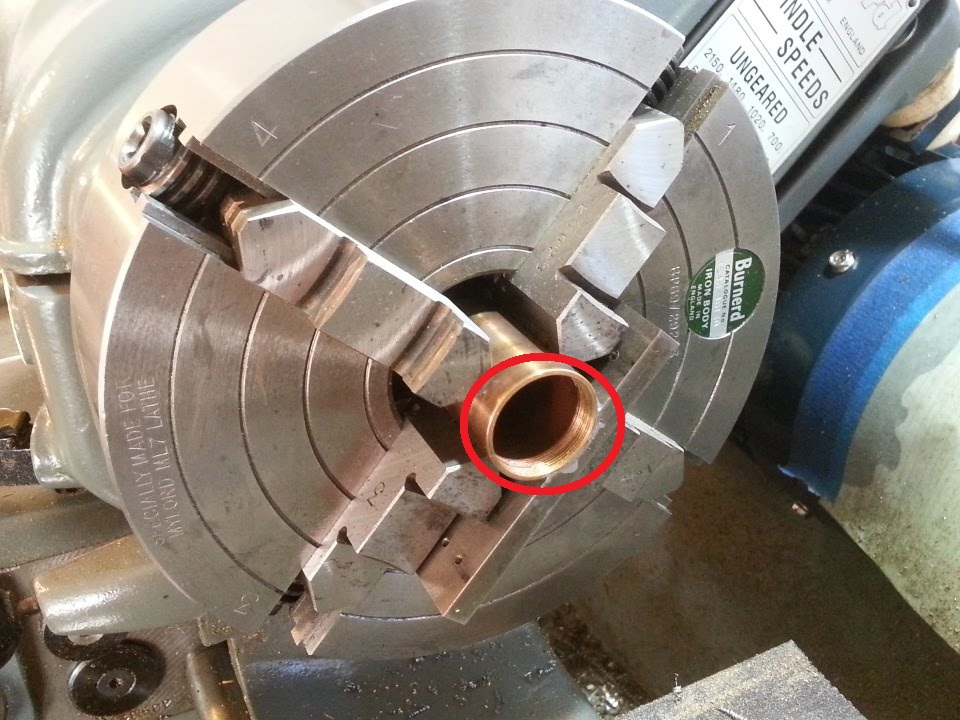

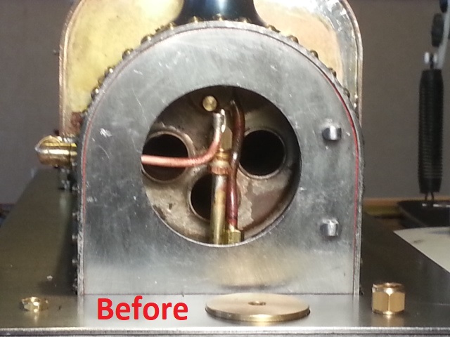

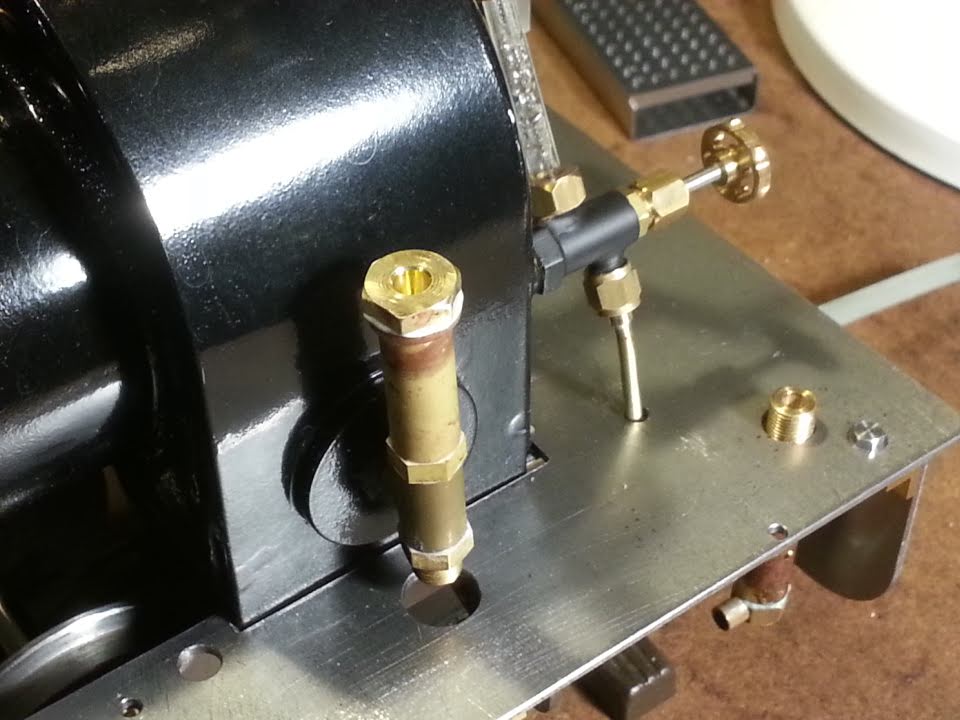

Progress is being made. The whistle connecting pipe is done. The whistle is installed. The gas burner mounting is arranged. The sight glass drain pipe is fitted.

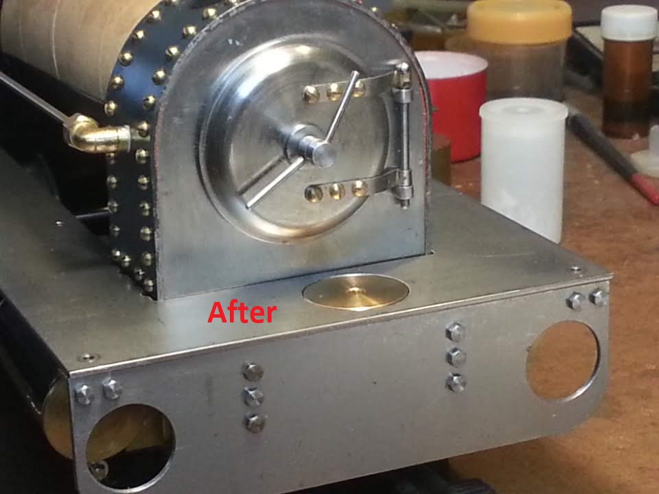

I wanted to lower the lubricator lid as it sat too high, I think I forgot about the thickness of the o-ring. It's soldered to the buffer beam spacer, so I decided to skim a bit off the top in the lathe.

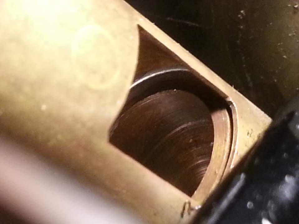

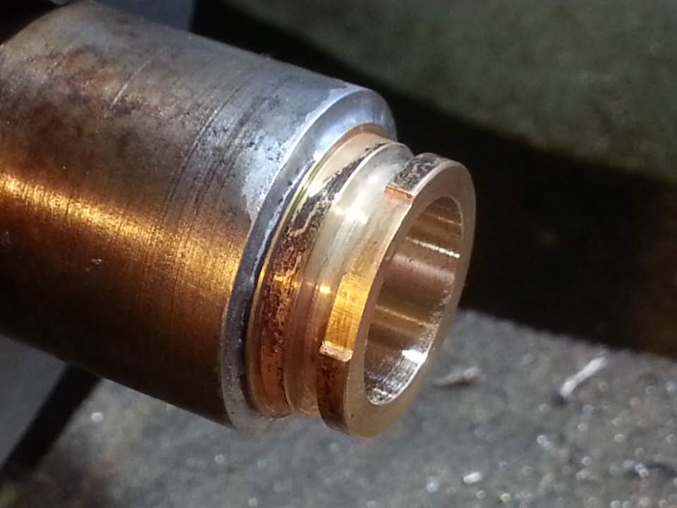

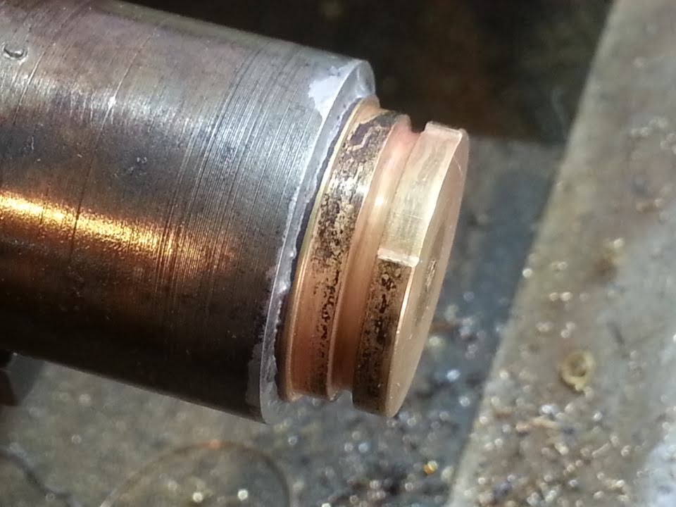

Yesterday I had a look at the good whistle, this is what I found; a well-relieved gap plug and a lovely solder filet I disassembled the whistle and made some modifications; enlarged the steam gap and relieved the excess material.
Before After Before soldering the gap plug back in I noticed that there were uneven gaps on the front end, I expect that it wasn't properly sealed and leaking
Soldered the whistle gap plug back in, when tested with my finger over the other end the whistle is much improved.

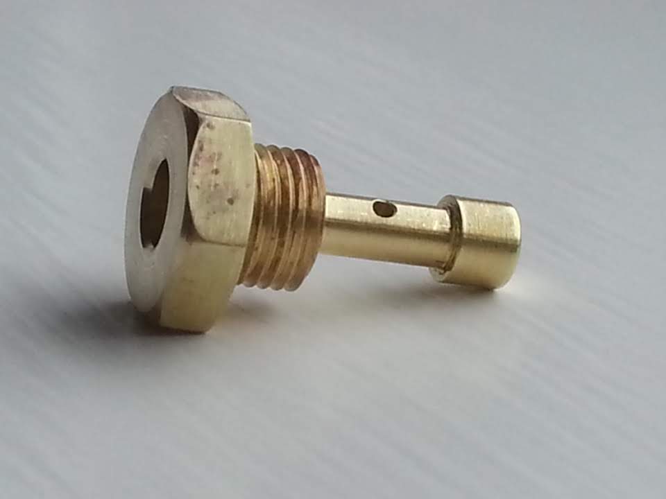

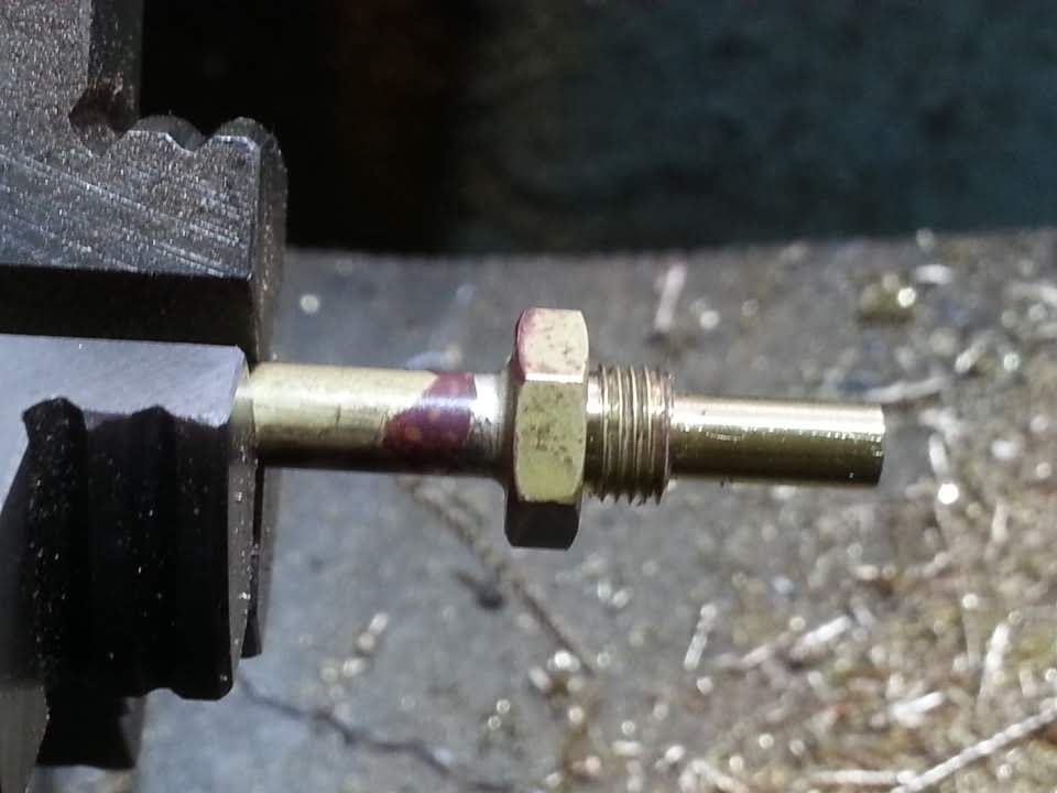

The next step was to make a Goodall valve, I had been borrowing one from the large De Winton. I took down the dimensions. I'm not using an o-ring.
I reused a boiler pressure test blanking off plug, drilled it through for 3/16" K&S brass rod and silver brazed it in.
Finished valve
Fitted
Finished valve
Fitted
