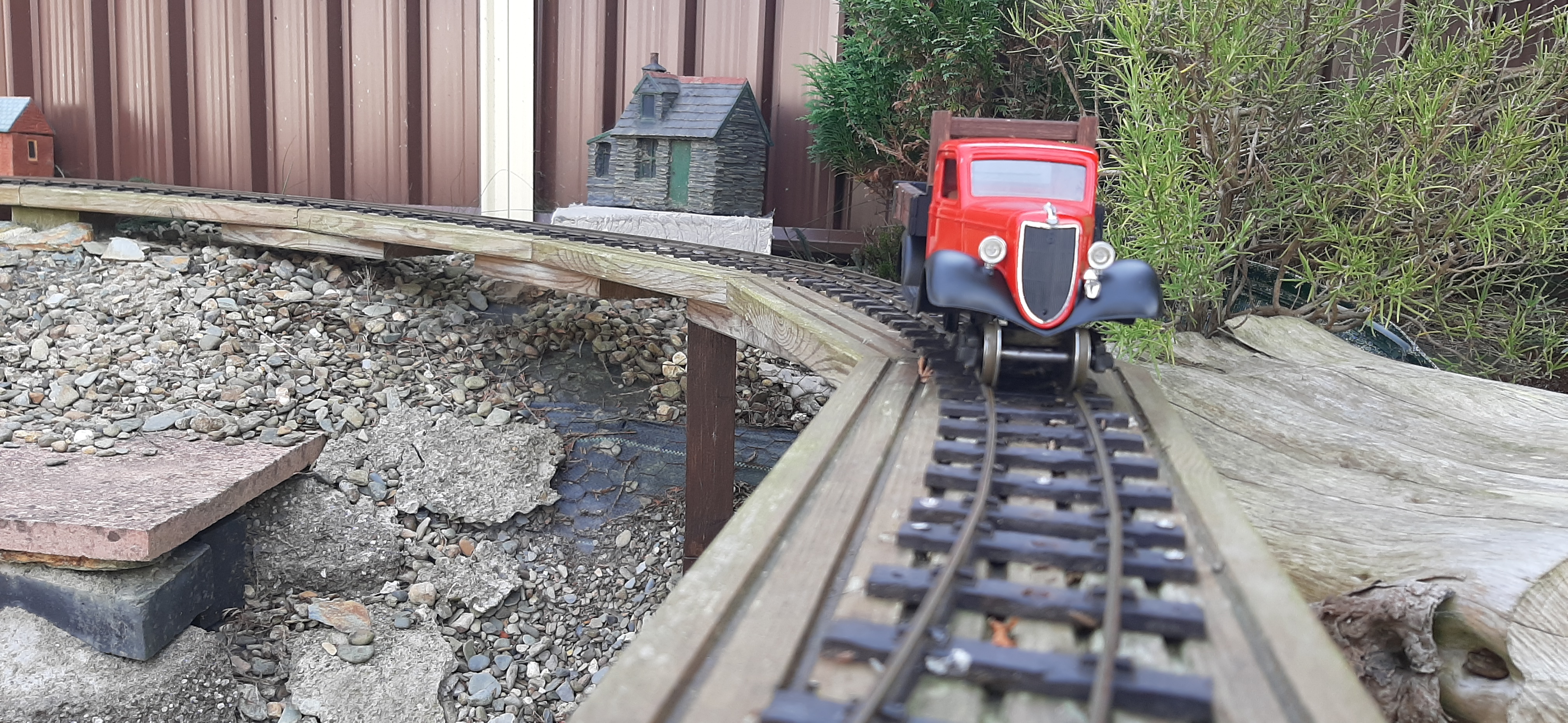

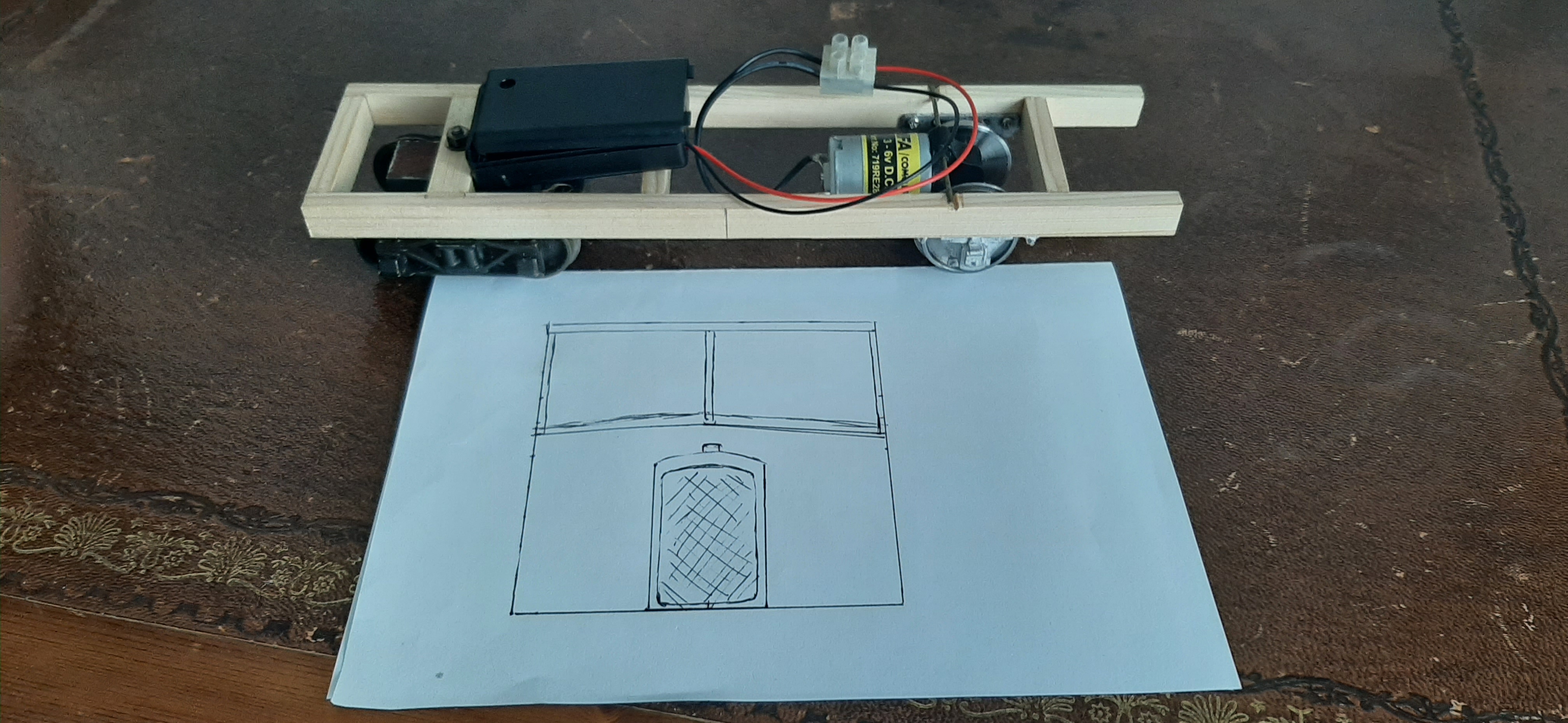

The Pickup rounding the curve . It runs quite well on 3 AAA batteries. The wiring is very basic at the moment, but before spending more on it ,I would like to find a better motor gearbox assembly. As I had to glue the top hat bearings in place . If only there was a fold up brass etch like what is used in 7mm scale models. The next project is under way.

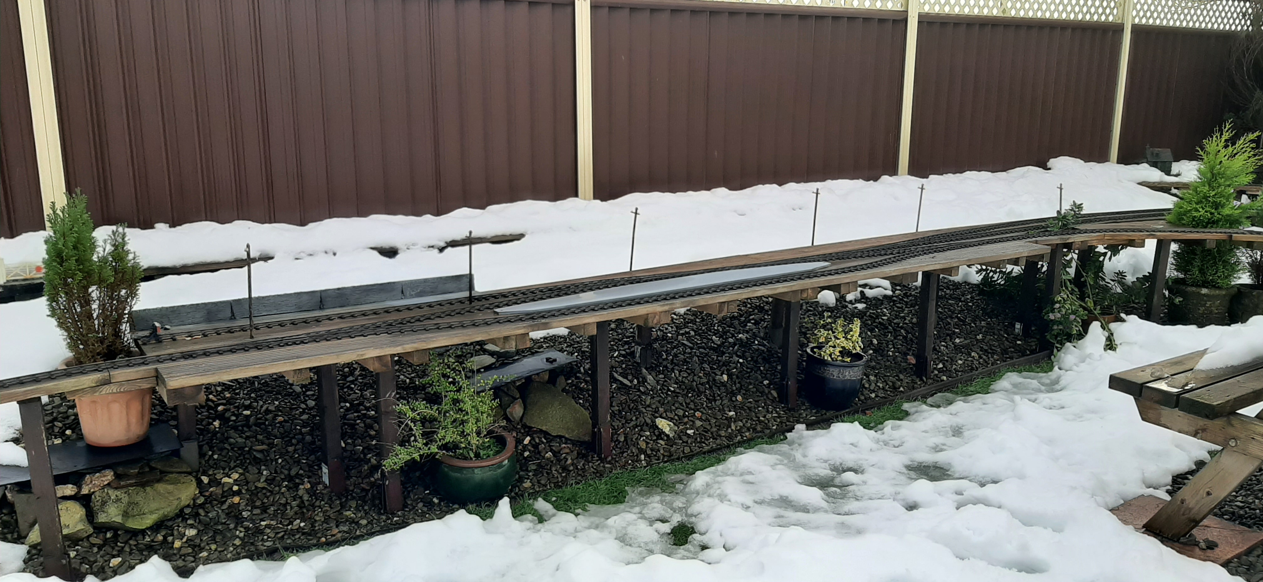

No Trains today ! Had about nine inches of the white stuff by looking at the tops of the telegraph poles.

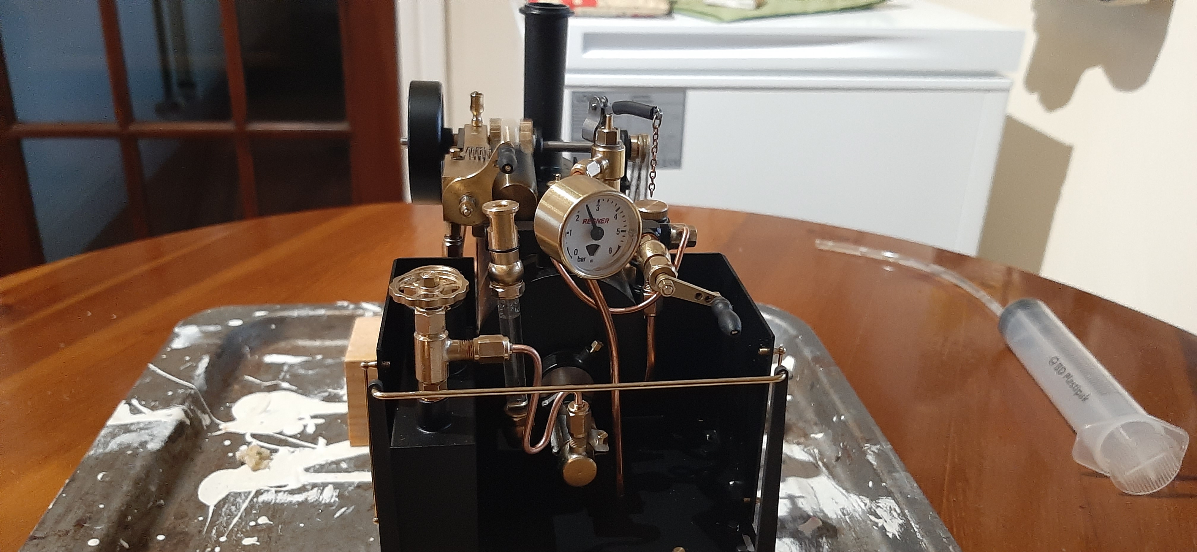

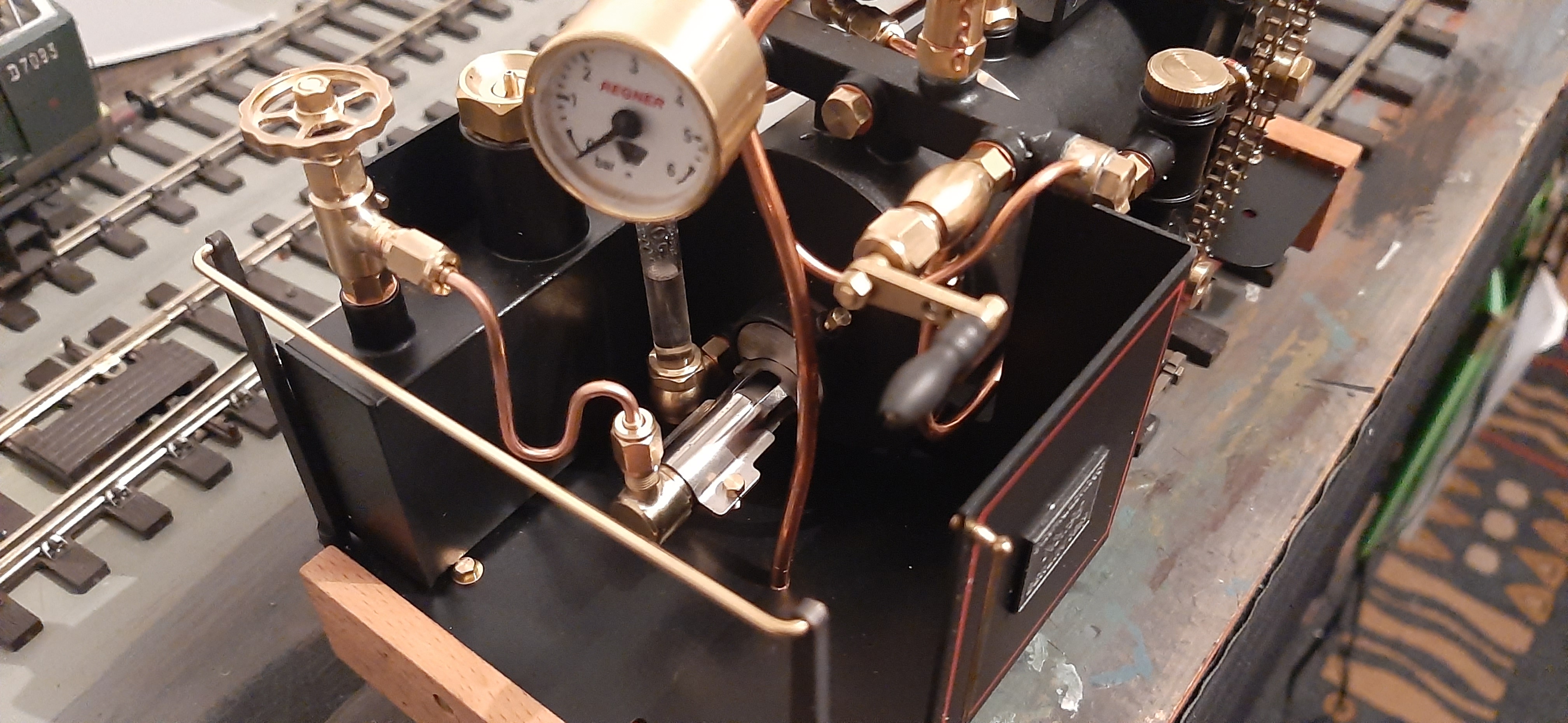

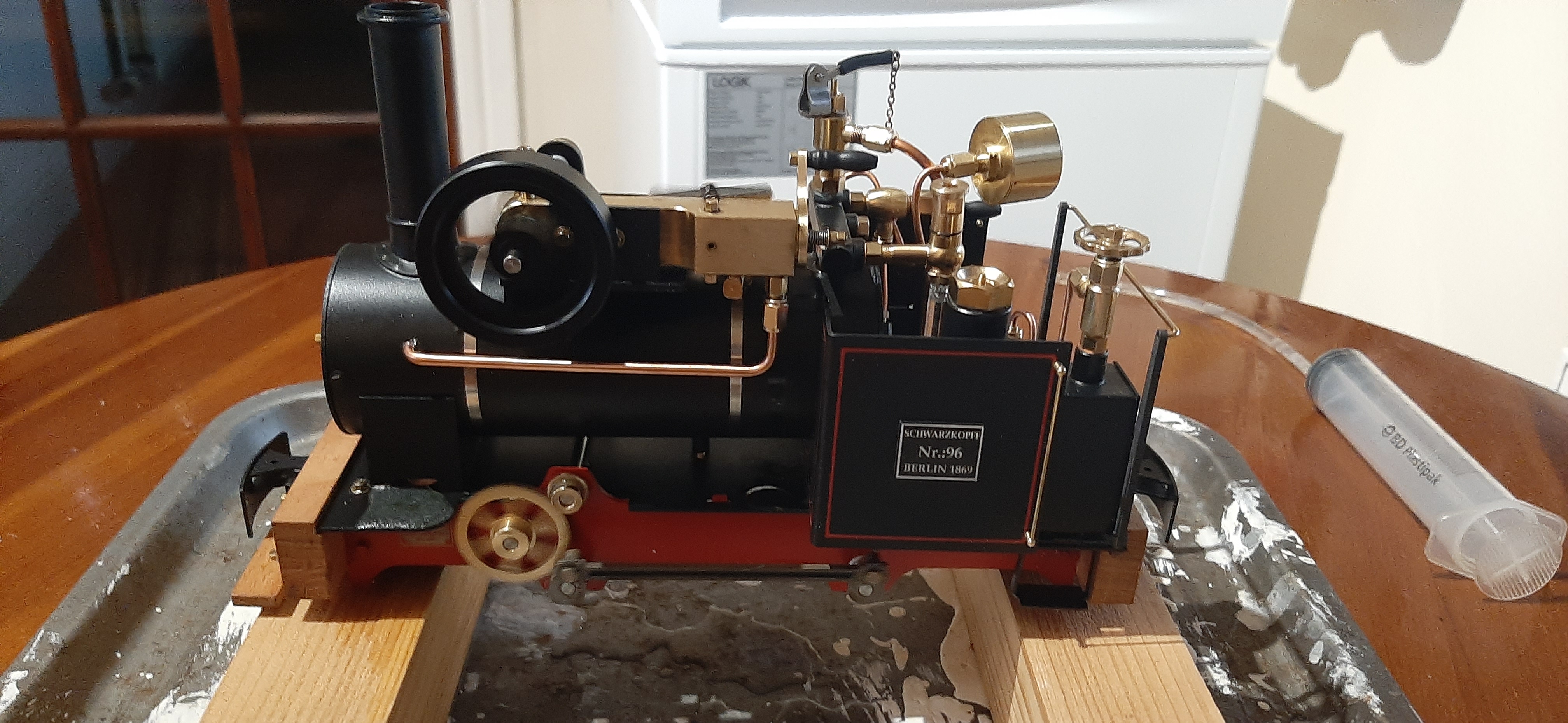

Vincent has joined the PMR loco roster. It arrived A couple of days ago but I could not run / test fire Vincent until I had a delivery of the correct grade steam oil. Regner locos require a thicker viscosity oil 460 grade where as my Roundhouse engines run on a lighter 220 grade. This model is one of Regners latest batches build date August 25. It has the newer gas burner and a 6mm wide water level sight glass also a water top up valve . I also opted for the Whistle .
On carefully prepping the loco I was pleasantly surprised when the burner ignited on the first attempt . I am looking forward to running Vincent on my railway once the heavy rains have past.

My only criticism of Vincent is that the safety valve is a little fiddly to remove and I need to adapt one of my filling syringes inorder to fill and extract water.

Fantastic Chris. Good choice on the whistle - absolutely essential of course. I've fitted that and the top up to mine. I've also got one of the new burners but haven't tried it yet, it's really good to hear yours lit first time. Anyway, congrats on the new acquisition. Regner steam rally next time we meet!
