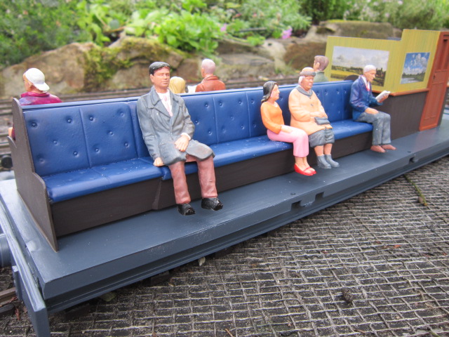

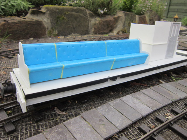

I can see you get most satisfaction from DIY but there is a helping hand available should you choose it. I fitted out my Observation Car with padded sets which I bought from IP Engineering. They are cast resin in blocks of four seats and easily modified to suit your requirements....
Saves a lot of work.
