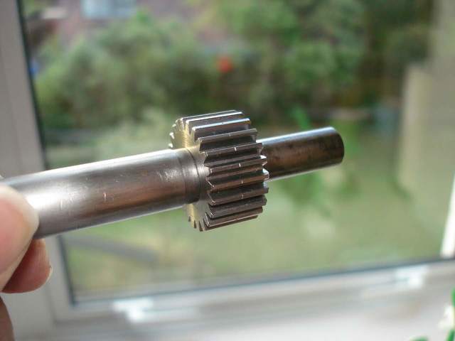

Here from the archives is one of the few gear cutting pictures that I took. These gears are the thin gears on each side that transfer the drive from the forward/reverse shaft to the 1-2-3 gears shaft. Milling both 1/4" wide gears at the same time on the mandrel. These were the last gears to be cut. Previously up to four 3/8" wide gears were milled at the same time to reduce the amount of indexingdewintondave wrote: Tue Apr 03, 2018 11:12 am Thank you Rod!
I've just re-read the whole build again, it was so much fun. Wish I had posted some photos of the gear making, they took so long to make but were so satisfying
Deburred on the outer faces, still Loctited to the mandrel .
Both idler gears finished with ballbearings fitted

That looks pretty high calibre work Dave, I can definitely see why the end result was so satisfying. Did you make the cutter?

Yes, it was a homemade cutter Grant. There's a link to it in the earlier pages that detail how to make them. I discovered it on a website
