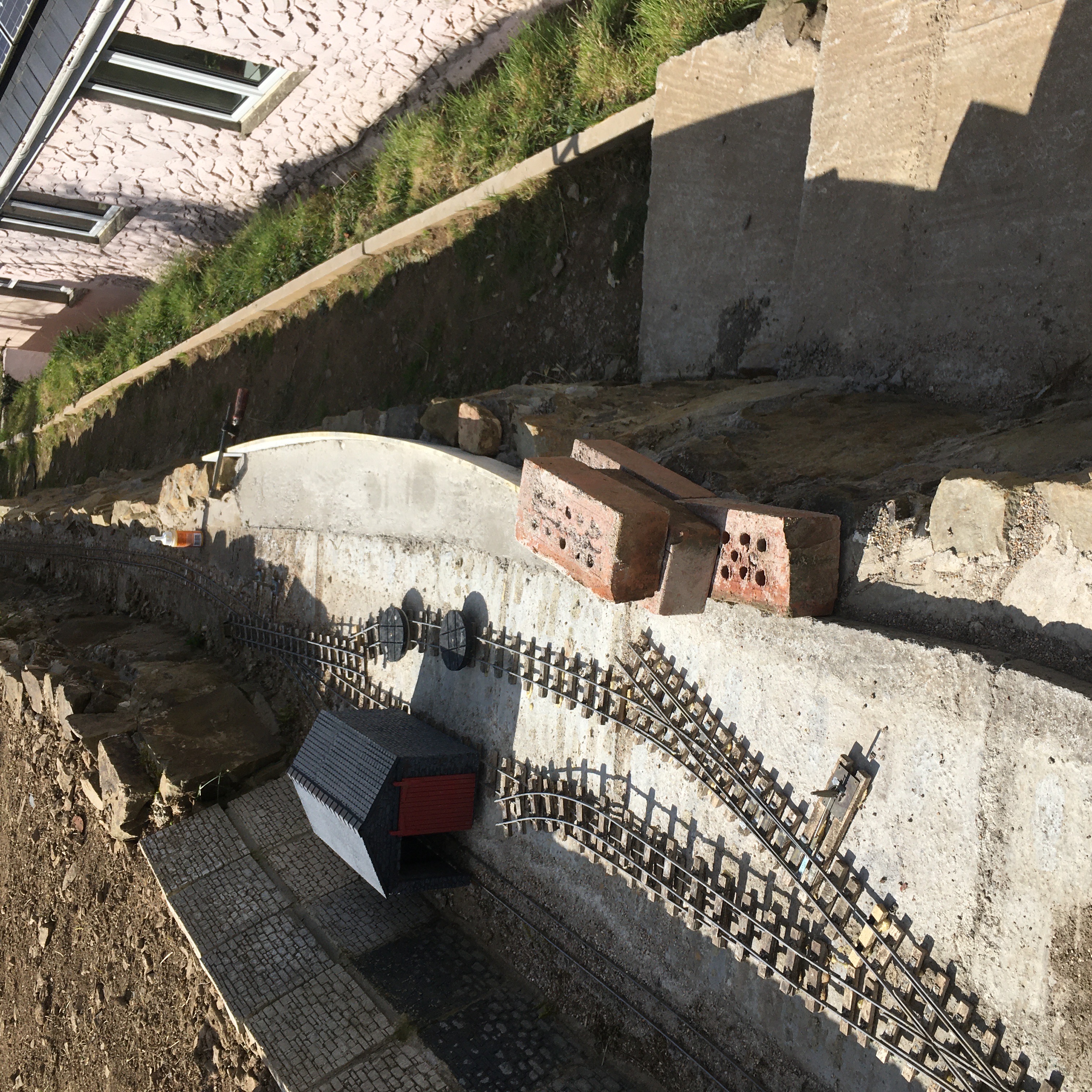

I have had a goods shed and a pile of fencing for TanyBwlch station sitting in the workshop all winter. That complex track layout hadn't quite quite met my expectations - fitting the goods shed means modifying the track to make room for it. So yesterday I lifted most of it. The far road - the "down" line - was fine - it was the convoluted curves to fit the crossover in, and the limited room between the tracks, that was the issue.
I have relaid most of it, and straightened out the "up" line in the station. The goods line now has room for the goods shed:
The curves in the bottom end of the goods loop are a bit tight - but it really only needs to be able to accommodate 4 wheel wagons, and no locomotive need pass around these curves. So they will suffice. I suppose it's one of the disadvantages of trying to create a model of something with only a third of the real length.

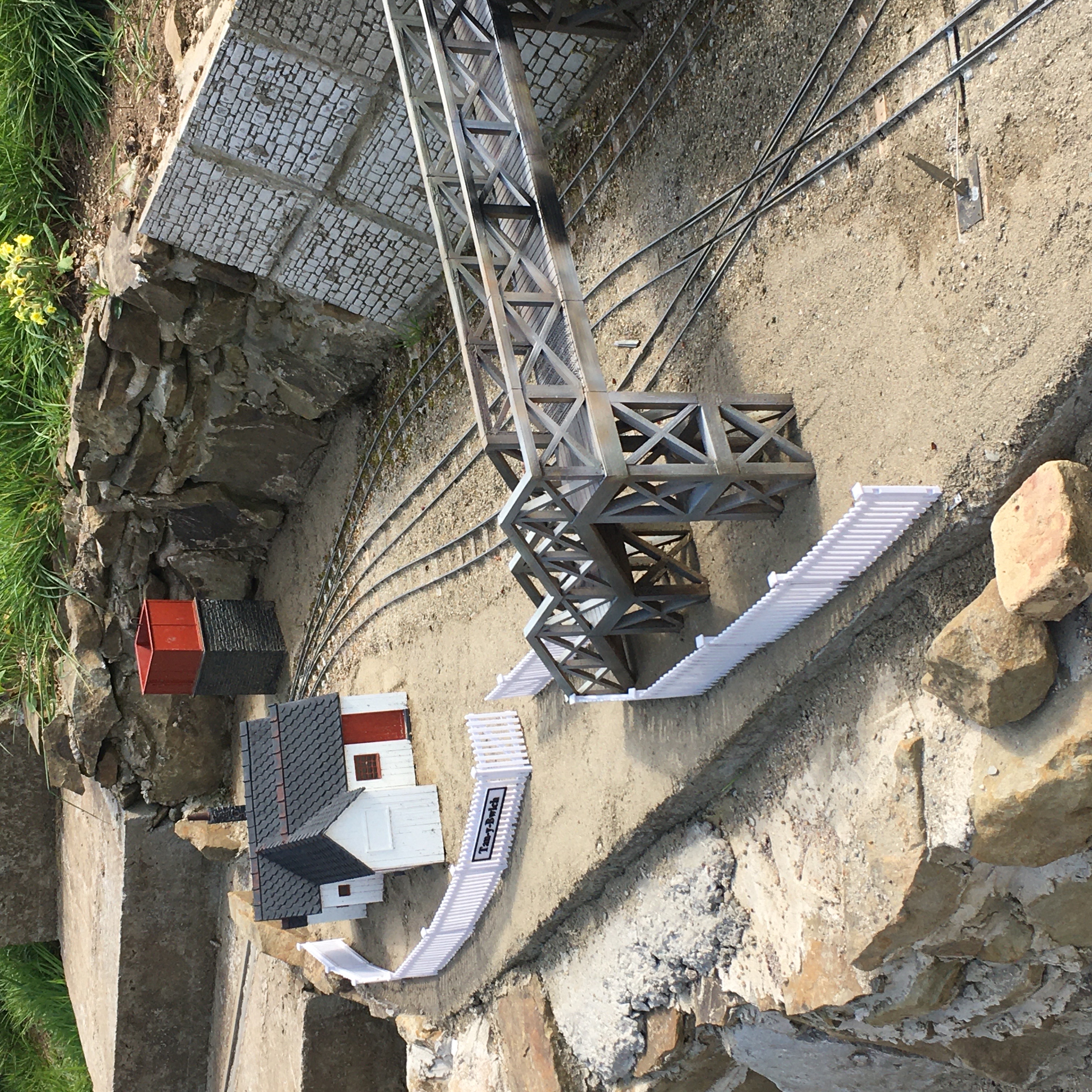

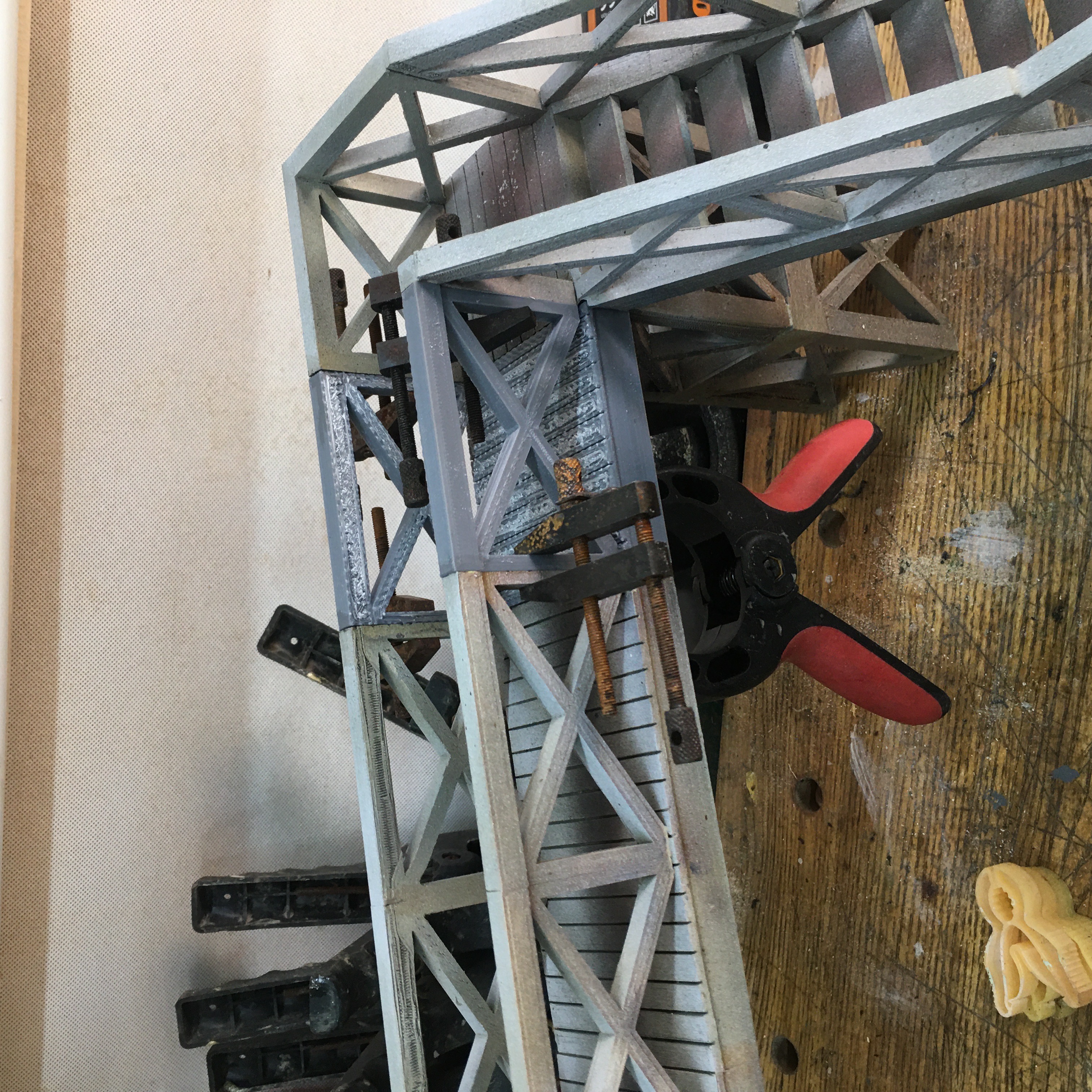

In having modified the track layout the footbridge needed to be lengthened. Not an issue, new components based on the original components were printed overnight, and fitted into place this morning. Just needs the paint adding tomorrow and it will be ready to go into position:

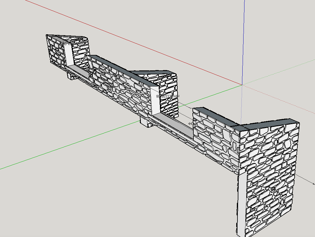

The next modification is needed to fit the coal siding and the coal drops in alongside the goods shed.
You might notice from the photographs that last year I completed most of the retaining wall below the track bed. The weather closed progress on that down with just a 5 ft long section to complete. So the structure below the track is now wider at the station, and that was intended to allow the track bed to be widened to take the coal siding. I have a rough model of the coal drops ready to print. It isn't finished yet - as I expect to only be able to fit in part of the coal drops. This is the basic model based on information provided by David John:

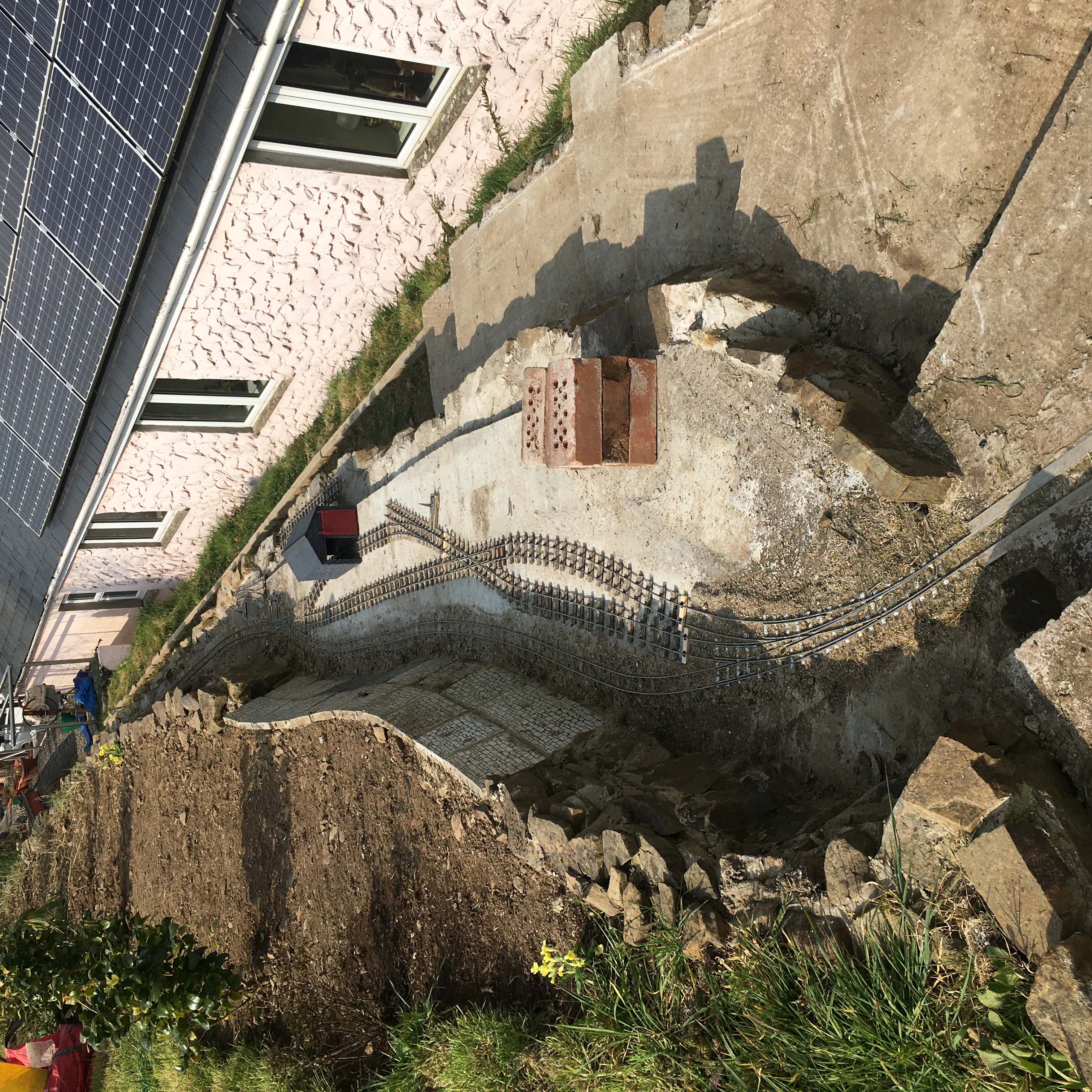

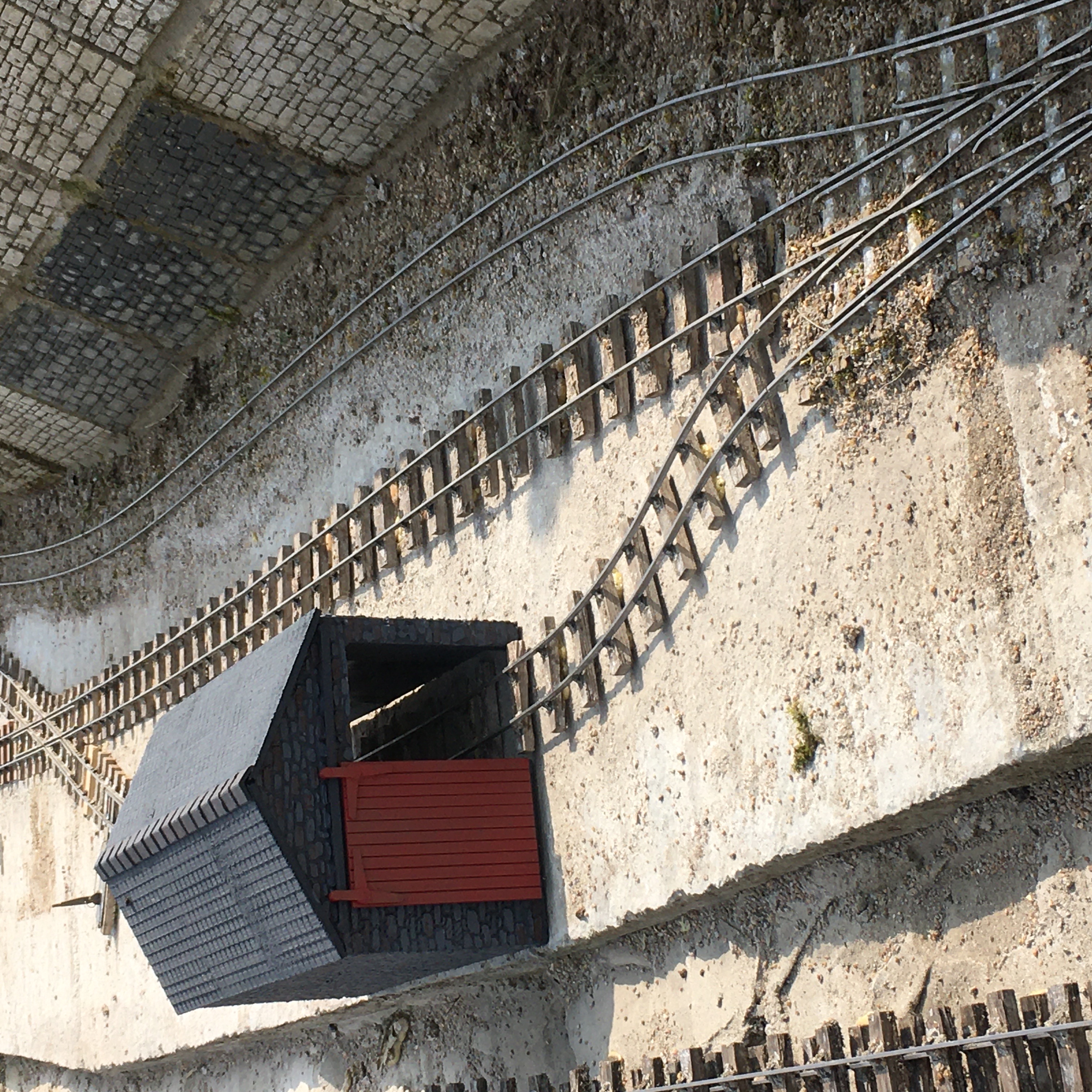

I managed to make a small amount of progress before the weather went cold again - concrete to form a base for the coal siding:
and the track re-laid onto the concrete:
That includes 2 off 3 D printed wagon turntables to feed the coal drops (as per the prototype). So there is just enough room for the goods-shed.

Posted: Tue Apr 05, 2022 8:54 am
by Scrat
Great work.
What about leaving the added section of the footbridge as it is or paint it in a slightly different colour to show that it had been repaired at some time?
Posted: Tue Apr 05, 2022 9:34 am
by Andrew
That's looking very good. The goods shed is especially nice - it's going to be a challenge to propel wagons through it though!
Posted: Wed Apr 06, 2022 9:32 am
by Trevor Thompson
Scrat wrote: Tue Apr 05, 2022 8:54 am Great work.
I will give that some thought!

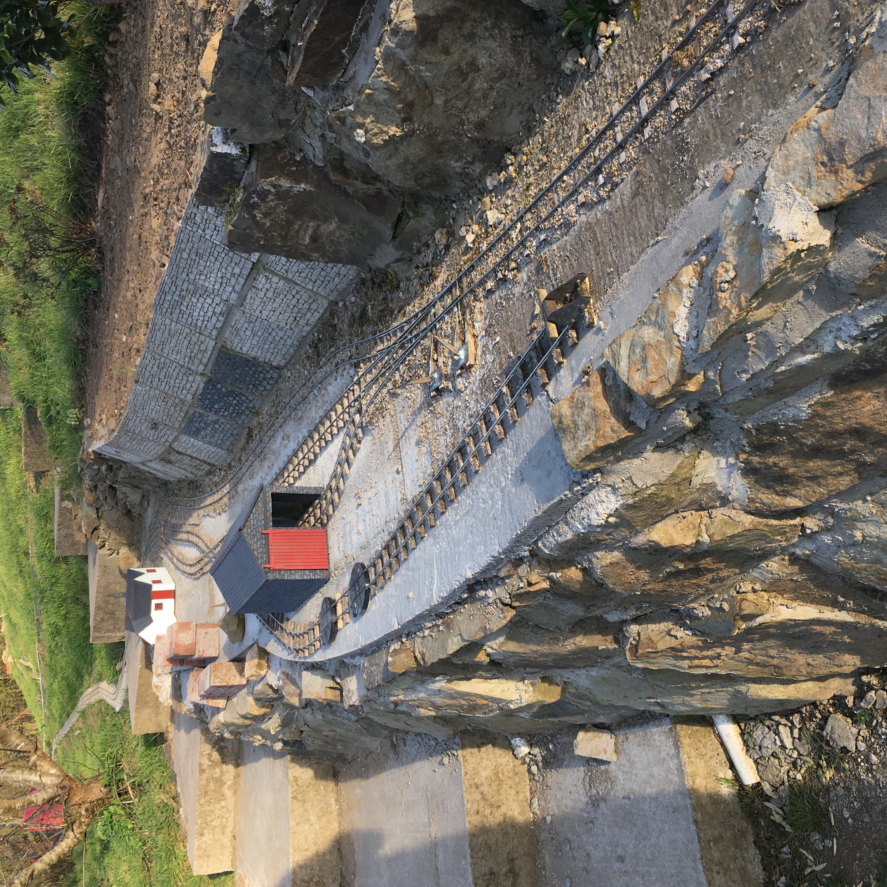

It has taken a while to actually do it, but I have installed the fencing and all the buildings in a semi permanent way, and re-ballasted everything:

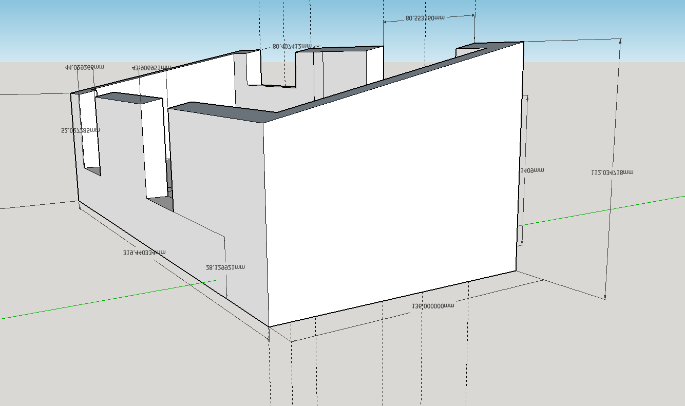

The coal drops are almost ready to print, well as much of them as I can actually get into the space available:
Screenshot 2022-04-21 at 15.23.02.png (117.37 KiB) Viewed 6128 times
