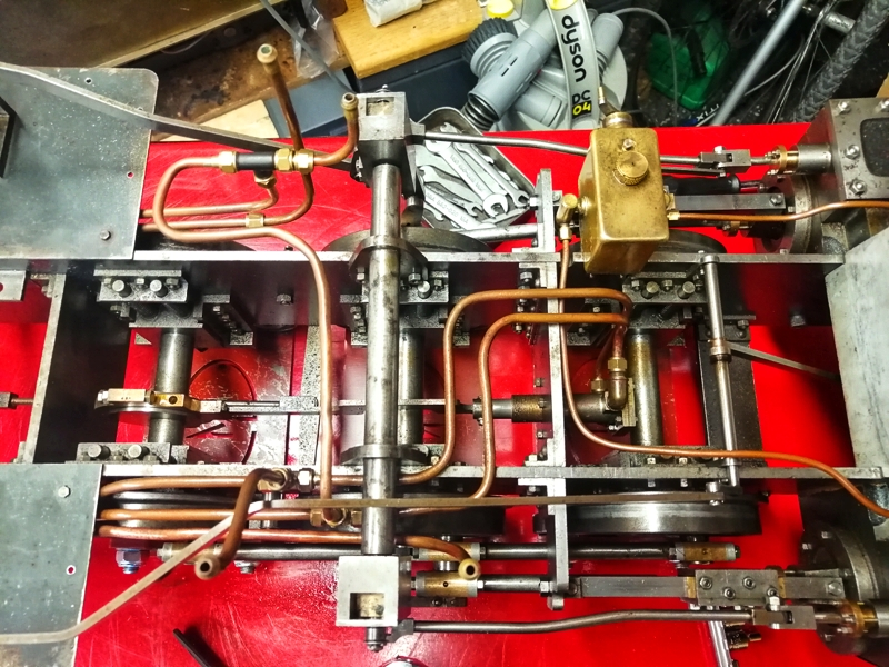

So to begin, I had to disconnect all the various pipe work and remove the saddle tank and boiler:
Which left me with this:
A view of the majority of the pipework (that horrible bend to the left side of the picture on the water pipe for the hand pump/axle pump was my first attempt before I bought some fire bricks and learnt to anneal pipes properly, I am going to redo before putting the loco back together):
Smokebox removed and deciding what needs to be taken apart next (notice the orange stuff around the cylinders):
Closer inspection revealed it was gasket sealant, however, the cylinders are already fitted with thick gaskets to reduce heat loss into the chassis so I guess the use of sealant was just a belt and braces approach:
Scraping it off was not getting me anywhere and I didn't want to remove the cylinders so I read that paint stripper works well if left on for a while and sure enough it faked off very easily, result!
I managed to remove all the wheels and motion complete which was another result (notice I have written 'FRONT' on the piece of wood, I just need to remember that I removed this with the chassis upside down!)
And here we are ready for cleaning and painting:
I was able to do all the man handling of the chassis on my own as without the boiler it is just about manageable (the hydraulic lifting table earning its keep here!)
