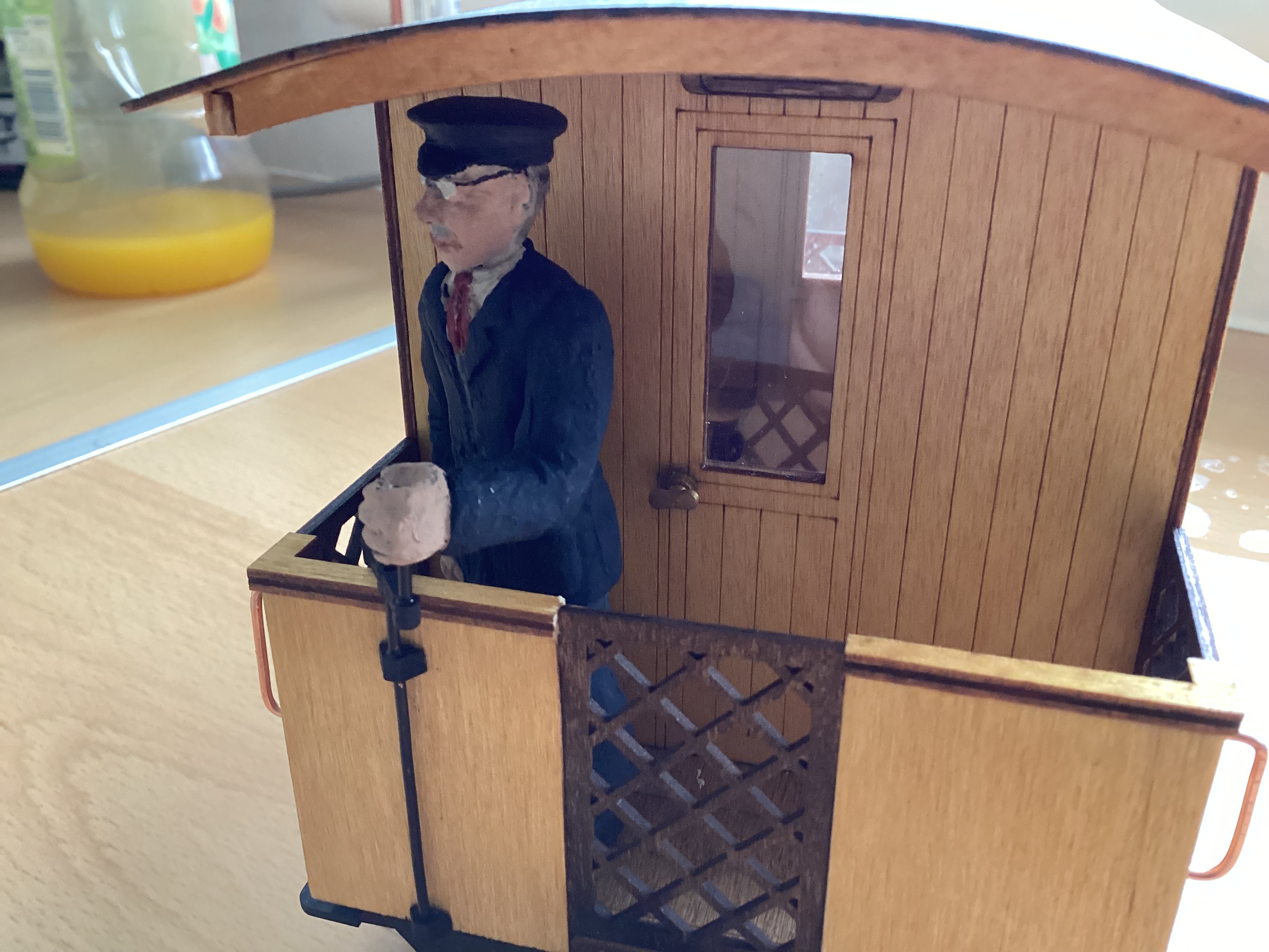

3D printed door handles arrived from Jerry Irwin yesterday, each is in two parts, the T handle itself and the collar is separate. I used gold gilding cream to colour them. I had to shorten the stub of one of each back to back pair to allow them both to fit snuggly either side of the coach wall then glued them in.
I eventually finished painting some figures earlier in the week. This guy was too tall for other items of rolling stock, by serendipity his hand is at the right height to hold the brake handle.
