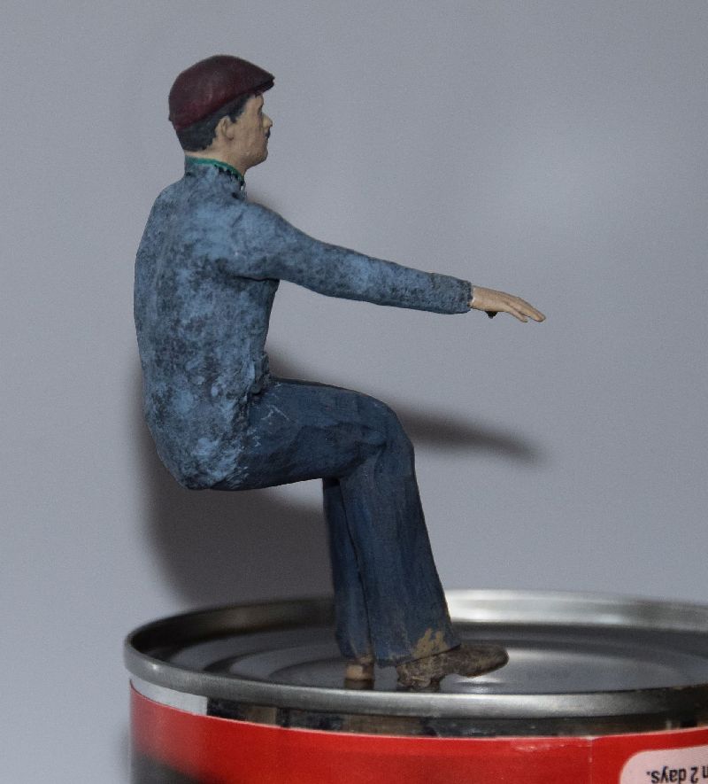

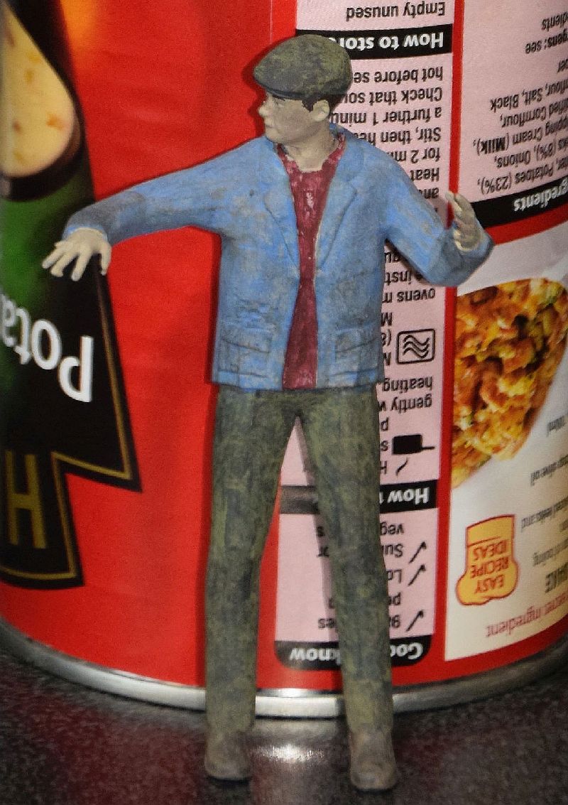

Anyway, I've used the last few days to sort out the loco crew and I'm feeling quite pleased with them. The driver is sitting on the water tank with his hand on the regulator, but the regulator is part of the body and the tank is part of the chassis and whichever part I fix him to means that I can't separate the two. Normally I'd put a screw up his leg from underneath, but that won't work with this because I can't get to the bottom at that point. Then I remembered reading about people using magnets to hold figures and thought that might be the answer. I managed to find some 3mm diam by 1.5mm thick Neodym magnets and got some to try. I filed the drivers heels off and Gorilla-glued a magnet to each heel, then a small piece of tinplate can lid was glued to the floor and hey presto! If I do this in future I'll print a hole for the mgnet, because the resin is too brittle to drill.

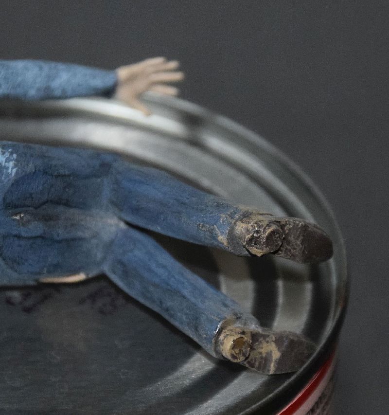

This shows him sitting in mid air to show the strength of these little magnets, and a view of the magnets from underneath, and finally, just so he doesn't feel left out, his mate leaning against the can! I'll magnet him in due course, once I can put the body back on the chassis to get the alignment right.

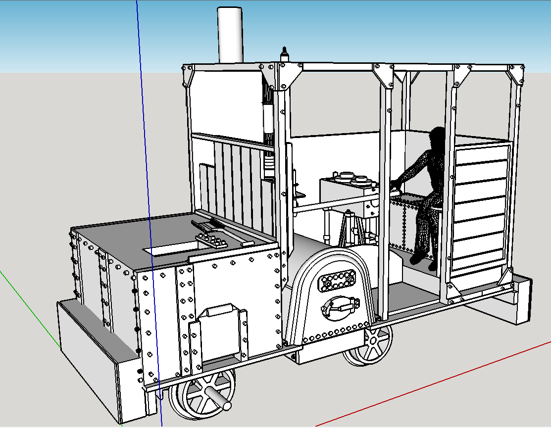

Saved that and exported it to get it into Sketchup and put it in position inside the complete drawn loco.
Screenshot 2022-02-09 11.24.00.png (61.04 KiB) Viewed 13792 times

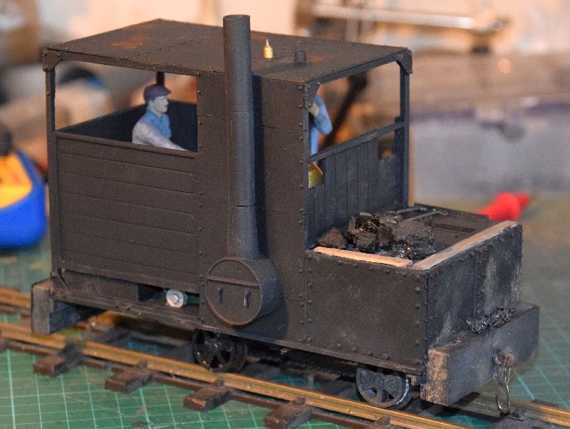

Well... here she is:
This shot is as close as I can get to the original 'big' picture:
The RH side, based on the very grainy picture from the the pair:

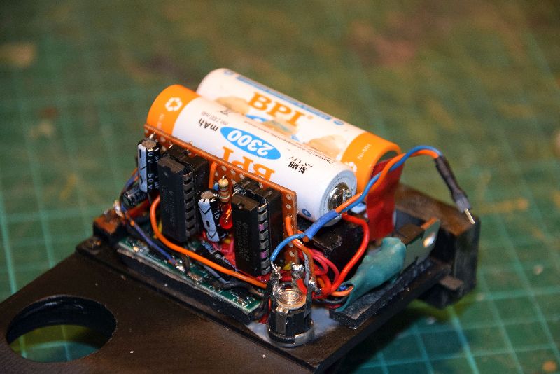

Graeme earlier commented about how I would get all the 'electrickery' in. So this is what is under the bonnet/coal bunker:
DSC_0009 small.jpg (131.52 KiB) Viewed 13716 times
From the left: On/Off switch; the 'LED Controller' Rx board flat on the floor; on edge above it is the reversing board; to the right of that is the charging socket; and behind that in the green sleeve is the voltage regulator supplying 5v to the reversing board. The flying lead with a small socket on the end is the connection to the sound system which is housed in the boiler. At the back, over the motor, are three of the 5 batteries, the other two being in the water tank at the back of the contraption!
Once I can get outside and find some track from under the vegetation, I'll get a short video of it in action and post a link.
