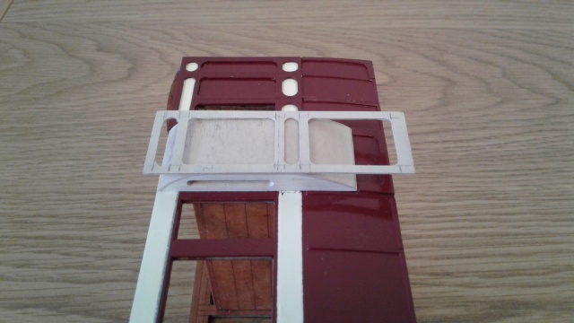

Hi all.
One ducket trying for fit.
David.

Hi all.
Just finished cutting the 2 new sets of beading. Another 24 rounded corners he he.
Because i am planning to fit them after painting and fitting the duckets, i have made them full height.
David.

Hi all.
New duckets and beading primed (3 coats) and painted.
Next job to paint the cream panels.
David.

Hi all
Started to glue the beading on to the duckets this evening. I am using araldite rapid Grant. (Quick drying epoxy).
I am starting on the sharp curve (top) first and letting it dry completely before moving down. Not a quick job i know but if i tried to do it all in one go i know i would get glue everywhere. :(
Probably take another two sessions to complete this one job.
David.

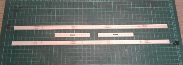

While waiting for paint and glue to cure on the duckets i have made a start on the coach underframe. The two points that stand out to me looking at photos 2 and 3 on page 1 of this thread are the rivets/bolts on the solebars and the fact that the solebars are set in slightly from the ends of the buffer beams. From the makers photo of the coach i have scaled up the relative distances of the four sets of 4 rivets and the pair of single rivets. Following other threads on this forum, there are obviously a few methods members use for adding rivet detail. I have previously done it in a way i have not seen before and have used it this time also.
After cutting two solebars 9mm by 3mm to appropriate length i marked out the relative positions of the rivets with pencil and punched with a steel scriber point. The next job was to drill through with a 1mm drill. Soft dressmakers pins were then cut to approx 3mm in length and superglued into the holes.
Completed solebars and buffer beams.
Closeup of rivet detail.
The buffer beams are made as a lamination of 3 pieces of 3mm by 3mm wood which has allowed me to include a 12mm x 3mm slot to take the square shaft of the Slaters chopper couplings that i use. The width of the slot allows the coupling to swing horizontally.
