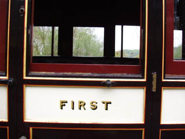

I found LNWR blackberry to be a better match from phoenix for vintage stock the lining is actually a pale yellow and not gold. Seen on the curly roof van last year!

from what I saw of the bug box last year I noted it was outside to inside: Cream, gold, red.

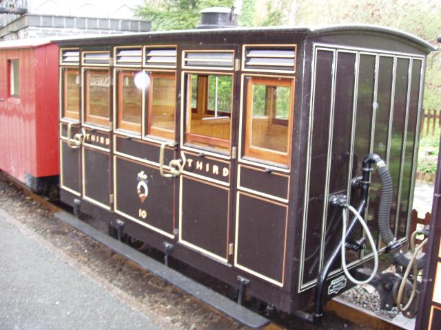

Their Ashbury coach is all over brown colour by the way.

Go for blackberry LNWR as from experience this is a better match and you will need loads of coats with the LNWR plum to get the rich deep colour of the original. Dont use gloss I dont think Phoenix do it anyway use dull and if u want gloss then use a satin varnish after applying your transfers. Cream is cream but it is a light one nearly white The yellowish tint is from the weathering of the varnish on the prototype that has made it look creamier

Thanks Methssniffer for the photos :D and thanks Peter for the other info :D .
