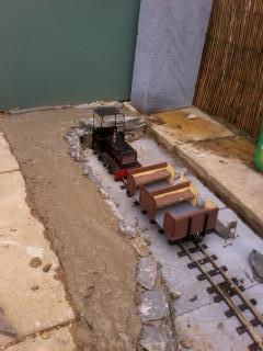

Some more pics of construction , cant wait till summer when the garden is less loking dead lol
Final Nail going in :D!!!!
The slate walling needs grouting and cleaning up :) and everytinhg needs ballasting

Post by Dr. Bond of the DVLR » Sun Mar 21, 2010 7:52 pm
Looks brilliant, what are you going to do with that back bed which the railway runs through?

Sammmm
Post by Sammmm » Sun Mar 21, 2010 8:37 pm
Well i experimented with a mix
1 Part cement
4 1/2 part sharp sand
1 part compost (with large bits removed)
Water to a mortar consistancy maybe a little wetter ( but not too wet ! )
Then i use disposable plastic gloves to apply it to the track patting it to get it to move into every bit (when you patt it it will apear to gett wettter dont worry )
then using a Mid soft brush ( i use a brush off a dustpan and brush ) and brush it until you can see sleepers and making sure edges of rails are clear for flanges

Sammmm
Post by Sammmm » Tue Mar 23, 2010 7:44 am
Mr. Bond of the DVLR wrote:Looks brilliant, what are you going to do with that back bed which the railway runs through?
Umm at some point probly put a halt but after the plants have matured so i can see where to put it and where to put more plants :) (And so that the cats stop using it as a litter tray! :( everything i dig or build is a big litter tray to them even with reppellent on =/)
