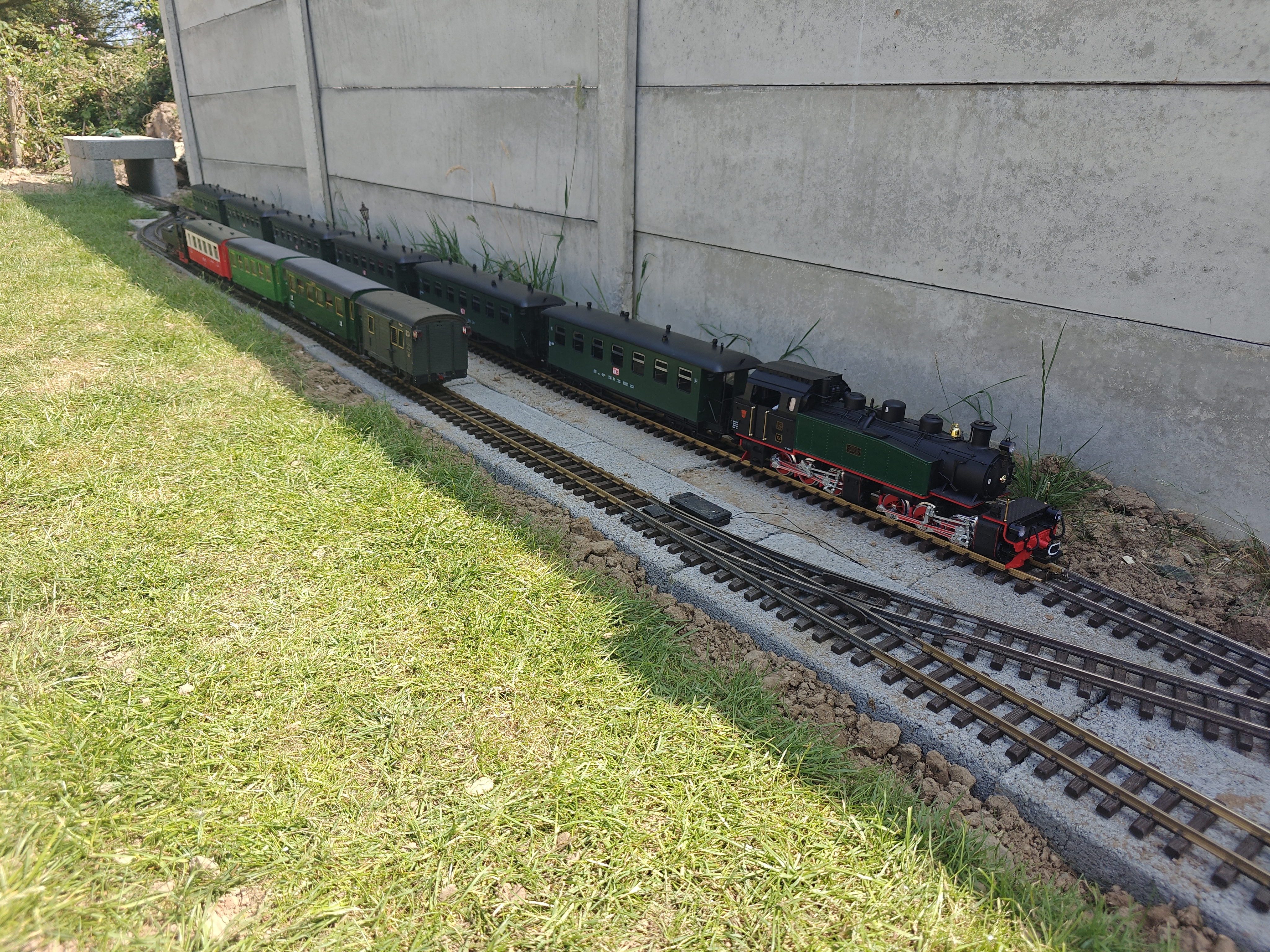

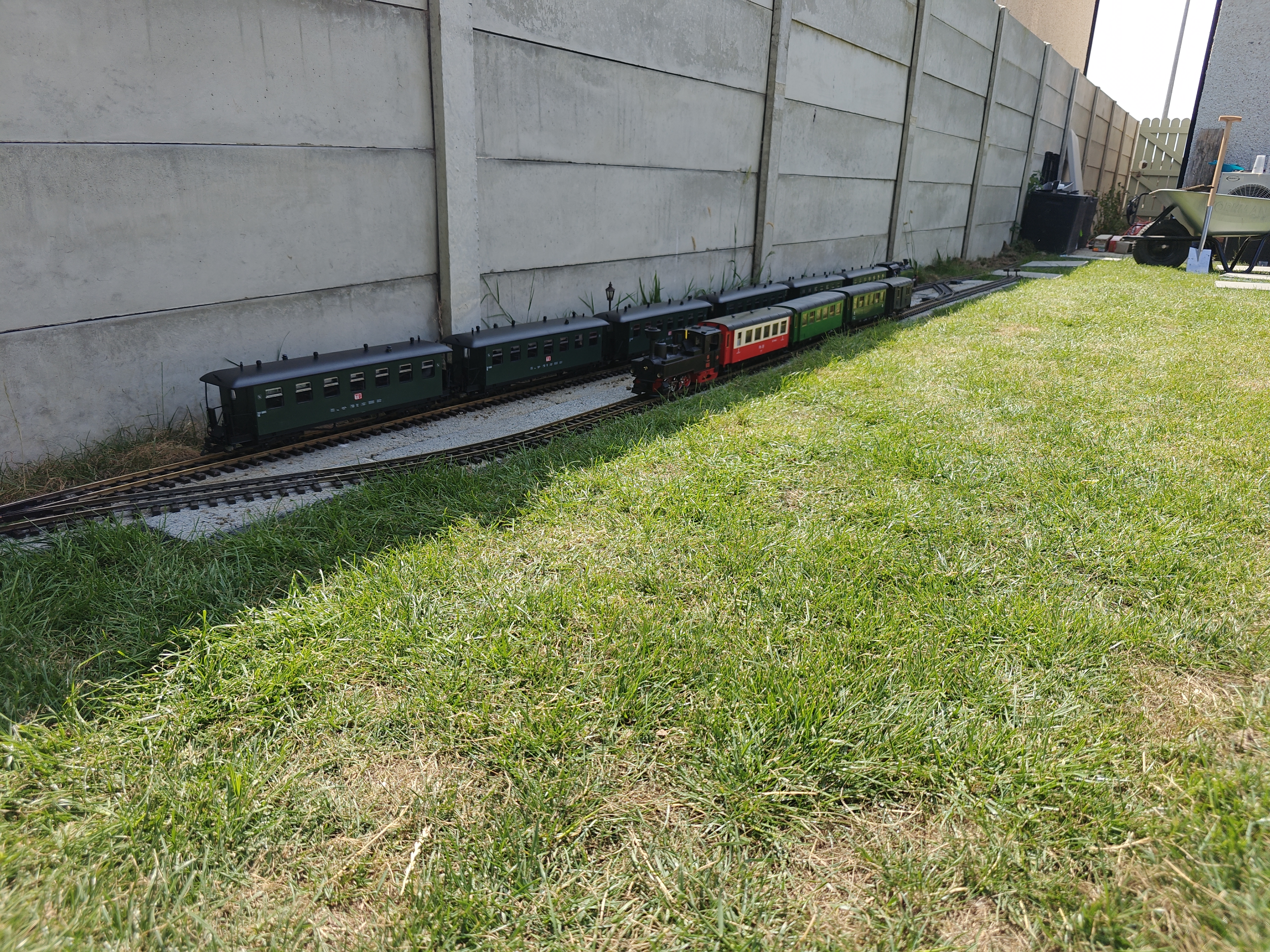

Couple of new additions to the roster, a Roundhouse Russell ran lightly bought for £400.00 because it ran really poorly, only the boiler was full of limescale and derailed everywhere, on closer inspection at home the front and rear pony wheels were installed in the wrong ends - resulting in derailments at every minor track imperfection. Ten minute fix and runs like any roundhouse loco should. An overnight limescale flush is next on the agenda for that. Coaches a purchase from eBay for £25.00 each, there are two more coaches of the typical Bachmann big haulers style in the same livery included in a job lot for £100 - all going cheap because one axle was snapped, but still present and included.... 5 minutes of no more nails and it runs wonderfully.
I also have a few more bits from where I got the Russell, I'll post those later.
Tomorrow it is back to laying the track bed and Wednesday I'll go to the builders merchants and buy £20 more of bricks... (that's all I can fit in a saloon car boot).
I appreciate the lining and ballasting tips, I will source some edging to go with the track bed Wednesday.
If anybody recognises the coaches let me know i.e. where they came from or what kit they're built from or even who owned them last, I wouldn't mind some more.

Looks great, you got a bargain there,
Posts: 7931
Re: Stawberry Valley Light Railway
Post by ge_rik » Tue Jul 21, 2026 8:31 am
gilfachphil wrote: Tue Jul 21, 2026 7:04 am Looks great, you got a bargain there,
My thinking on both counts.
Can't identify the coaches. Are they ply or plastic?
It appears to be laser cut ply. Here's some more photos.

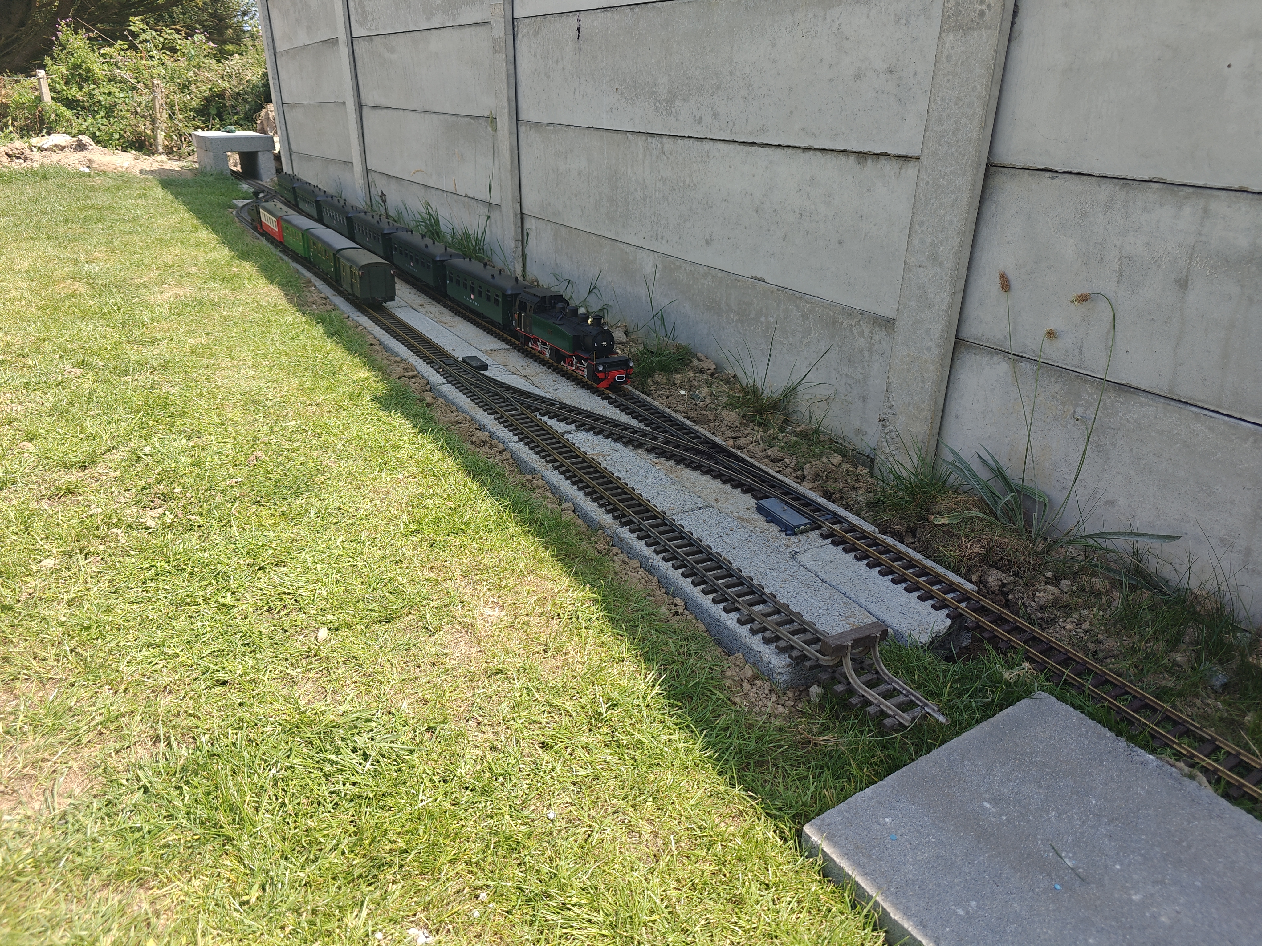

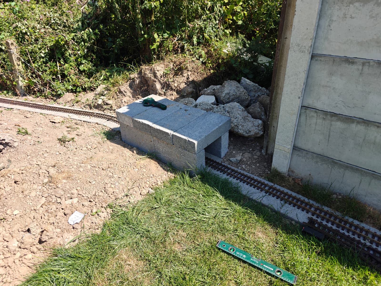

So I managed to get some more bricks today, and will pick up some more tomorrow...
I found a spot for a small station to be placed whilst I was laying the track back. I now have a siding where a station will be.
I also smoothed out some track bed that was already laid to make a smoother transition to slight inclines.
I put the bricks in where I will place a tunnel, It will be covered in clay from a small pond I am going to build. It will also have a small stream/waterfall running over it.
The paving slabs are for a shed the railway will run through in the corner of the garden.
Here is some more progress pictures.

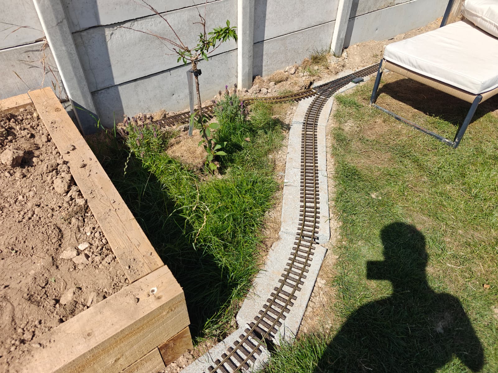

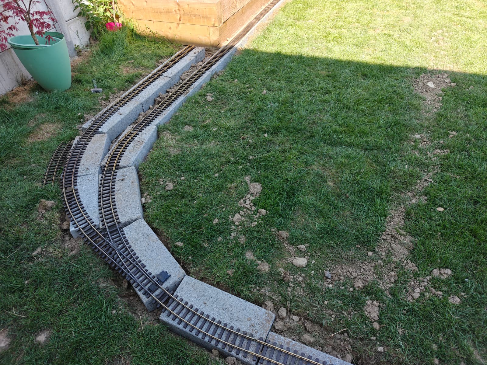

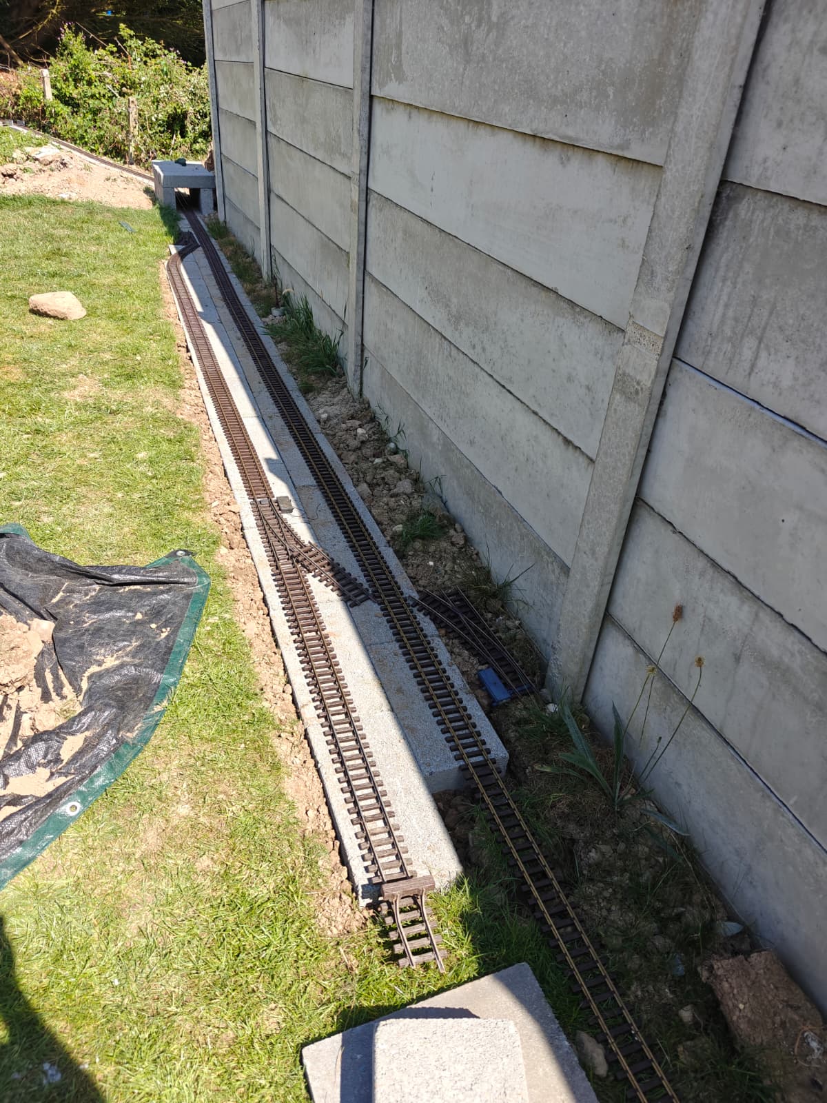

So I did a bit more work, more track bed down now. I'm going to let it sit for a while whilst I watch for subsidence and make sure I am happy with the layout before I concrete it all in.
Some track isn't quite lined up with the track bed, this is because I am awaiting a delivery of more suitable track with the correct geometry. Hopefully this gives more of an idea of where I'm going.
There is a last minute new addition new siding down behind the lavender plants, that will not have the same track bed as the concrete from the fence only a few cm below ground in this location. I will have to suffice with some sort of weed barrier, perhaps the really thick rubber ones.

Aaand I have the geometry of the track all worked out for the station loop.
I have some of those ECR el cheapo coaches running today. I know some turn their nose up at them, but for the cost of one new LGB coach I bought SIX of these, can't fault the value!

Today's update tunnel is a little more completed, I will cement in the rocks when I am sure of their location. Just throwing rocks and dirt at it with no plan to see what I like.
