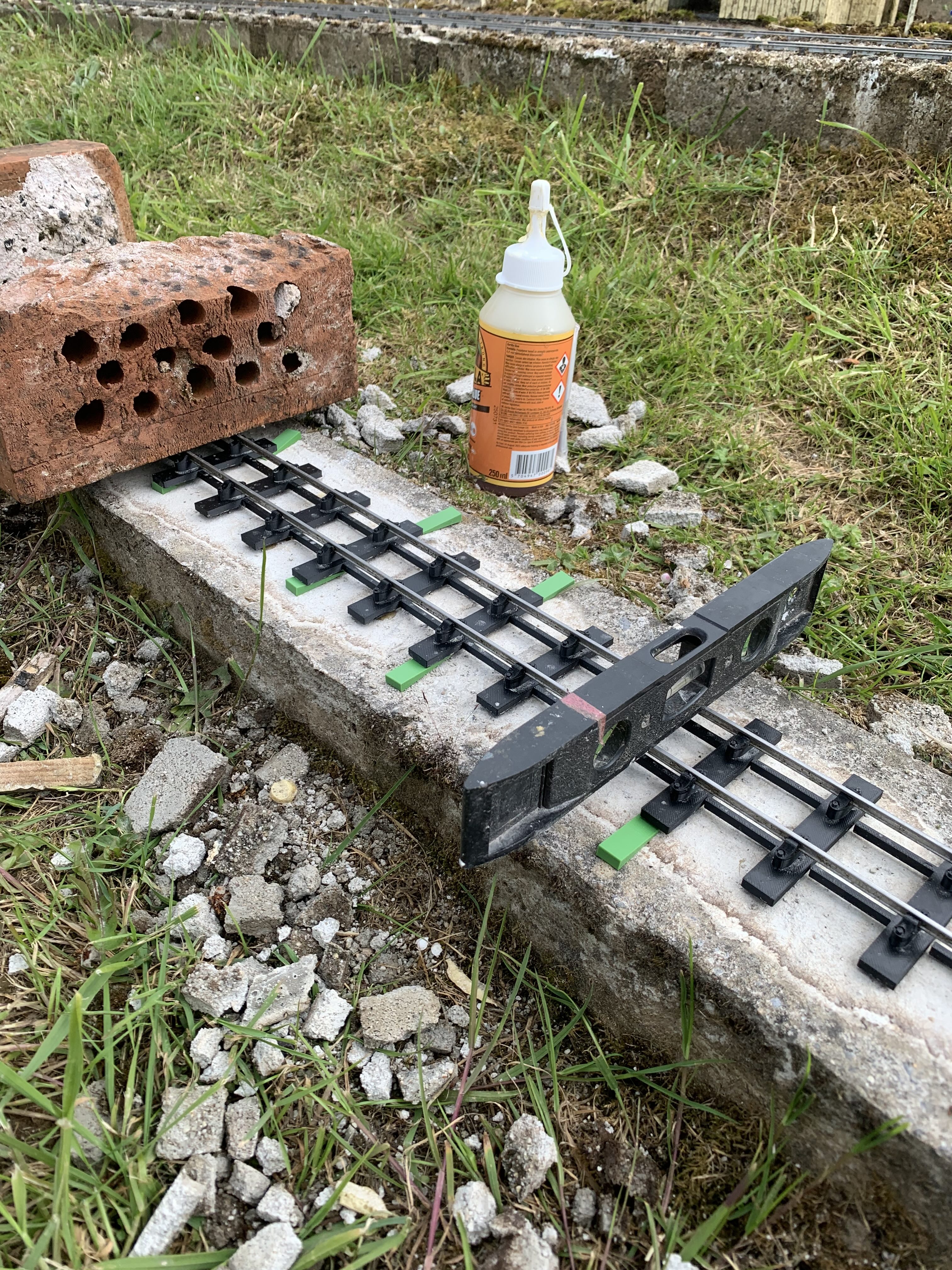

Quite a few wagons (particularly light ones) were derailing on the curve leading into the viaduct. Where I have removed a length of track in this photo:
It looked on Saturday as if there was a dip in the right hand rail in the middle of the curve where two lengths of track joined. When I looked at it again with a spirit level I could see that it wasn't a dip - but a bulge half a track length back. It just looked like a dip because that was where the wheel came off the rail. This curve has slight superelevation - purely accidental I hasten to add - but the bulge changed that for a short length to excessive superelevation.
I know that the trackbed moves as the ground dries out and gets soaked again, and this is compounded by moles. There are the remains of three mole hills visible in this photo. I think things have moved in this area because I don't remember having issues here last year.
Anyway - solution.
I chipped out the ballast and removed the length of track. Rather than reuse the part worn sleepers and chairs I printed 24 sleeper units. I carried out a shrinkage test on the black ABS, to ensure that the track gauge was accurate. (More about that later).
Relaying the track:
I have been careful to ensure that the slight superelevation is maintained consistently through the curve by printing wedges, and fitting them under some of the sleeper units before holding them down with my usual bricks while the glue sets. The foaming glue fills the gaps under alternate sleepers, and the bricks stop the foaming action lifting the track.
So that should be the first issue resolved.

Thanks Grant - well it is fixed:
I have assembled a train which includes the wagons most likely to derail:
It includes heavy wagons alternating with light ones, and the last 3 wagons which really like to come off the track. It went round the bend with out any issues. So to the next problem.
The recently relaid passing loop caused problems. Things were derailing on the bend leading to this point:
When I looked carefully the points were fine- but the track in the loop was out of gauge. 31mm between the rails. Bit of a surprise really - definitely an "Oh s****" moment. The issue was partly the kink, but more the narrowness of the track at the critical point.
So It is going to take some effort to fix it, but I have used a narrow cold chisel to dig down to the sleeper around the chairs on one rail. Then I have split the chairs from the sleepers using a carving tool (a mini chisel effectively) and reglued the chairs into place using track gauges and weights. The kink is undesirable but everything goes through the loop now without derailing. Just have to repeat this on the other side of the loop, and then on to some minor issues with excess ballast at "Dinas".
