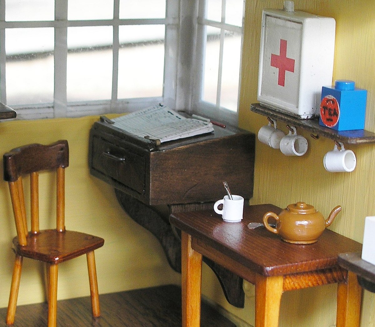

Couldn't agree more, it's the excuse I tell myself for the state of my workbench. I keep all sorts of off cuts of every thing, you never know what you might need for some detail item. I put pencils on the desk in my signal box, but didn't go to anywhere near the extent that you've gone to.Dr. Bond of the DVLR wrote: ↑Sun Apr 12, 2026 5:11 pm it doesn't cost very much at all making bits from scrap.

Grant: That signal box interior is spectacular. I like the hold down clips for the train register on the desk.
I've been thinking I need to make a tea cup - did you make the ones shown, if so could you share how you did it?

PS. sorry forgot about the cups, styrene tube cut to length, appropriate hole punch provided styrene ends and a bent piece of wire supa glued into place for a handle. Painted in thick white enamel.
