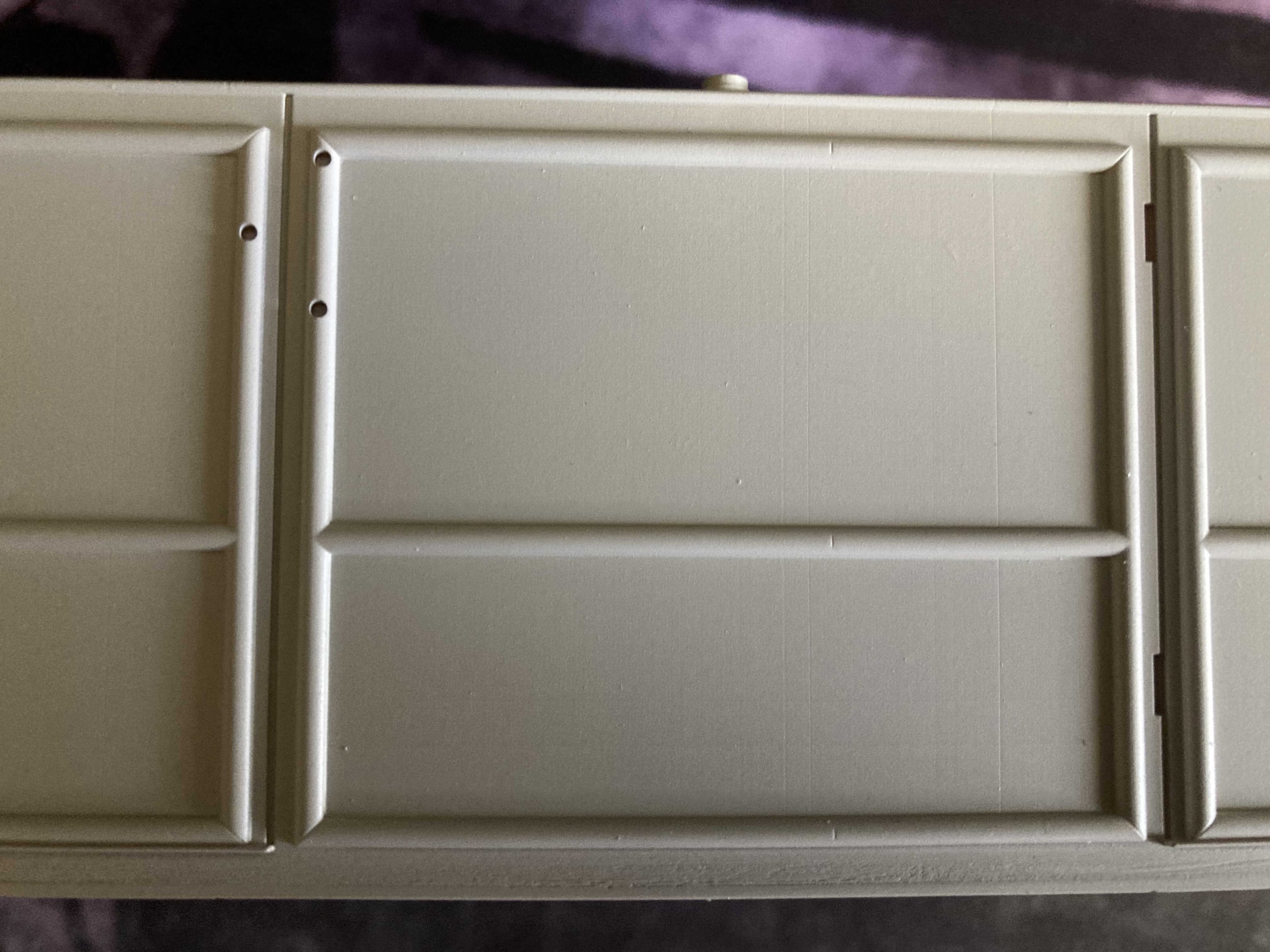

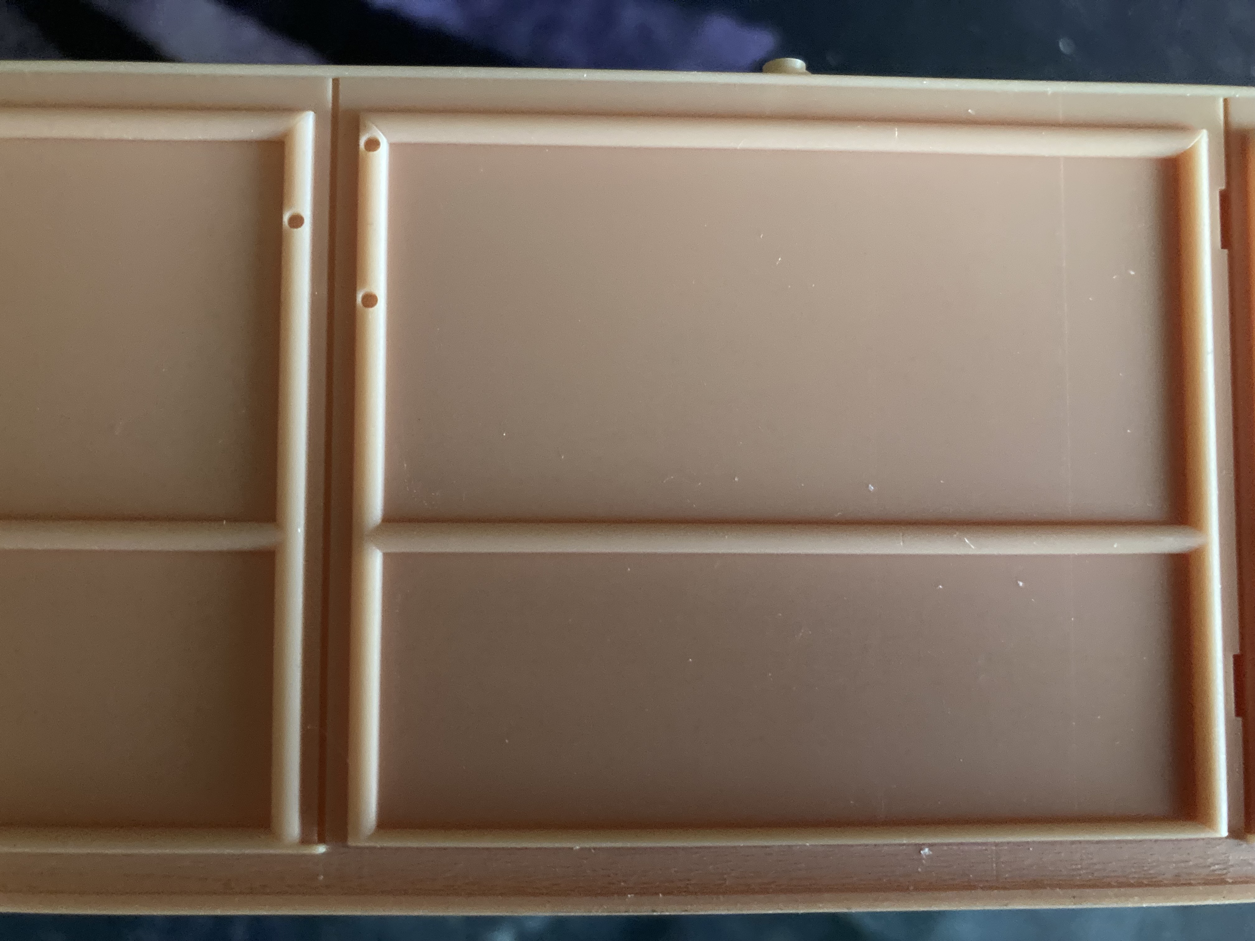

Sharing some experience from my current project to print the GVT third open carriages, I had problems with loss of detail on the sides when printing all in one, body and floor together. I found I lost the beading up to the height of the top of the floor and also had a less smooth finish to the external surface. What I think was happening was the resin was still flowing out from under the model whilst the UV light was on, so external parts of the print were effectively washed away before having chance to cure and adhere to the main body structure. The floor area on these prints took up about 90% of the build plate area so there is a lot of resin that needs to escape as the build plate lowers. I tried increasing the light off delay to the maximum setting on my machine, which helped a bit, but in the end, the solution was to make the floor thinner so it finished printing at a height before any of the beading started.
You can see the difference in the two attached photos, the one in pink resin has the thicker (5mm) floor and the lower beading is very thin. The other photo is a second print with the thinner (3mm) floor and the lower beading has printed properly at its full width.
You may not have the same issue as me as it will depend on the viscosity of the resin, size of the model, print settings (light off delay) and what details are where in the model, but thought I’d mention it as it caused me a few days of frustration and head scratching before I found a solution. I have gone back to a separate floor for my subsequent designs, just including a very thin (0.25mm) false floor that is to help ensure adhesion to the build plate (the false floor is later removed).

I have had that sort of problem in the past and not found an answer myself. I was trying to print the footplate and sideframes of a DeWinton as one piece and I kept getting a sideways bulge about 0.75mm thick, along the top of the frames, which reflected the footplate thickness. However, in one of Trevor's threads ( I can't now remember which one, unfortunately) he had a similar problem and solved it by curving the internal angle rather than leaving it as a right angle.
