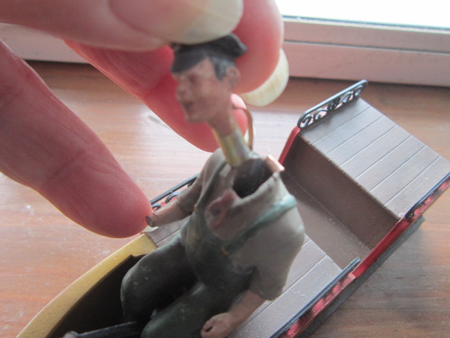

Would it be possible to insert a battery into the drivers body from the bottom ?
Posts: 5729
Re: 16mm Scale O&K MD1
Post by Peter Butler » Sun Feb 02, 2025 2:44 pm
hoppy504 wrote: Sun Feb 02, 2025 1:29 pm Would it be possible to insert a battery into the drivers body from the bottom ?
That's exactly what I had to do with my 'Spooner's Boat' model. The seated driver was drilled from the bottom to hold an AAA battery with a brass strip alongside it, this becomes the full circuit when the head is attached with a brass tube around his neck acting as a switch...
Unfortunately not powerful enough to include RC.

Peter Butler wrote: Sun Feb 02, 2025 2:44 pm
Ingenious!
