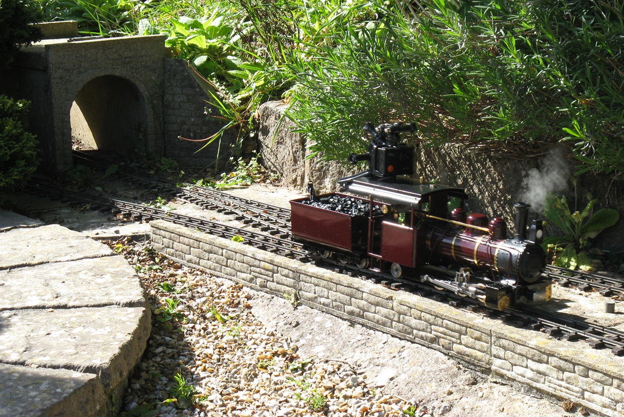

One of the problems with any 'artistic' filming is the size of the camera compared to the locos and stock:
Fowler with camera.jpg (602.53 KiB) Viewed 143430 times
It's not huge but still causes 'fun and games' ( ;) ) with clearances!

Petersfield wrote: Sat Apr 26, 2025 8:15 pm One of the problems with any 'artistic' filming is the size of the camera compared to the locos and stock:
Nice behind the scenes shot, I was wondering about camera clearance while watching... Nice save under the bridge!

drewzero1 wrote: Tue May 06, 2025 9:54 am Nice behind the scenes shot, I was wondering about camera clearance while watching... Nice save under the bridge!
Yes, I gather Heather's spent quite a bit of time editing. Certainly when we were shooting it was rather stop start. Two of us spent serious time on hands and knees holding back and pruning foliage and unclipping and reclipping the camera onto the cab roof before and after bridges. ;)

A few days ago, we tried a different approach on the Axe Valley Railway. This line has a lot of overhanging foliage so the stop start that worked for just a couple of bridges would not work here.
Having tried pushing a truck which, even with weights, was noisy and caused a slight vibration on the film. We found that attaching to the heavy live steam locomotive provided a much better solid filming base. The over the cab view is very atmospheric but creates problems with low infrastructure. The steam is lovely but can hide the view of the line.
This latest experiment hung a camera on the front of the locomotive. The Roundhouse Fowler has a dummy head lamp held by a small machine screw. Removing the lamp and using the machine screw to hold a custom-made bracket seems to work. The bracket was designed in Free CAD and printed in ABS to cope with the heat. Holding the camera slightly in front of the smoke box and resting lightly on the coupling it takes the screw fixing onto the standard GoPro system camera holder.
We achieved the stability and captured much more sound of the steam engine than we did from pushing a truck. The plastic of the bracket did soften but held up well enough and the camera took no damage at all. I guess the ideal would be to print in a resin that will not soften with heat. I might try printing the bracket without holes, make a silicon mould then cast in epoxy or other resin. Drill the holes and try that. A suitable filler or carbon fibre in the resin should reduce the brittleness of the resin casting.
Making custom fittings to attach to standard GoPro fittings opens up more possibilities of getting the camera in exactly the right, stable position seems to be the way to go. With live steam locos dealing with the hot surfaces is another factor to consider.
