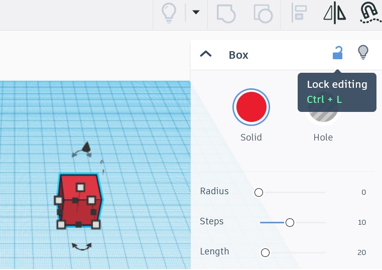

No ability to lock sizes makes it too easy to accidentally resize things if you touch the wrong handle.

It's easy to lock shapes - the drop-down menu for each shape has a lock function

Grouped shapes can similarly be locked and complex shapes can be saved as Favourites and locked.

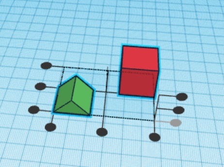

The alignment tool includes snap to middle and edges in all three planes - and is dead easy to use. Clicking on any of the shapes while in align mode will cause any of the other shapes to align to it.

The only down side to locking something in TinkerCad is that not only can't you resize it (the way I would expect), but you also can't move it without unlocking it, unless as you say you make it a favorite and lock the scaling. I use the favorite and lock the scaling for motors and gears etc as their size never changes.
The big downside to Tinkercad is that if you accidentally drag on the wrong bit you resize a shape(s) and you didn't mean to, you actually meant to move it. I have found this to be a nightmare as if you realise you did it, all is good an you can undo it, but if you don't realise it until later, you have ended up building something around a wrong size object and then everything needs redoing. By then I have often printed it and sit there wondering what I have done wrong, sometimes, it's only a mm or so, but often it's some ridiculous 0.87mm or something daft. Does my nut in. :lol:
I have never really worked out the alignment tool (I do realise I should) and generally do everything by the ruler tool and how far away things are from a given point, either using mid or endpoint, depending on what's needed. I usually build everything around a mid point as I find it easier. Horses for courses as they say.

Not what I was referring to. That locks the item, not only dimensionally, but also in space. You can't create an object, lock it's dimension then move it's location or duplicate it easily. The workaround is having to create it as a 'my creation', then dragging it on an individual basis into the workspace each time you need an instance. All rather clumsy.
You're missing my point. It only aligns to the outer boundaries of objects. This becomes frustrating once you've started to build a model by groups of primaries.
