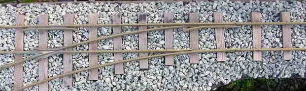

Making/designing springs is above my pay grade. Have you considered a fixed blade turnout for the return loop?philipy wrote: Wed Jun 28, 2023 1:56 pm In Tom-tom-go's RWLR thread, on Page 9 he shows how he arranged the spring for his sprung points.
I have it in mind to do something very similar but I'm struggling with what sort of spring to get, anyone got any suggestions?
The photo below was posted by Tony Willmore some time back. I couldn't link to the original post, but I saved the pic in my files at the time, so I've posted it again.
I haven't built one myself, but they do much the same job as a sprung turnout, with the advantage of no moving parts. (Always a plus out in the garden.......)

Well the springs that I ordered from Amazon were no good for what I wanted and the more I looked at the turnout that I wanted to use, the less convinced I was that springing it was actually a good idea. It is a bit stiff and although a heavy steam loco would probably go through OK, I'm less convinced that the little locos I use would be able to push against a spring.
So to cut a long story short, I reverted to Tony W's non-moving point blades, as suggested by Graeme a couple of days ago. Was actually pretty easy, just needing the unit removing from its location, the point blades shortening a little and then a couple of straps soldering underneath the fix them in place before putting it back down.
