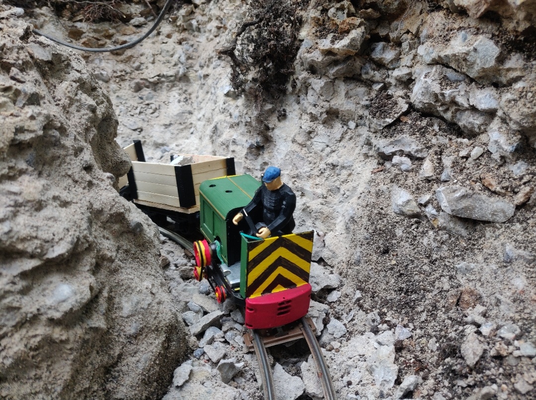

Industrial diesel 'Moke' pulls a stone train through a cutting in the quarry prior to its closure.

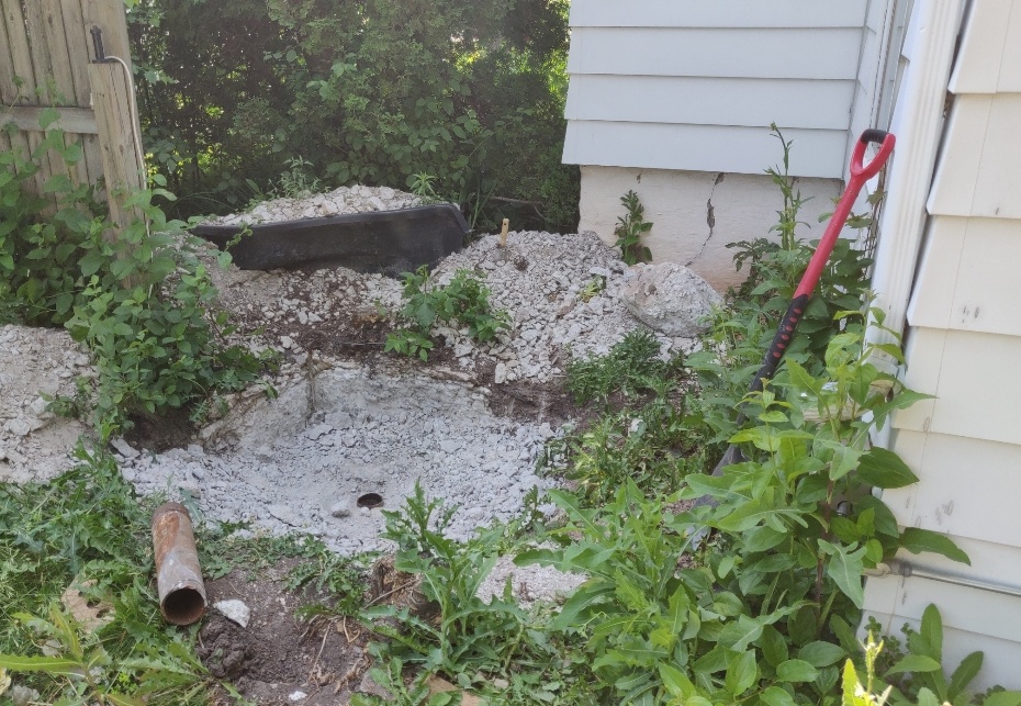

Yesterday marked a special day in two ways: track arrived in the mail, and I finally (almost) completed the year-long process of knocking out the primary roadblock to construction-- a concrete foundation with some large metal pieces sticking up. The immediate plan is to install two preformed pond liners with a small waterfall or spillway in-between, and start with a loop of track around them at around knee height. Later on it might be nice to extend the track along the house and/or fence, add a tunnel, maybe a bridge, and a runaround loop, but for now I'm going to keep it simple with a single loop and see how long it takes to get bored. If I can build it quickly and cheaply enough, and the effect is pleasing enough, I suspect it won't be difficult to get parliamentary approval for a branch line or extension for next year. :lol:
The quarry near the end of operation. The large pipe in the foreground was extracted in preparation for converting the quarry into a lake.
The grand plan for the space also includes revamping the adjoining patio, so that will likely take precedence over this project (but also push it along). With any luck I'll be able to run some trains out here before the snow flies!

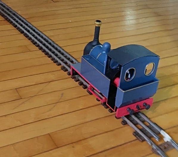

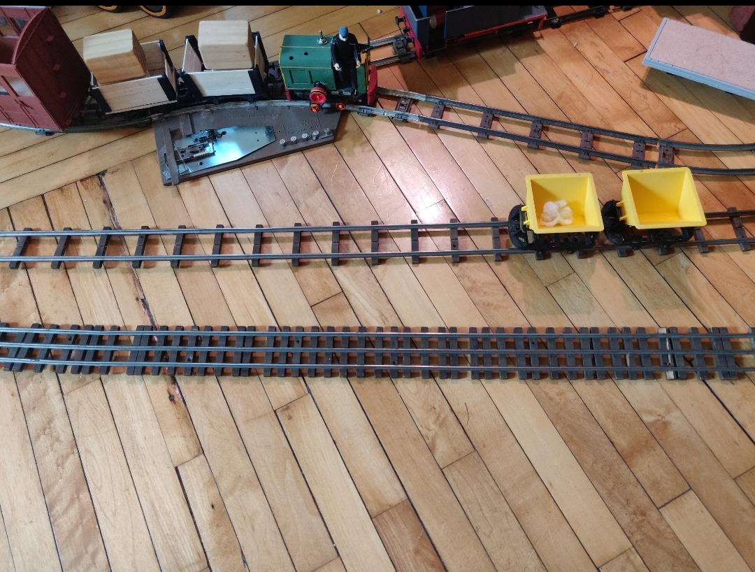

The track is Gargraves tubular stainless O-gauge track, with a few tweaks. I'm removing the center rail and re-spacing the sleepers to a scale 2ft6in on center. Ultimately if the rail holds up I plan to make some cedar sleepers to replace the treated basswood ones, as I have read that they don't hold up very well long-term. Removing the third rail and re-spacing the sleepers also makes the track a lot more flimsy, so I'll need to put some extra work into underlayment. Right now I'm thinking either cedar or concrete block.
Top to bottom: tinplate test track, post-conversion Gargraves track, Gargraves track as received.
NVT loco no. 1 'THORNAS' tests the new track prior to conversion.

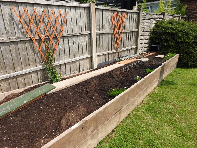

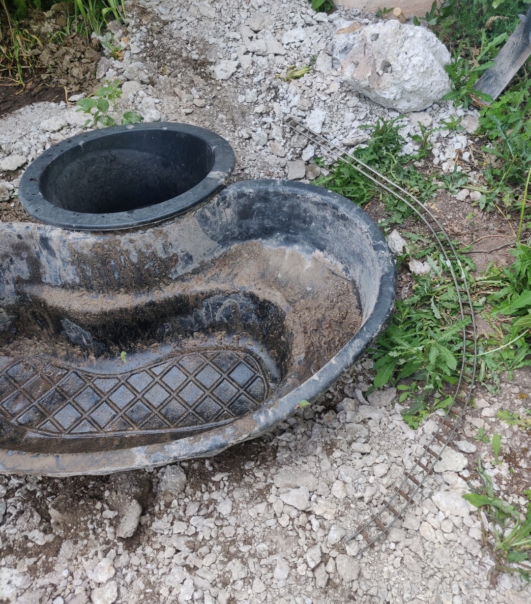

Still working on the exact pond configuration. Today I started laying everything out to get an idea how it'll fit together in the space. Need to smooth out the curves a bit but I was impatient to practice bending the rails. Once I get the layout of everything finalized and approved I'll need to do a bit of plumbing for the filtration, aeration, and waterfall feature, then I can build up the surrounding raised bed and trackbed. I plan to leave a bit more space away from the house for maintenance (thanks to FWLR for the reminder) and to protect the metal siding. I'm also trying to keep enough space between the track and the pond that derailed stock won't instantly go for a swim. (Note to self- build a model of Spooner's boat to test its amphibious capabilities.)
Test fit - for reference purposes only

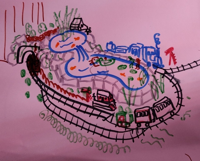

I've been trying to figure out if I can make the elevation make sense to have the round pond overflow with a small waterfall into the jellybean pond, with the track running around just above the level of the jellybean pond. Having the trains running behind and somewhat below the level of the round pond offers the possibility of having them disappear into a mock tunnel, and might help create the illusion that they aren't just going around in a circle.
Early concept art from February. Note that this shows the rails at ground level with the pond elevated, contrary to more recent plans. Drawn to entertain a three-year-old and not to scale.
I'm not 100% set on the two ponds thing, but I have two pond liners so I might as well give it a try. I've tested the idea on a smaller scale with one of my aquariums; using a sponge intake on an air uplift tube to pump water to an upper chamber and create a small waterfall, the effect is achieved and the water stays clean. Scaling it up will be the real test, though.

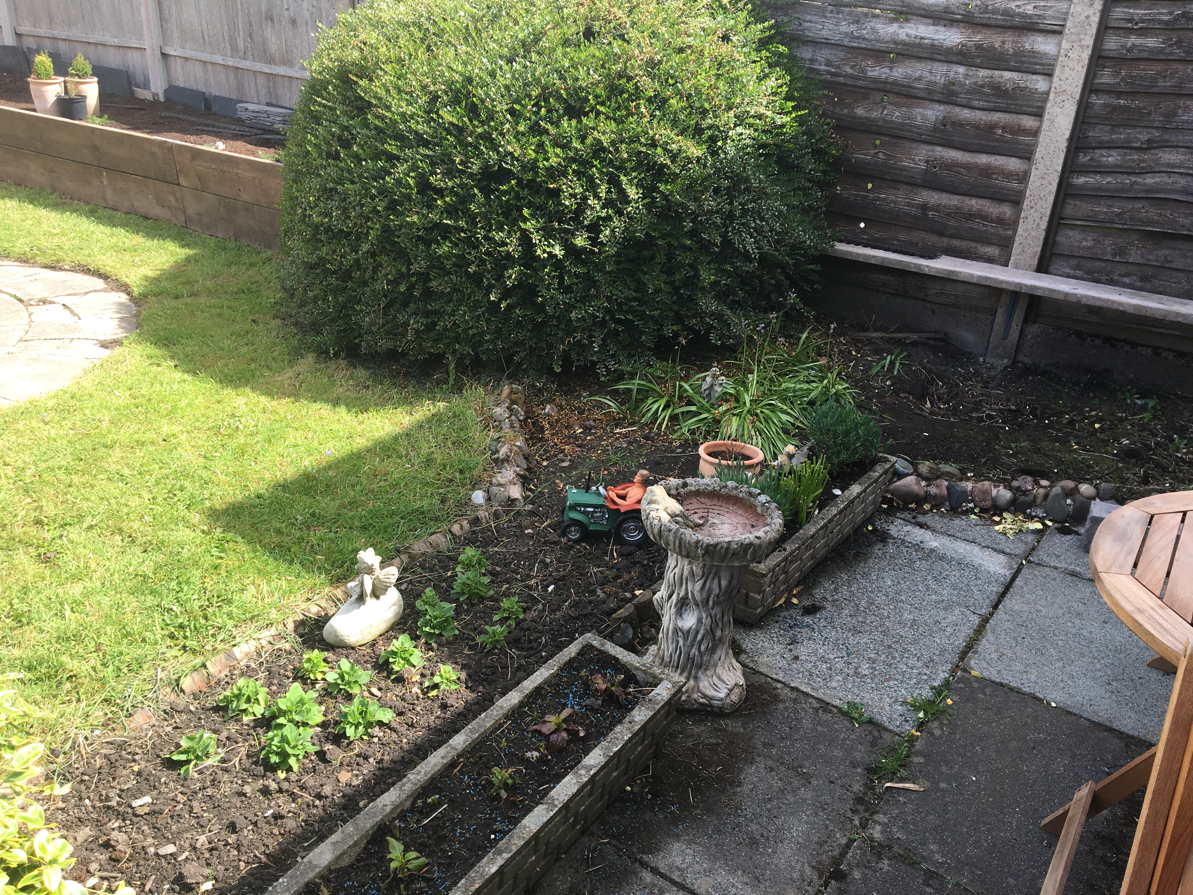

Rod thanks for those photos, I needed a something to show the domestic management an idea of what I have been thinking about for the first corner I need to negotiate on my line, thanks.

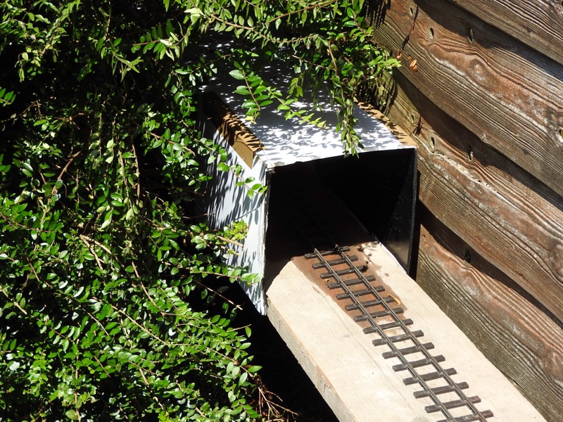

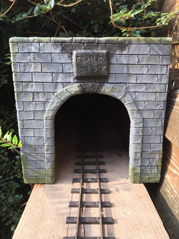

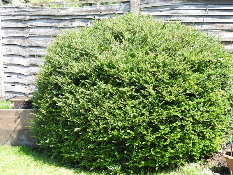

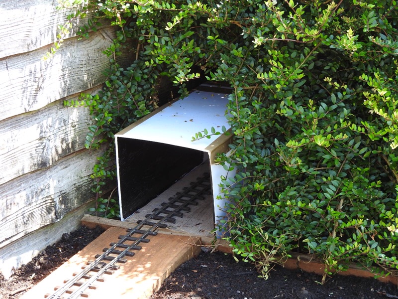

It's not a big problem with the tunnel Drew, we had one that was over 8ft long on our old line before we moved.
These are some photos of the tunnel which we struggled getting through the bush. :lol: :lol:
You wouldn't believe how big that bush was..... :lol I built the tunnel from OSB board that I then put two coats of lacquer on it. On the ends that were showing out of the bush I also painted with gloss paint and the inside with waterproof bathroom and kitchen emulsion paint.It was then fixed to a 4m/13.12 ft scaffold board, which in its self was heavy enough. Anne was so helpful I can tell you....We even took it to our new home and the board is now in part carrying the line to the bridge and you can see the scaffold board also, but that is going to be replaced with some sleepers eventually. The line was so straight there was no derailment and when the bush had grown over the ends of the tunnel it looked even better.

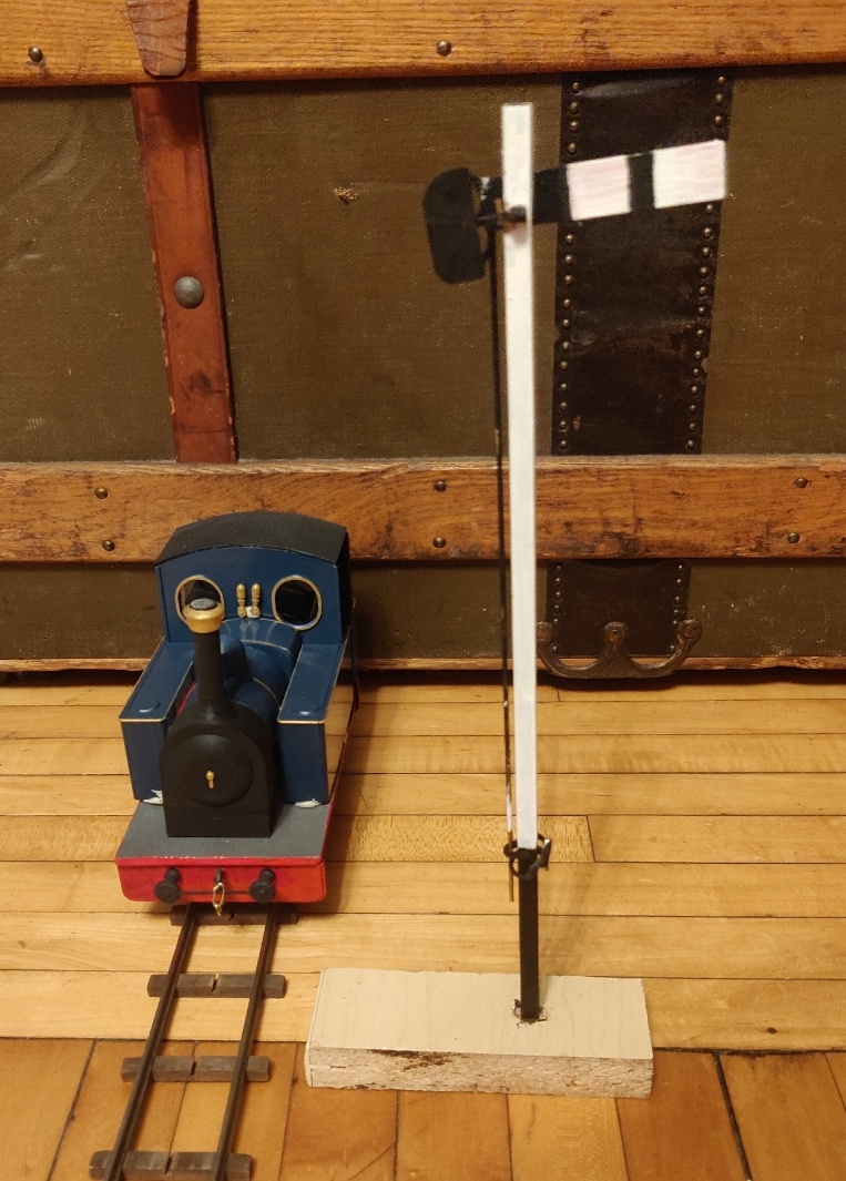

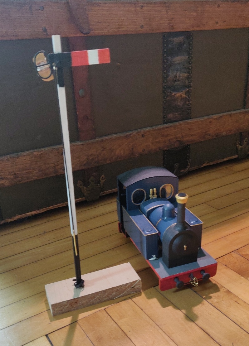

While the railway waits for some other yard/garden projects to catch up, I got the idea into my head that my small single-track loop couldn't possibly be complete without a signal. Following (and deviating slightly from) Rik's excellent guide on the subject, I produced this:
Hm, seems a bit off.
And then promptly realized I'd built it for the American side of the tracks. A quick brush with the soldering iron and a lick of paint later, I had corrected the issue.
I took a bit of a shortcut in using brass square tubing instead of tapered wood for the shaft. My three-year-old has informed me that "it's pretty good, but you need to make a ladder and a light and red and green." Kid knows his signals!
The remainder of the parts (ladder, throw lever, lamp and bracket, finial) will be a combination of 3d printed and brass parts. I guess I just needed to run out of filament for a while to remember that I can still model things the "old-fashioned" way!
