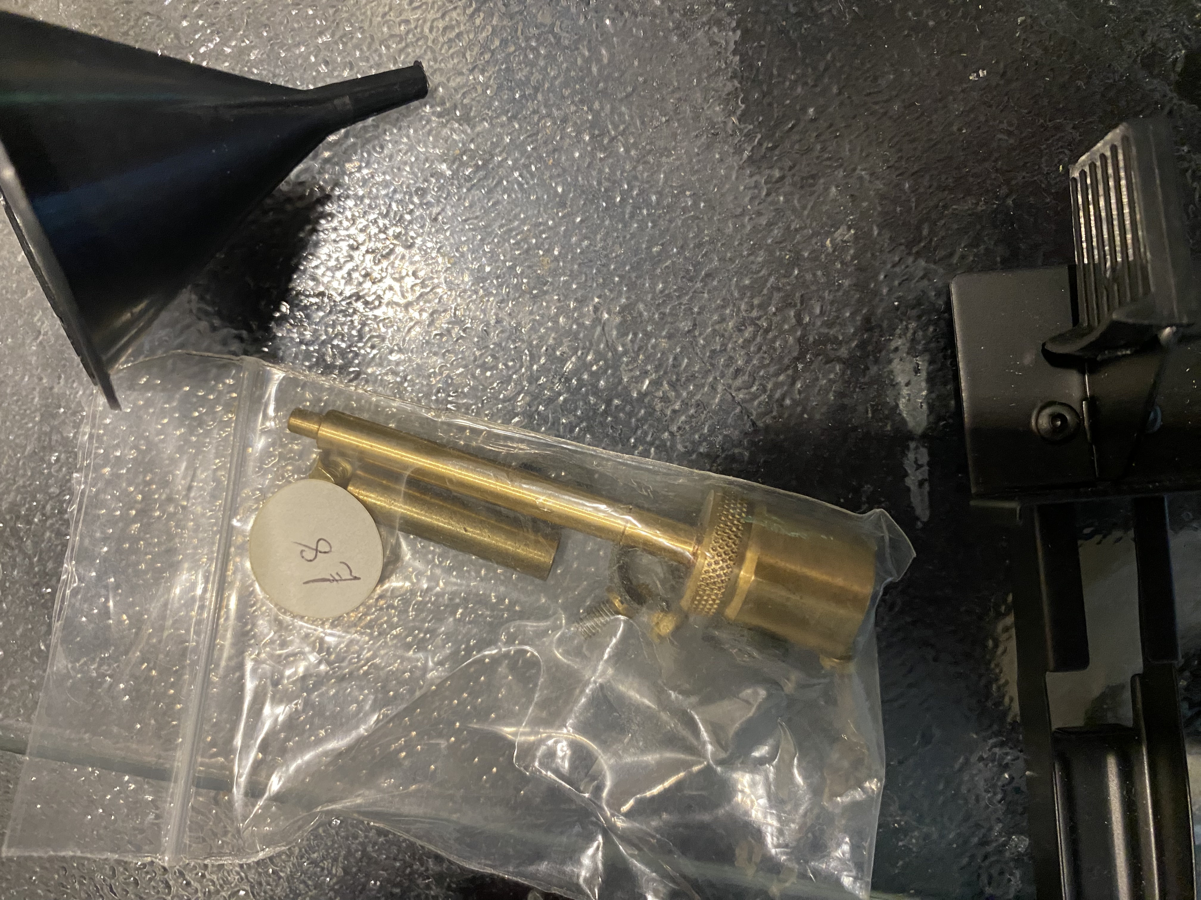

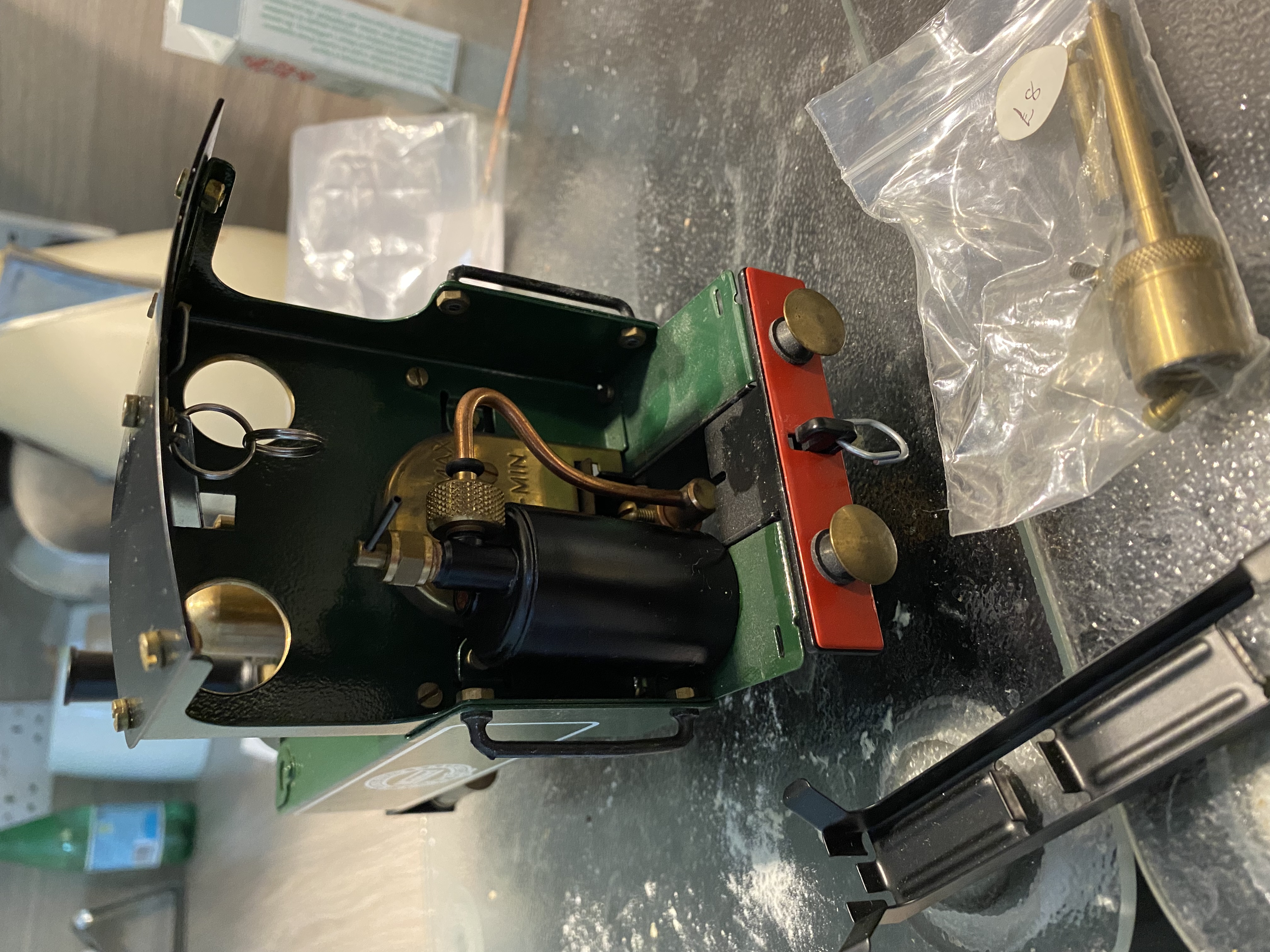

I just acquired this lovely SL1K… first live steam loco.
I then realised I couldn’t put the burner tray in, owing to the cylinder thing being in the way.
I’m totally new to this… but I’m assuming this is a gas conversion?
There was also the brass attachment you see in the clear bag.
Thoughts welcome! I have no idea what I’m doing!

Hello!
Looks good to me!
Yes, the cylinder's a gas tank, with the handle on the top to regulate the flow, ie how much gas you're burning and so, in turn, how much steam you make. It looks like a small-ish tank, probably designed so that the gas runs out before the water, so you don't run the boiler dry. I wouldn't want to put that to the test, although it does look like you've possibly got a replacement boiler on there too, which will cope better with running dry than the original.
The brass fitting in the bag looks like an adapter. One end should fit over the filler valve on the gas tank, the other should screw onto a can of butane, the sort they sell in DIY shops to power blow lamps. Taymar (?) is a brand that seems to be readily available and that it often used for live steam models.
There are far greater experts on here than me, but do shout if you want further advice, between us I'm sure we can help!
Looks good to me!

Re: What on earth have I bought?
Thanks so much Andrew!
Between yesterday and today I managed to find more info online too.
The issue I have now is there's no hole in the cab roof to insert the filler attachment/adapter!
But oddly, I moved the regulator and gas flowed through! So it has been filled at some point?
I'm wondering if I need to drill a hole in the roof, or whether there's some sort of further attachment that would let me fill the tank some other way? Very odd!

If it was mine I'd be reluctant to start drilling holes, but thats up to youashover wrote: Thu Jun 08, 2023 9:04 am
I know that some people do use very strong rare earth magnets to attach roof's etc, so that might be an option.

Believe me I’m very reluctant to start drilling holes
Removing the roof sounds like a plan!
For running, do you reckon you’d open up the gas regulator fully then control with the regulator on the front of the engine, or the other way around? I guess I’ll just have to have a play!
Nicholas J
The gas tank/burner assembly doesn't lift out, in a kind of "lift up and pull; back" motion, does it? I had one that did, but it was a very long time ago!
I'd probably have the gas up high to raise steam, then turn it down to achieve a balance (or as close as I could get to one!) between making enough steam and the safety valve not blowing off - because that's just a waste of steam/water/gas. How much steam (and so gas) you need will depend on what you're asking of the loco, so a heavy train or steep gradients will need more.
I'd control the loco itself with the regulator lever on the front - it'll take practice though, Mamods re tricky, don't get disheartened!

This steam railway lark definitely shows shortcomings in the grey matter in my case! Yup- I was able to remove the gas cylinder
Problem solved!
I heard they're a bit temperamental yes. The plan is to sell it, I think. But I'll have a play first.
Thanks for the help Andrew!
