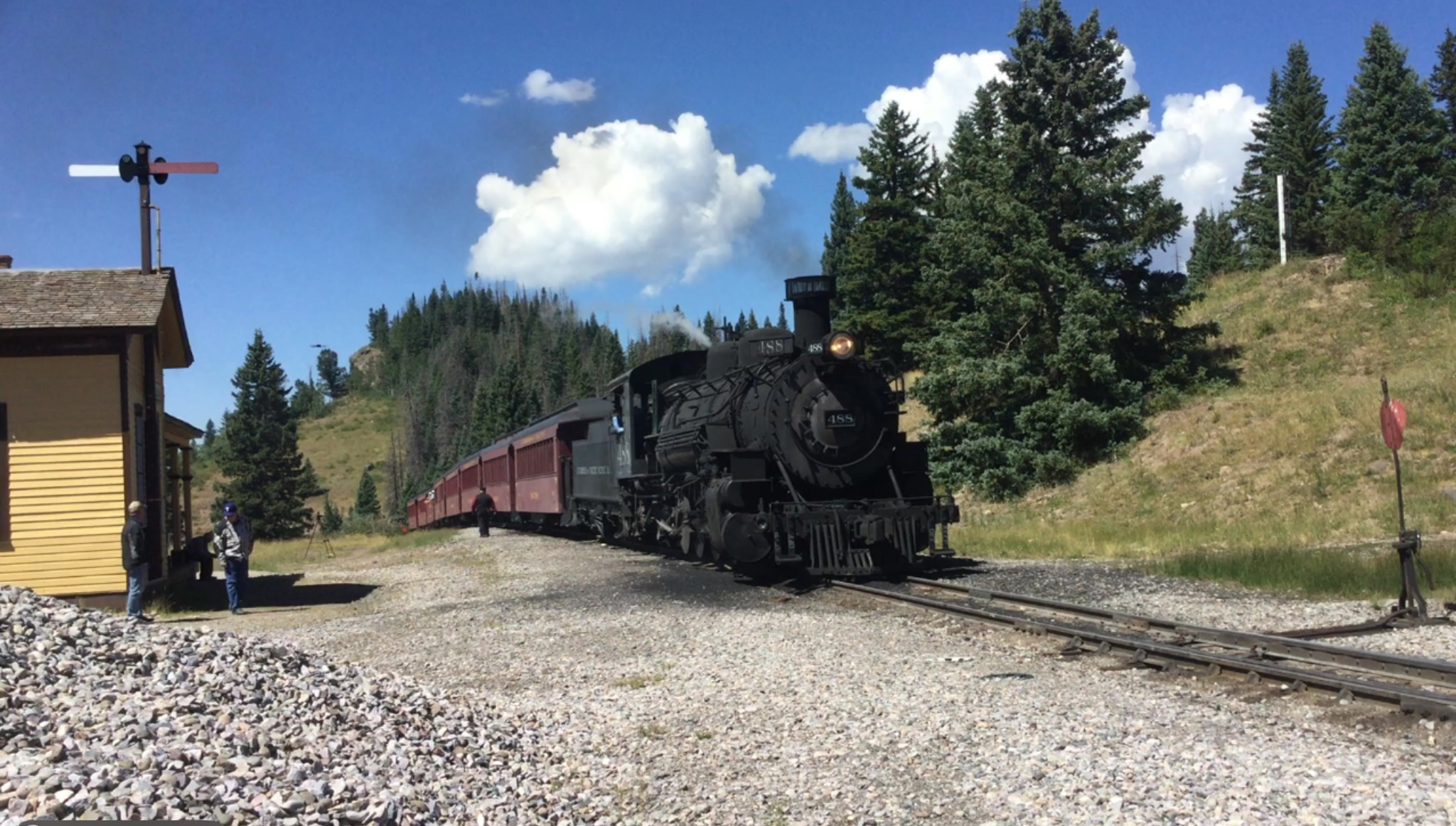

Recently, I visited a 3-foot gauge railway in America. The tracks looked very small and I was surprised how delicate they looked compared to how my model loco looks sitting on its (in scale) even narrower tracks. But then I realized it's because the American locos are enormous. Of course the three foot gauge track looks "narrow". But "Billy" on the other hand, if she existed in real life, would be a very small engine, so on her 2'8" tracks look quite broad in comparison.

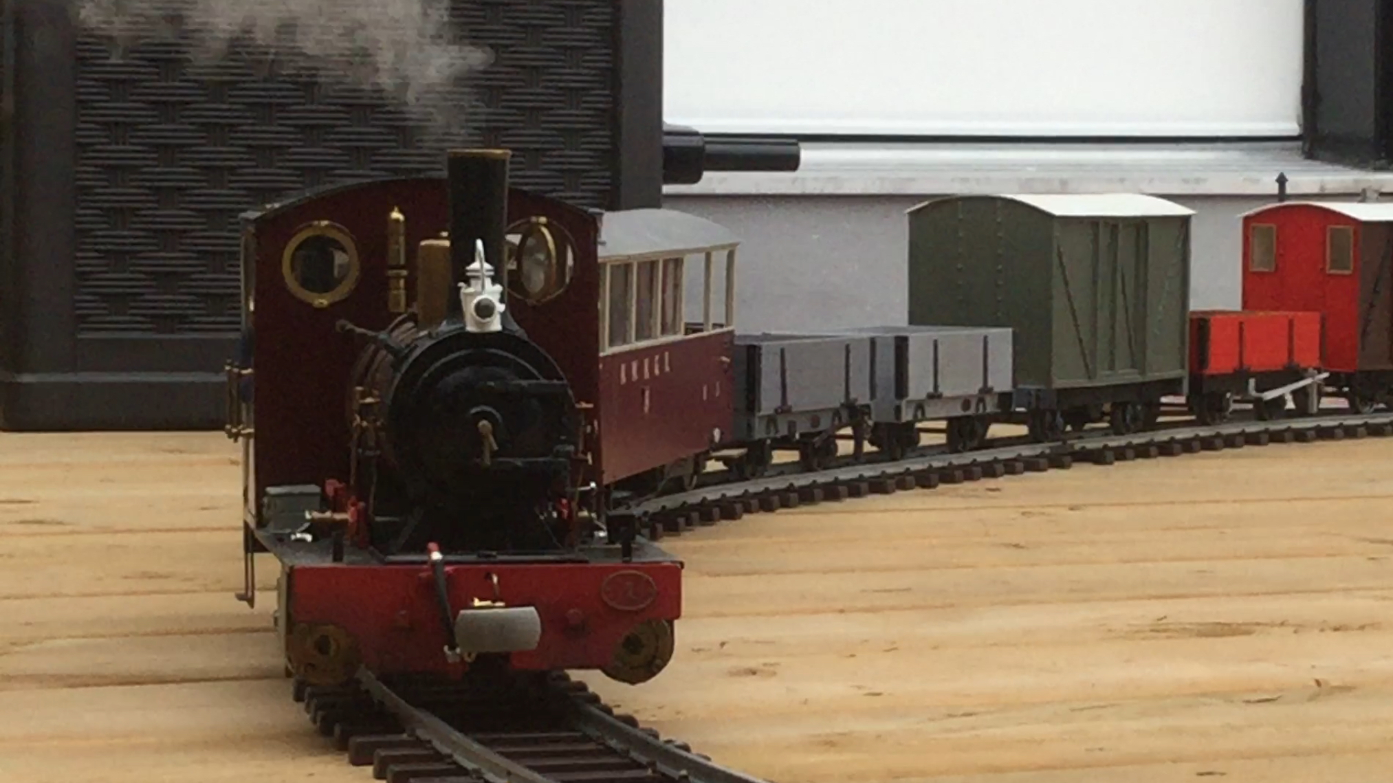

small British 16mm scale locomotive on 2'9" track It's always bugged me, just a little. Harri at Roundhouse told me when bought the loco kits that 45mm was more common in Canada, and I'd find it easier to visit other lines. But here's the catch: there ARE no other lines anywhere near where I live, and in fact I don't even have a permanent line. So "visiting" has never happened. In fact I've visited more 32mm lines in England (without my engine though) than I have here.
If I were to start over, I would do 32mm. HOWEVER...
The "Sunset Valley" tracks I got from America are actually fairly delicate-looking, as in they use a very light-code aluminium rail and widely spaced sleepers. I think the Yanks use it to model three-foot gauge in 1:20 scale, or something. It's not as terrible-looking as LGB tracks for 16mm scale, anyway.
Big American 1:1 locomotive on 36" track Also, out of all my rolling stock I am the most fond of my "Zecar" momentum wagon, and it is not regaugeable. My "Gladstone" coach could just get new bogies, and well I guess it would be pretty easy to do the rest of my IP engineering and Brandbright wagons with new wheels and axles.
I really ought to do it. I like 32mm better, because the 16mm scale locomotives are so small the 45mm track doesn't look very "narrow" no matter how hard you squint. But christ I just spent all that time building scale brake-rigging on many of my vehicles... I'd have to wipe it all out and start again. Maybe I will keep some of both, and when I get a permanent line I can build it in 32mm gauge and keep the old 45mm wagons in case I ever really do go "visiting".
Anyway it's a lot to think about, and I really only have two bogie carriages, one four-wheeler, a guards van, three open wagons and a box van with a zecar inside. I could convert it all in a week.
