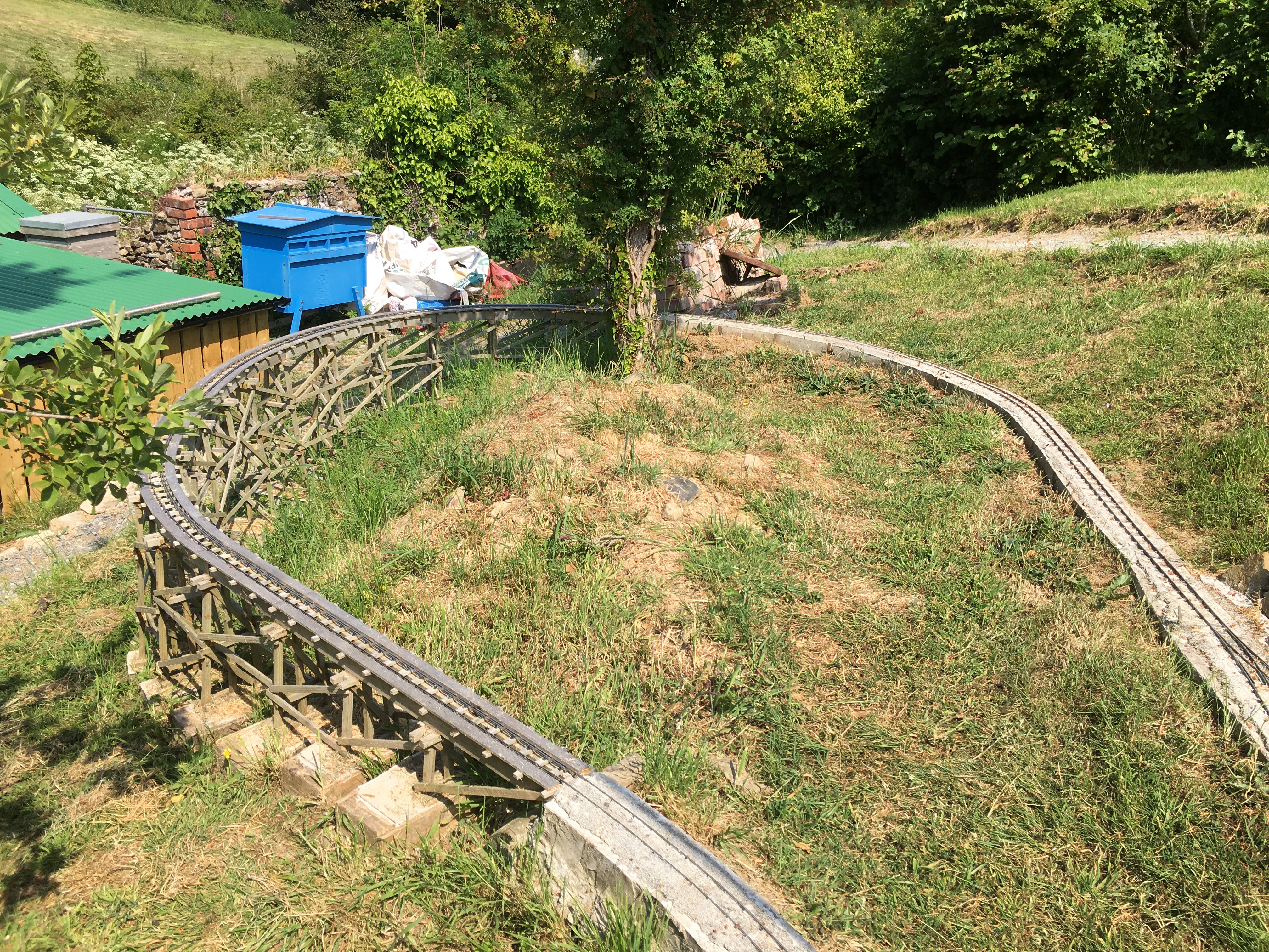

Yes the camera does foreshorten the distance - it's actually 62 feet. A ridiculous thing to try to dig out by hand. However when I look back at what I dug out during lockdowns I am convinced that it is worth attempting. Phil is also correct in saying that as I dig it out it gets worse as the land does rise.
Of course the real reason for doing it is to provide proper access to the back of the raised beds, but at least there is the motivation of creating more railway which I hope will keep me going.

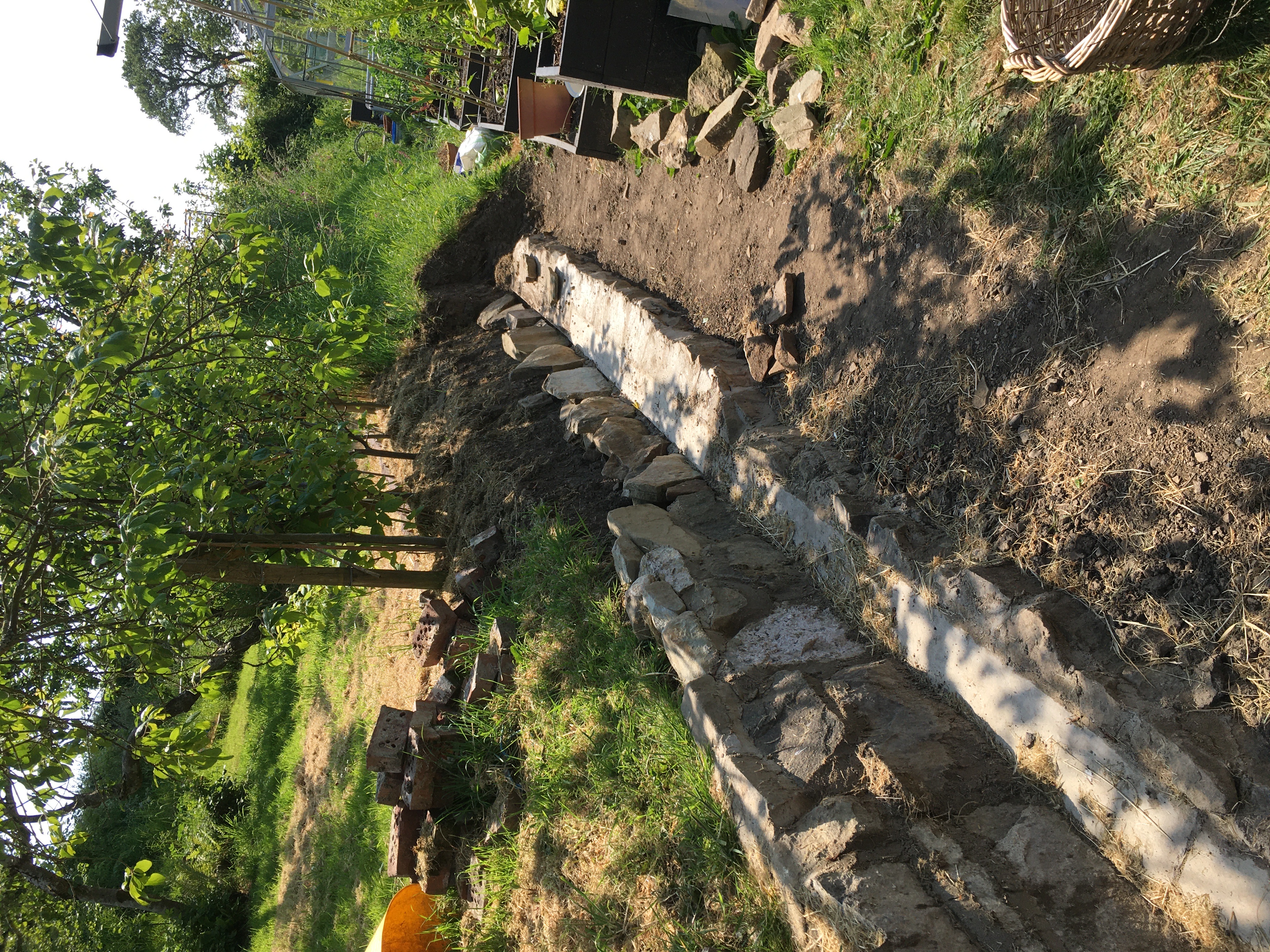

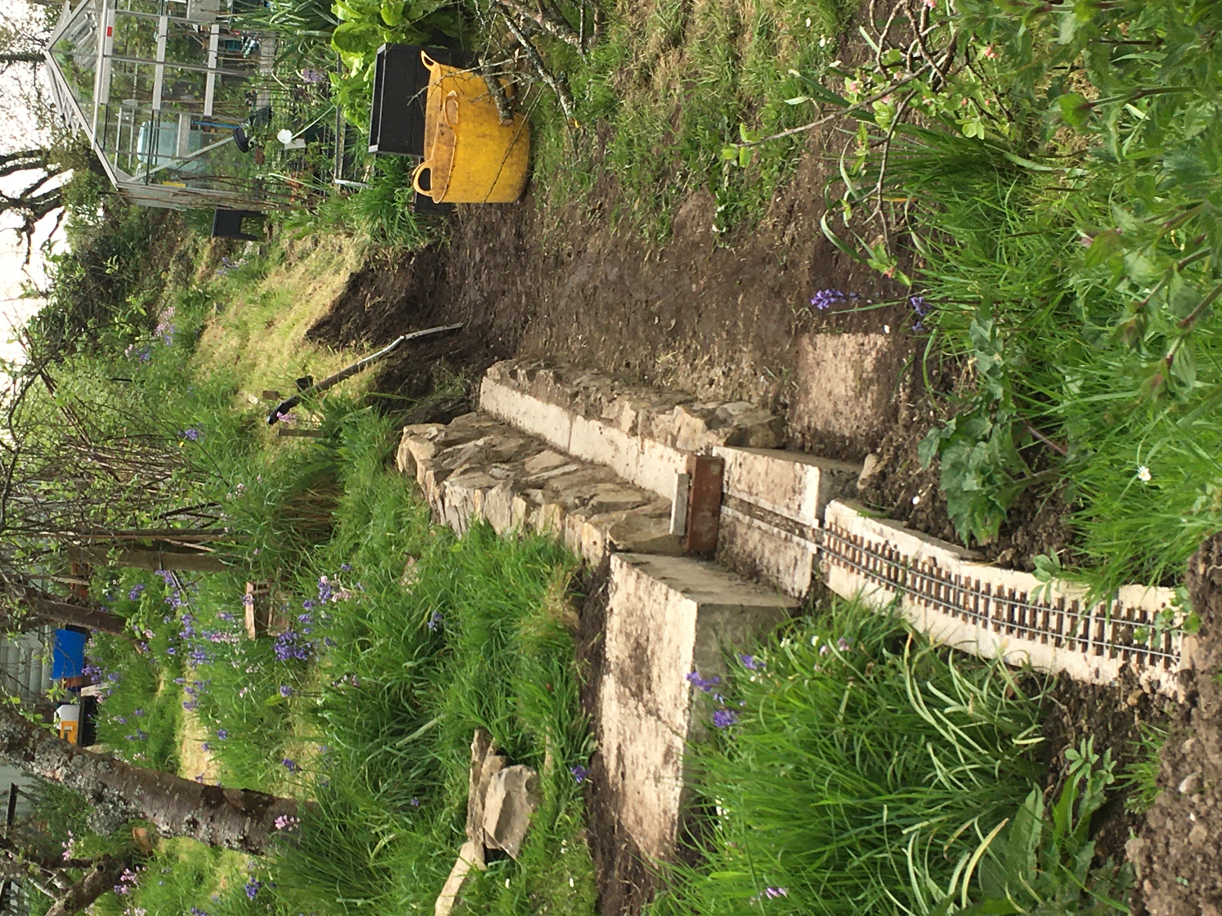

Post by Trevor Thompson » Sat May 06, 2023 1:21 pm
The first section of wall - and track bed - is complete, and I have started to dig out the second section:
The camera foreshortens the distance. Each of the concrete gravel boards for the track are 6 ft long - which makes that short section of wall 12 ft long.
It is a bit of effort - but I am on schedule!

Post by DonW » Sat May 06, 2023 8:31 pm
Impressive stuff. How much have you climbed so far ? Any idea of the ruling gradient?
Don
Posts: 1157
Location: South West Wales
Post by Trevor Thompson » Sat May 06, 2023 11:05 pm
Don
Yes I have tried to make the line 1 in 60 as far as I can, with the curve on the viaduct at 1 in 80. However I am currently working at 1 to 50.
I had hoped that the current gradient would take me to somewhere around waist height when I got to the greenhouse. I actually did a bit of "surveying" a couple of weeks ago and It is a pity that I didn't get the level and the long tape out earlier.
I now know that the land rises at 1 in 60 from that last set of steps to the back of the greenhouse. So as fast as I am trying to lift the trackbed, the land is rising in parallel with my progress. Instead of the terminus station being at waist height, it is going to be nearer knee height (I hope!!!). It could have been worse - at least I am not digging the Bakerloo line.
I haven't measured exactly how far the line has climbed so far but it must be about 2 metres.

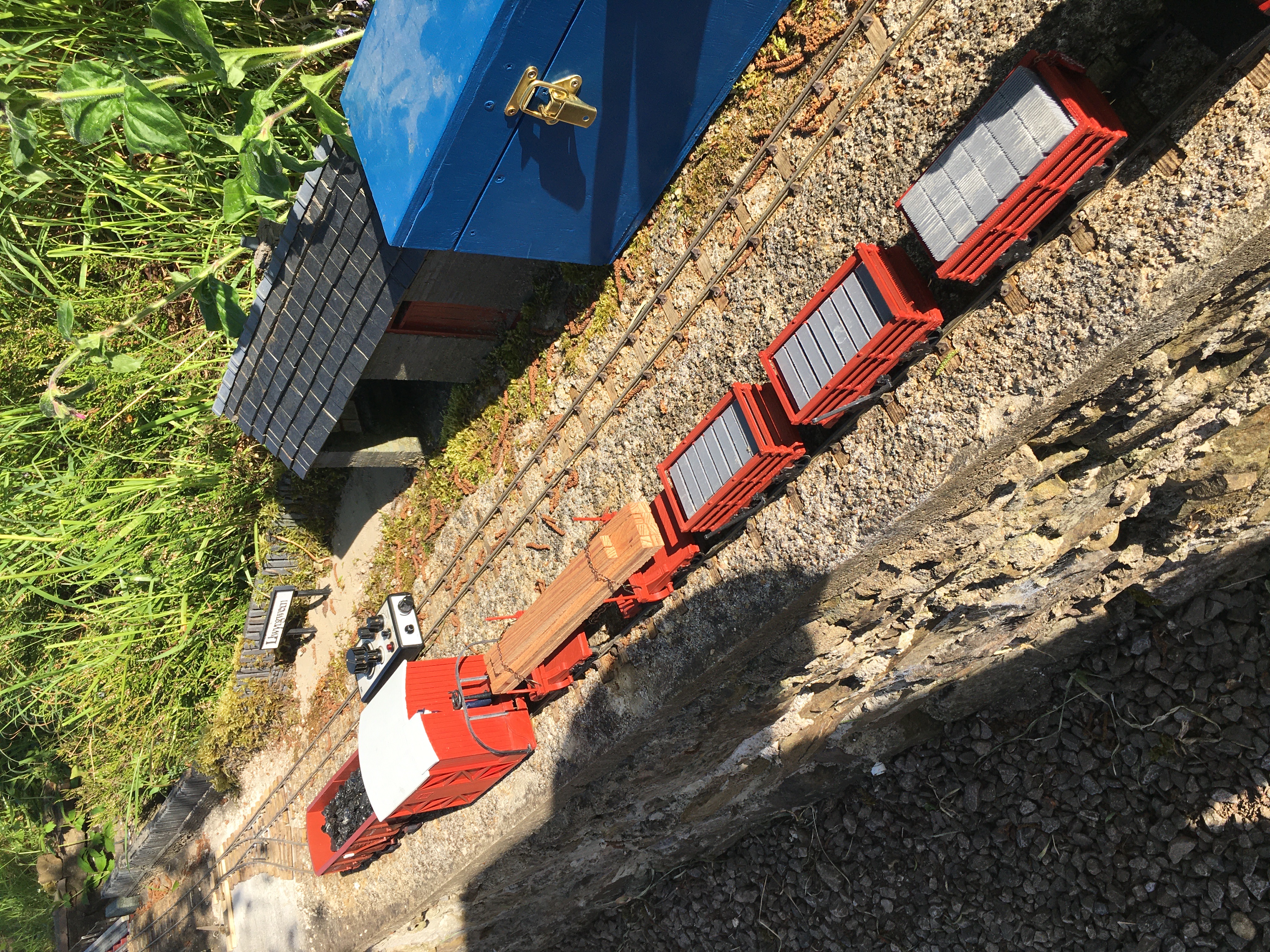

Post by Trevor Thompson » Wed May 24, 2023 9:58 am

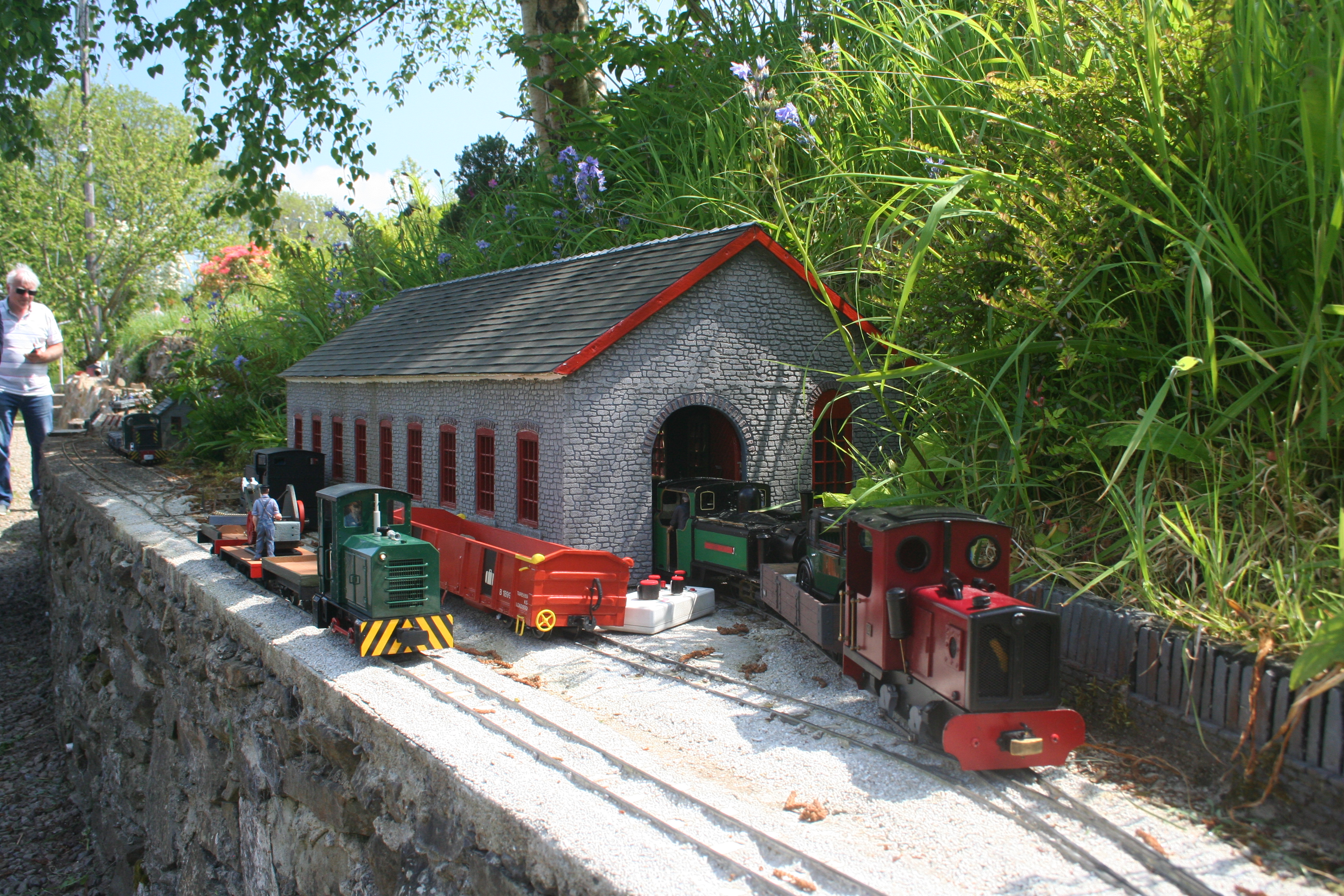

An unexpected advantageous by product of running an area group meeting on the railway last Saturday has been the identification of a number of issues with the track.
I had never quite been sure if an occasional derailment was caused by the track or the derailed vehicle.
I came away with a short list of things to fix!

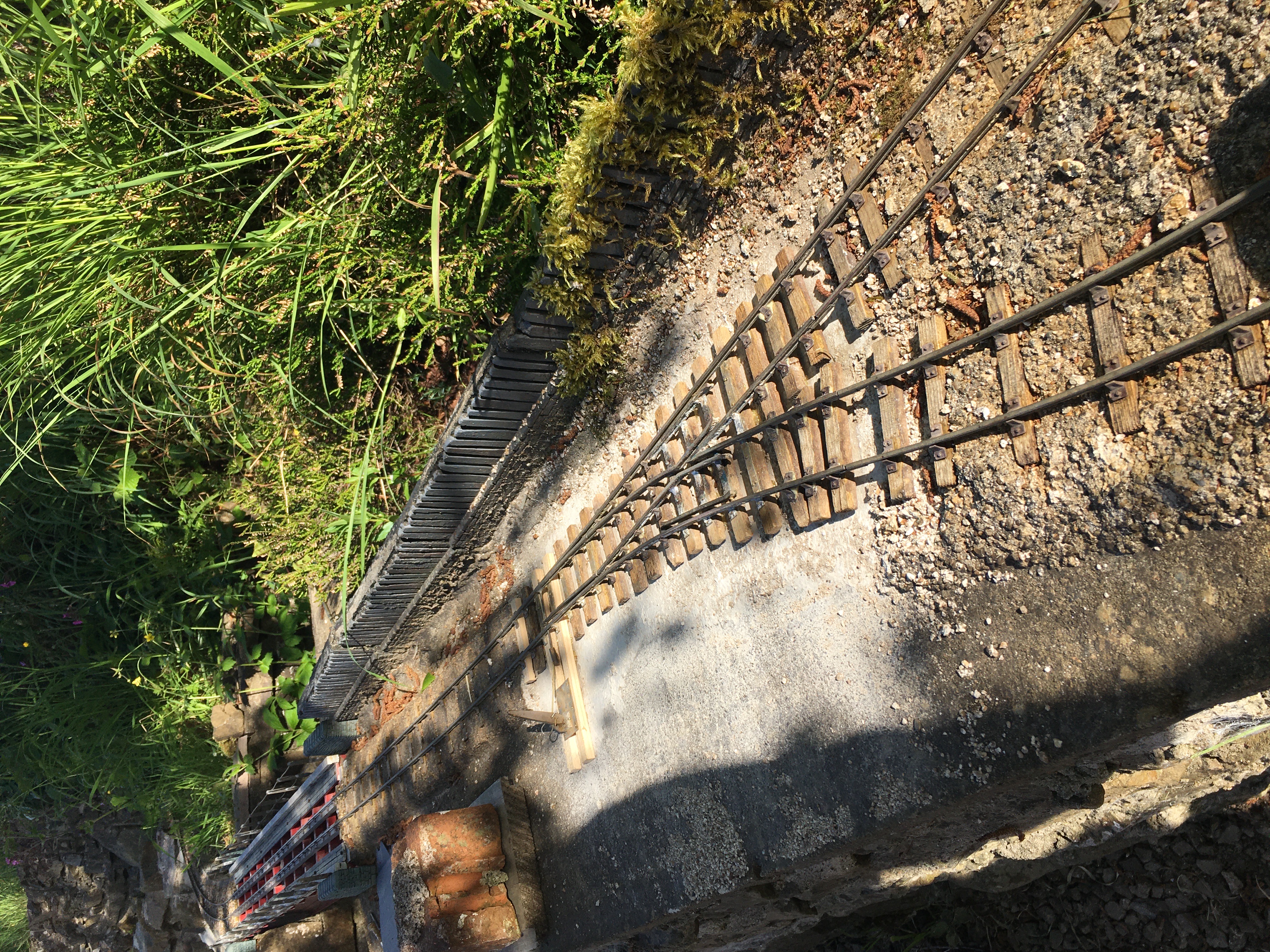

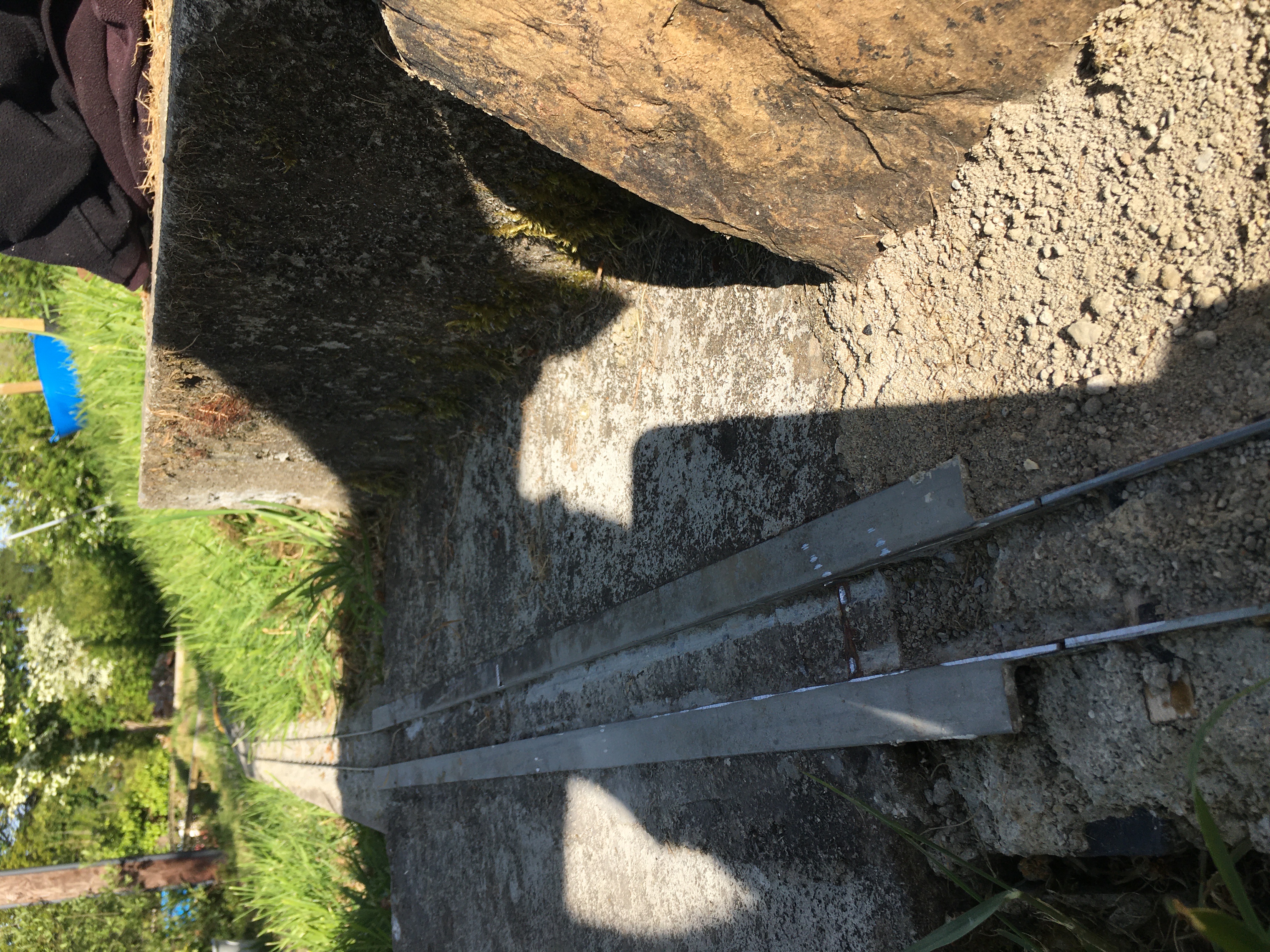

Post by Trevor Thompson » Wed May 24, 2023 10:20 am
Firstly one of the first set of points I made (10 years ago?) was a problem. The frog was lower than the wing rails - and the gap between them was too narrow. The chairs which have a pin fitting into a hole in the wooden sleepers were coming out of the holes as well. Most things seemed to cope with it but not everything. So I removed it and rebuilt it:
It just needs ballasting when we get some damper weather.
The curved 3 way point at Tan - y - Bwlch also caused derailments. The outer set of point blades were too high at their inner end where they pivot. It was just ballast stuck under the rail where it moves causing it to rise a mm above the rail level - enough to cause some things to derail when going downhill (particularly my Cleminson 6 wheel coal wagon). Easily fixed:
One of the path crossings where the track is actually stainless angle set into the concrete turned out to have the angles set too close together at one end. 31.5mm apart instead of 32mm apart. Perhaps the more significant problem was that this led to the fish plates narrowing the gap even further, where my attempt to create the rail profile had not been quite good enough. Fixed with some judicious grinding of the angle and then very gently on the fishplates:
And finally a test train consisting of all those things which seem to like derailing. The Cleminson 6 wheeler, the bolster wagons, a brake van and some slate wagons for the sake of it:
And it all ran up to the head of rail and back without anything coming off! Very pleasing.
There is one point left (the first I made) which I will also rebuild - but not today.

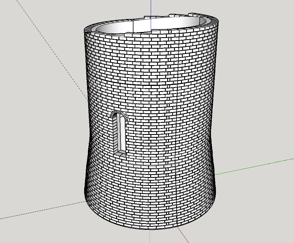

So the keep of the castle is designed and I have started to print it:
Screenshot 2023-06-08 at 15.36.54.png (119.09 KiB) Viewed 8823 times
The tower is about 300mm diameter at the base. You can see that the bottom section is "battered" (it is tapered - to a smaller diameter at the top). So that is printed in 4 parts - 1/4 at a time. The middle Layer has three identical parts and one unique section which has the door in it. The top layer is again in 4 parts, but only two are the same (mirror images of each other), and the other 2 are different - on higher and one lower. That top section is intended to look as though the mortar has decayed and stones have fallen off.
Another big building - each of the bottom tapered layers are taking 24 hours to print. Updates as this progresses.

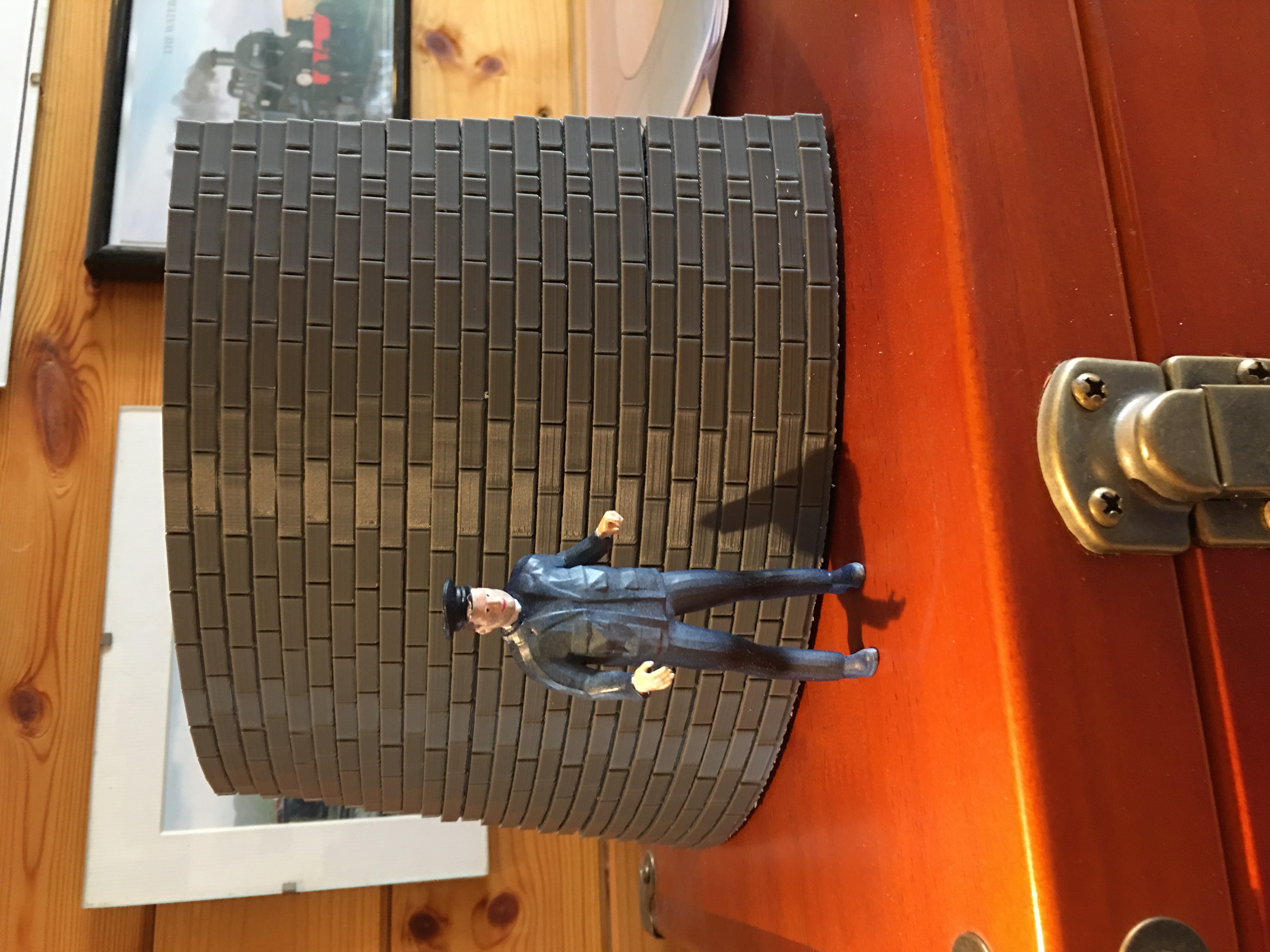

The castle building is progressing:
The first section of the battered base.
Two sections printed and roughly in position to give an impression of how this will look. Bearing in mind that the tower will be at least twice as high as this it is going to be an imposing building - and that I suppose is part of the role of a castle - to dominate. However in scale terms it is quite a small structure as castles keeps go.
As an aside for anyone contemplating printing in ABS. We are enjoying a stretch of extremely hot weather here in the UK at the moment. Before printing the first section I took all of the insulation off the printer - thinking that it would be over 30 degrees in the workshop, and it wouldn't need the insulation to keep the print chamber hot. That first section came out with one significant crack and a few minor splits. Nothing which made it unusable but it needed repairing. I put the insulation back on before printing the second section. There were no cracks or splits in that. The moral of this is that the print needs to be kept hot - its the premature cooling which causes ABS to be so difficult to print with.

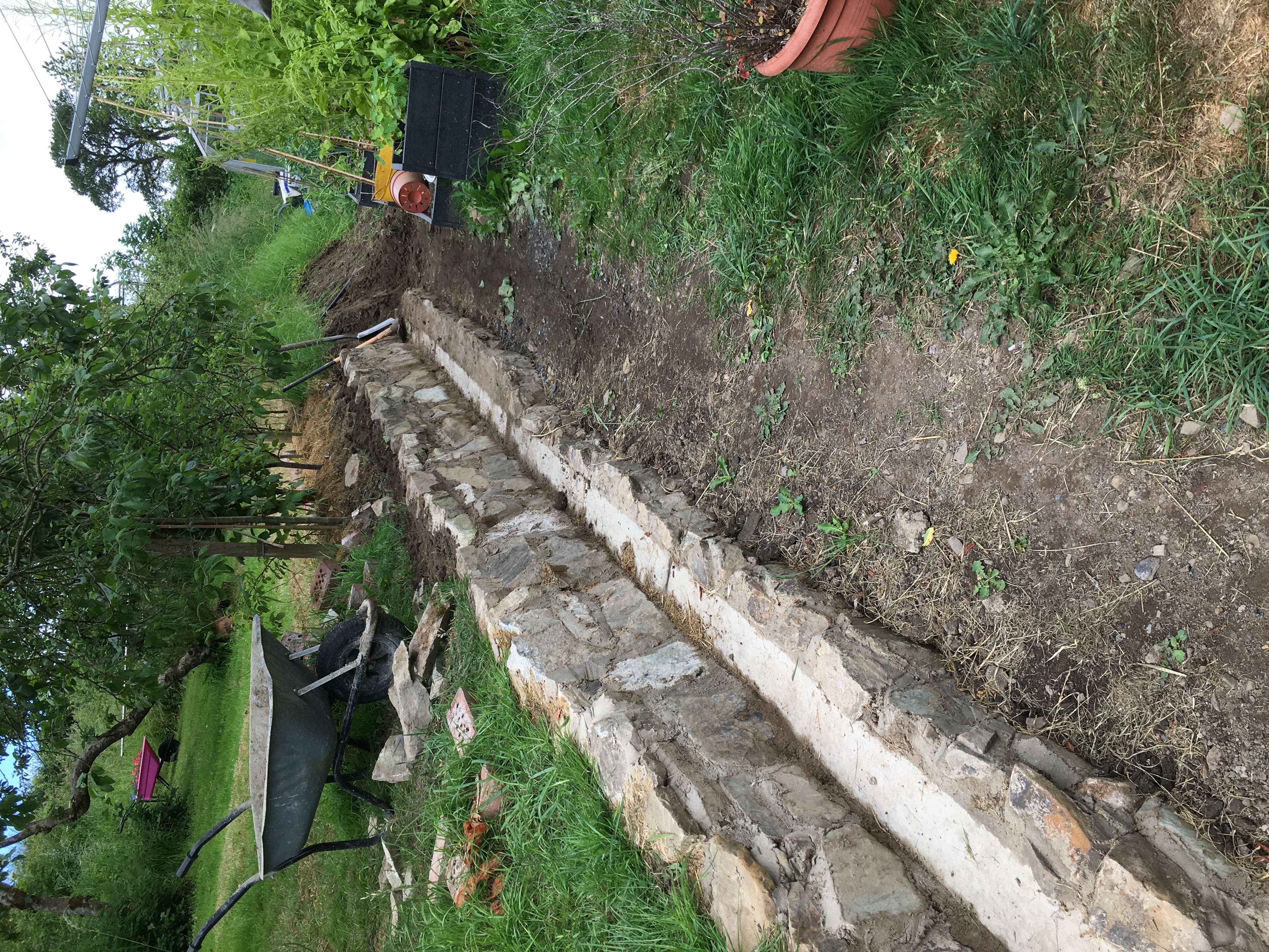

The second section of retaining wall is now completed, and digging out for the third section started:
When the third section is complete I can start to make track again to take the railhead to the new passing place in the second section of wall.
