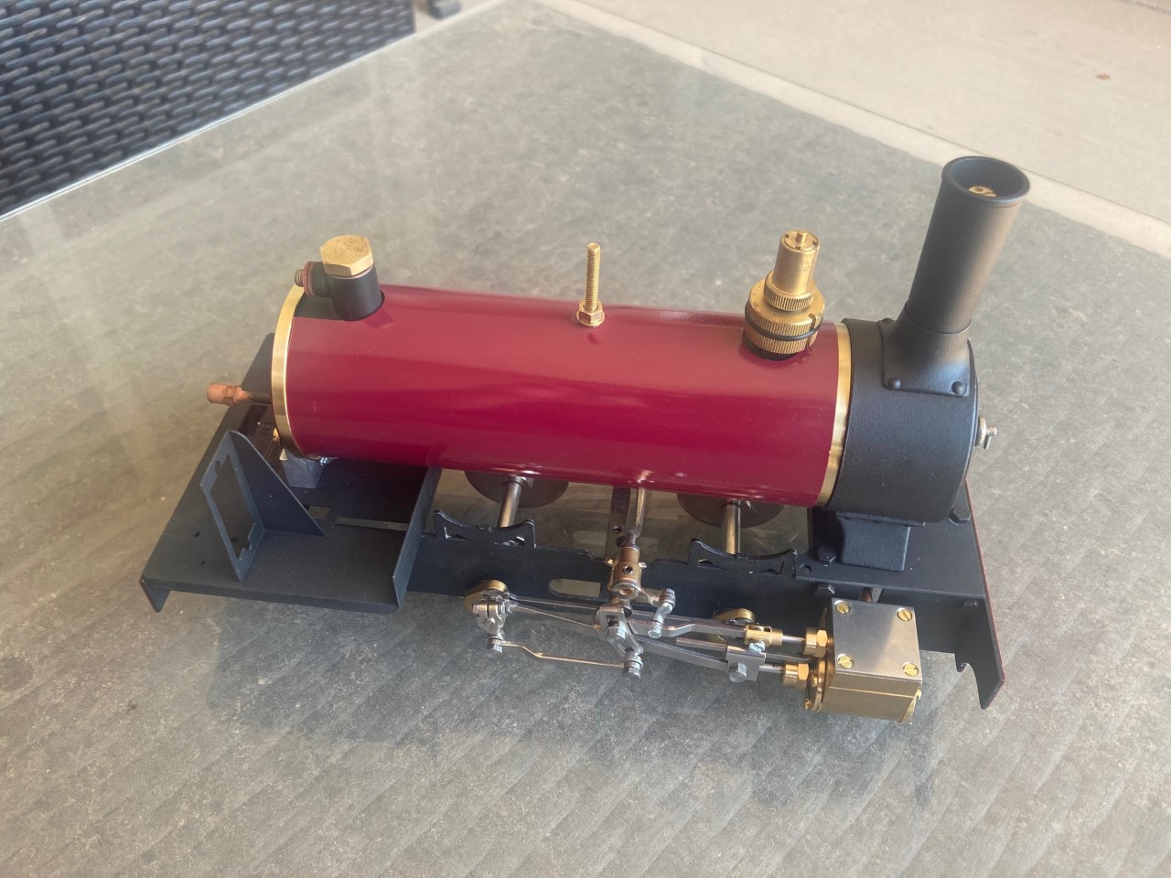

Boiler wrapper painted. I'm a bit disappointed in the colour (it's a lot more pink than I'd anticipated) but it will have to do.
The finish is ok but not great, so I've ordered some polishing compounds to try to buff it up a bit.

What kind of paint did you use? I'm just asking because if it's enamel you can pop it in the oven at a low temperature and the paint will harden and darken slightly. Come to think of it, you could do that anyway. If the paint won't withstand 180f in the oven, it won't last long under steam either. If you like I can post before-and-after pictures from when I did that. It might help make your paint colour the way you were expecting. Although I must say in your pictures the colour and finish look pretty good to me.

The boiler wrapper is primed with U-POL 8 acid etch primer and top coated with Scalecoat 1 solvent based enamel.
All parts have been baked at 200F for 30 minutes.
The colour is Erie Lackawanna Maroon and, in hindsight, I think the colour may be reasonably accurate. I was intending to go for something a bit darker but hopefully it will be ok once it is all finished and assembled.

One thing I've noticed with red enamels is that they tend to darken a little in the months after painting. The oven might've sped that up in your case, but only time will tell for sure. Incidentally, I've also had a rather cool dark green become "warmer" in tone over a few weeks curing.
Nice tidy work in any case!

Well I think it's a nice colour, anyway. There is (was?) a brand in Canada called "Tremclad" that was marketed as a "rust paint". They came out with a line of "designer" colours and I chose the "Wild Raspberry" colour for my locomotive, because it was similar to the "Victorian Maroon" colour that Roundhouse uses. Then, I thought, why not paint my "Brandbright" passenger coaches the same colour? Well I built one of the Brandbright coaches, but that coach took me a long time to build and I haven't built the other two, and since then Tremclad has ceased making that colour, and so now I mustn't damage my locomotive because it will be very difficult to find matching paint. Also my remaining coaches will be a different colour when I build them, which is irritating.
As for the paint, it was actually kind of unsuitable until I baked it in the oven. You can't tell unless you lift the dome off, but the first time I steamed the engine, the paint softened and the dome sank into it. Obviously this isn't visible when the dome is on, but happily after baking the whole thing got a lot nicer looking anyway.
Well, regardless I think you'll end up liking the colour. The locomotive will look a lot different once it's assembled anyway, for the better.
Here is the colour change I noticed on mine.The fresh paint was lighter and thicker looking than I had expected, but after baking it became harder and the texture changed from a superficial gloss to a real enamel look. The two pictures are also about ten years apart. The paint you used is likely a much higher quality than mine, as well.

Thanks for your photos.
The colour has grown on me and I think it looks pretty good now
I had a few problems with the painting as, although I've done quite a bit before with spray cans, it's my first real go at using a proper airbrush. This morning the boiler wrapper was looking ok. I thought I'd just run one finish coat over it and I'd be done. However, the airbrush started 'spurting' and then the boiler wrapper fell off the hook that it was hanging on
Fortunately it didn't ruin the finish, although I had to do a bit of finishing and polishing to get it where it is now. It looks a little better in the photo than it does in real life but it's good enough.
It turns out the problem I was having with the airbrush was 'tip dry', where the paint dries around the needle. I might need to put one more coat on the body, and I've got a few things I can try to reduce the chances of that happening.
Now I can finally continue with the gas/regulator and then RC assembly
