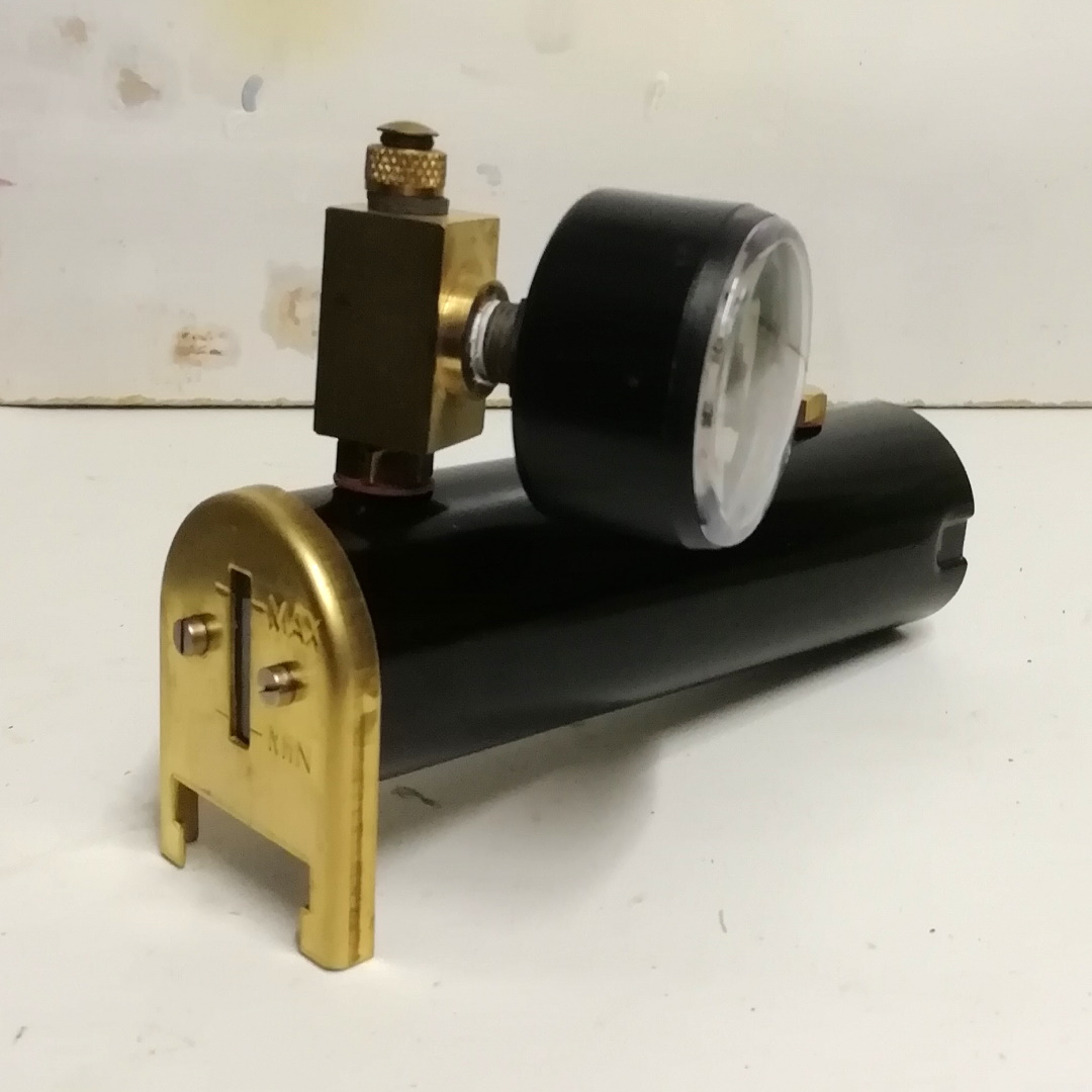

I managed an hour or so working on the loco at the weekend. The new boiler needs its sight glass and back plate installed so I thought it might be a good idea to make a Goodall valve so that I can cold pressure test with just water before trying under steam. I've turned up the valve from 1/4 brass bolt and have an odd bit of normal rubber tube for the cold test but need some silicone stuff for a hot one.

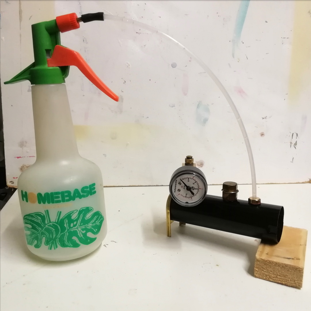

Tried a cold pressure test with the new boiler filled to the top with water and my adapted garden spray bottle. No leaks from the sight glass so the next test will be under steam.

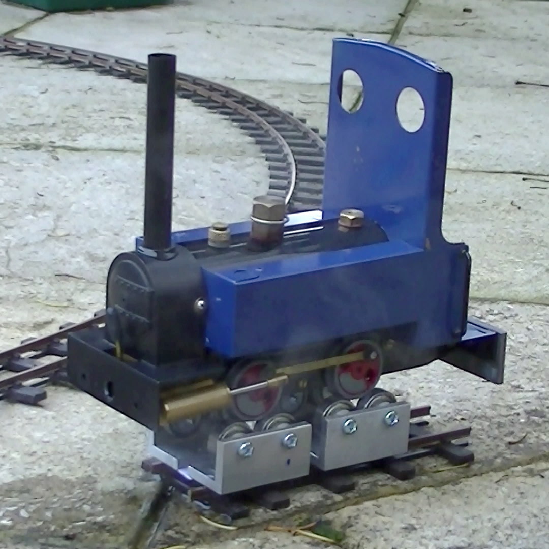

To bring things up to date I finally got the locomotive running on a loop of track in the garden. Initially there were issues with steam leaks which were resolved by lapping the steam valve faces and fitting a stronger spring. Next task is to sort out a lubricator and improve the speed control with either a steam valve or exhaust throttle.

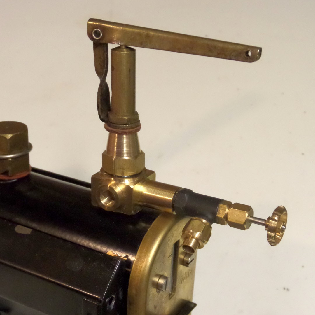

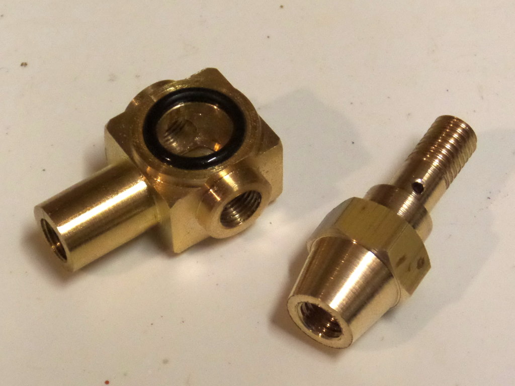

I decided to make a steam turret to go in the rearmost boiler ferrule to provide 4 connections. An extended connection to the cab regulator, a top mounting for the whistle and two side connections, one for a pressure gauge(when funds allow) and the other one for the water filler. It’s a banjo style connection sealed with two ‘o’ rings.
Next task is to route the regulator output pipe via a lubricator to the front control block.

Very nice and neat machine work there.
