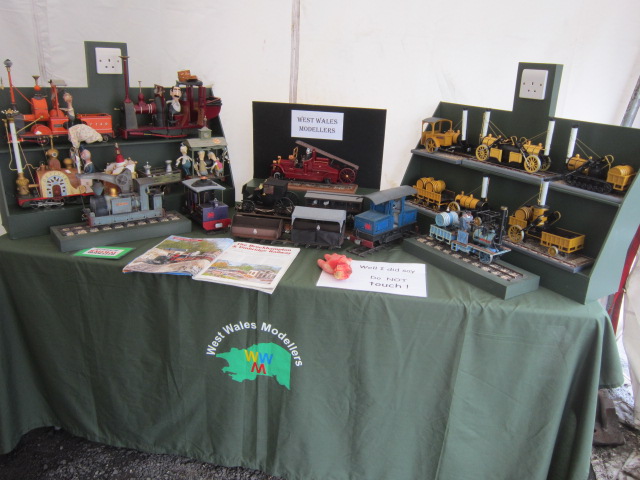

An overcast day with intermittent rainstorms at the Gwili today with Phil and two other colleagues from our group. Reduced visitor numbers due to the forecast but a good day out nonetheless.
The theme of the day was 'Railway Oddities' and items on offer were...
We presented some of our own models...

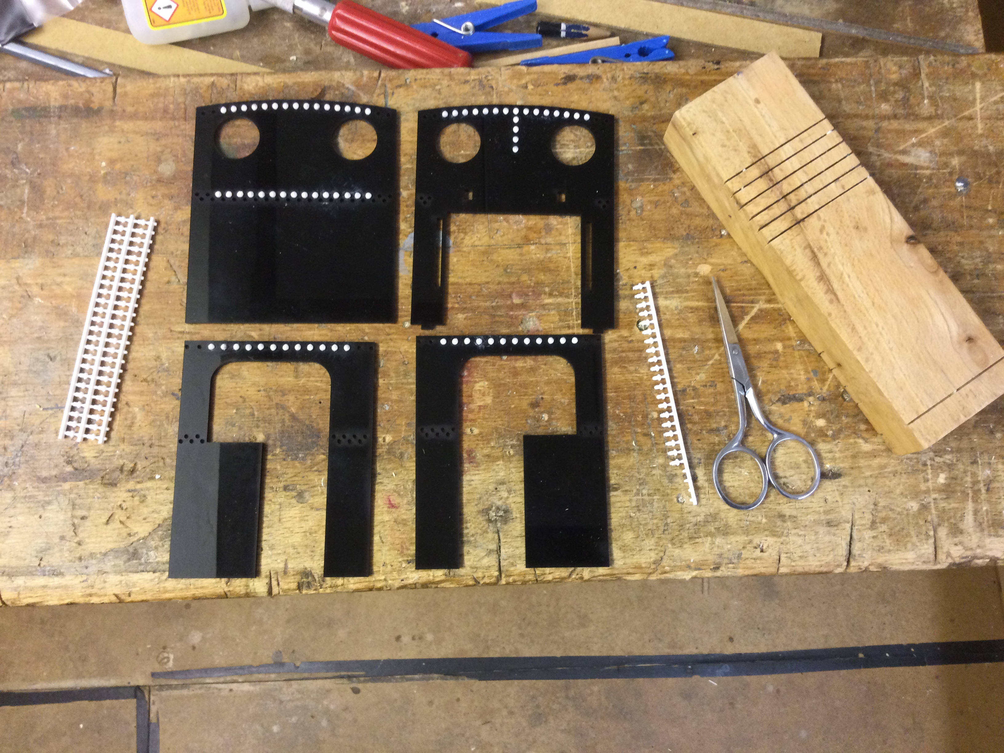

This is how far I got yesterday with adding rivets to the cab sides. To the left are two rows of rivets on their sprue and to the right the third row from the sprue separated off ready for fixing. The kit contains 144 rivets of which only eight (I think) are spare and they ping off into the great unknown with alarming alacrity. It’s suggested that one cut them from the sprue after gluing in place with fine side cutters, which I don’t have, hence the nail scissors. I used a small puddle of’Power Bond’ on a pice of scrap polythene and dipped the stem into that, up to three at a time. The rivet spacing on the sprue does not quite match the spacing of the holes in the black acrylic but by flexing the sprue (it is nylon), with practice it becomes ‘easy’ to stick three at a time in place away from the edge of the acrylic, snip from the sprue and press down with a narrow implement to get firmly home.
After some riveting fun this afternoon we now have:-
Each piece has one rivet omitted at the edge for ease of assembly of the cab, that leaves 16 needed, I counted the remaining rivets on the sprue, there were 15! I found one lurking on the bench, then crawled around the floor and found two more. I now have two spare at the moment.

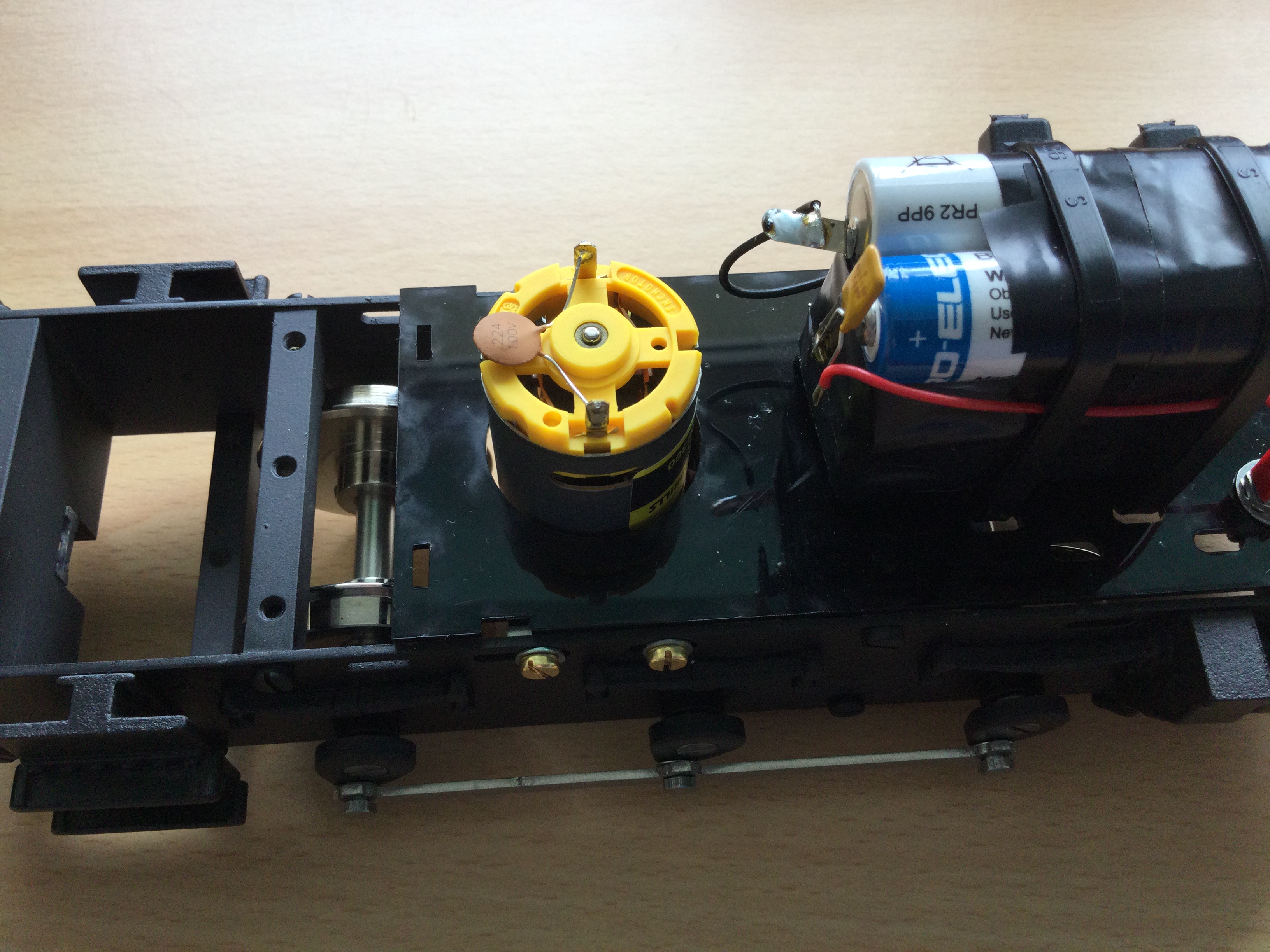

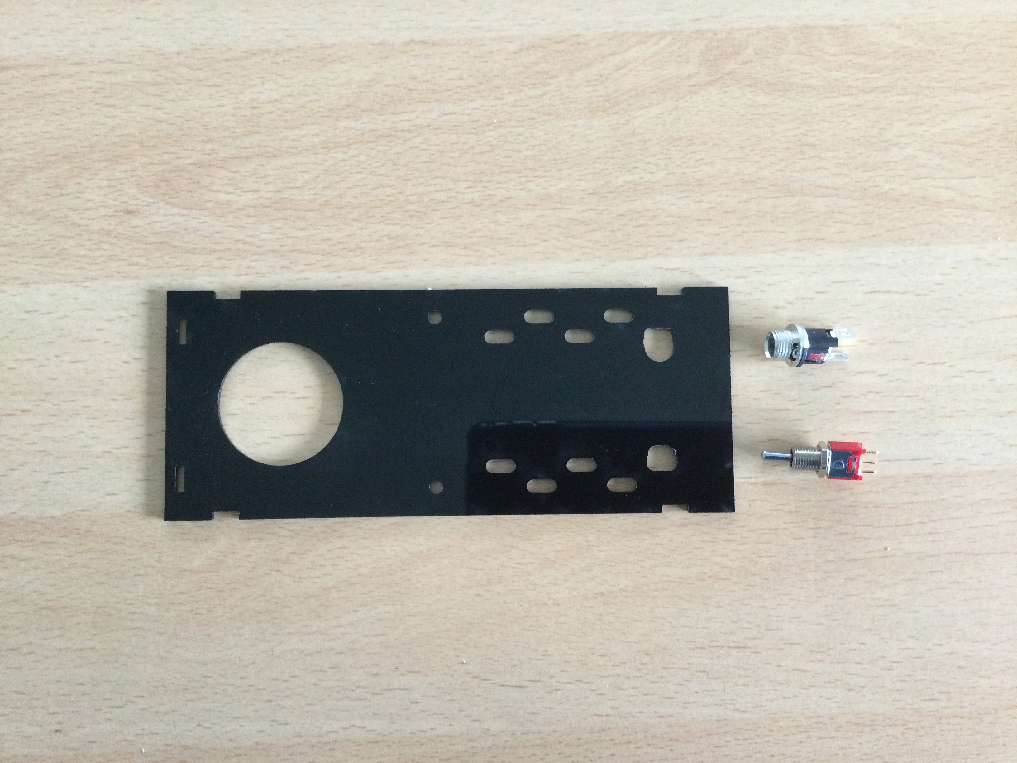

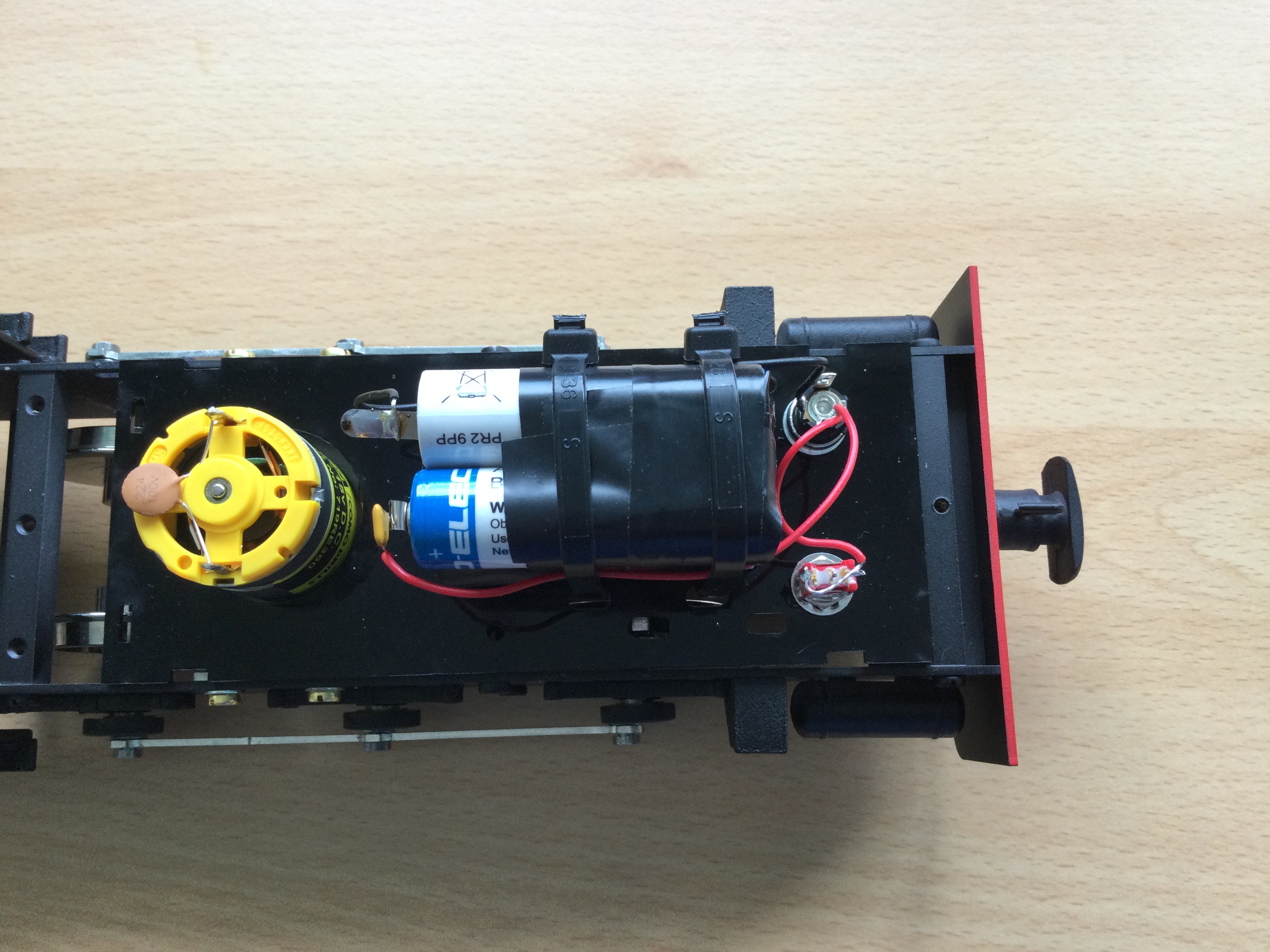

the switch is a spdt type. This means that I can have centre ‘off’ and either side ‘on’. Which makes life easier.
I thought I could then add the batteries, thermal fuse and receiver and do some testing. The kit includes a lamp housing for the centre of the bonnet and another which could be put on the rear of the cab. I would like to have them switch automatically from white to red with direction of travel (may not be true to prototype) and found I had some two wire bicolour LEDs which I could use. I reckoned that it should be possible to connect them to the P1 and P2 outlets on the Micron MR603 I have and emailed Andy at Micron to confirm that this is right. It is but the early version of the software my receiver has needed updating so the receiver is on the way back to Andy.
I eventually managed to get this far by lunchtime:-
There are six NiMH cells. The thermal fuse is the yellow flat object with red wire soldered on between cells and motor.

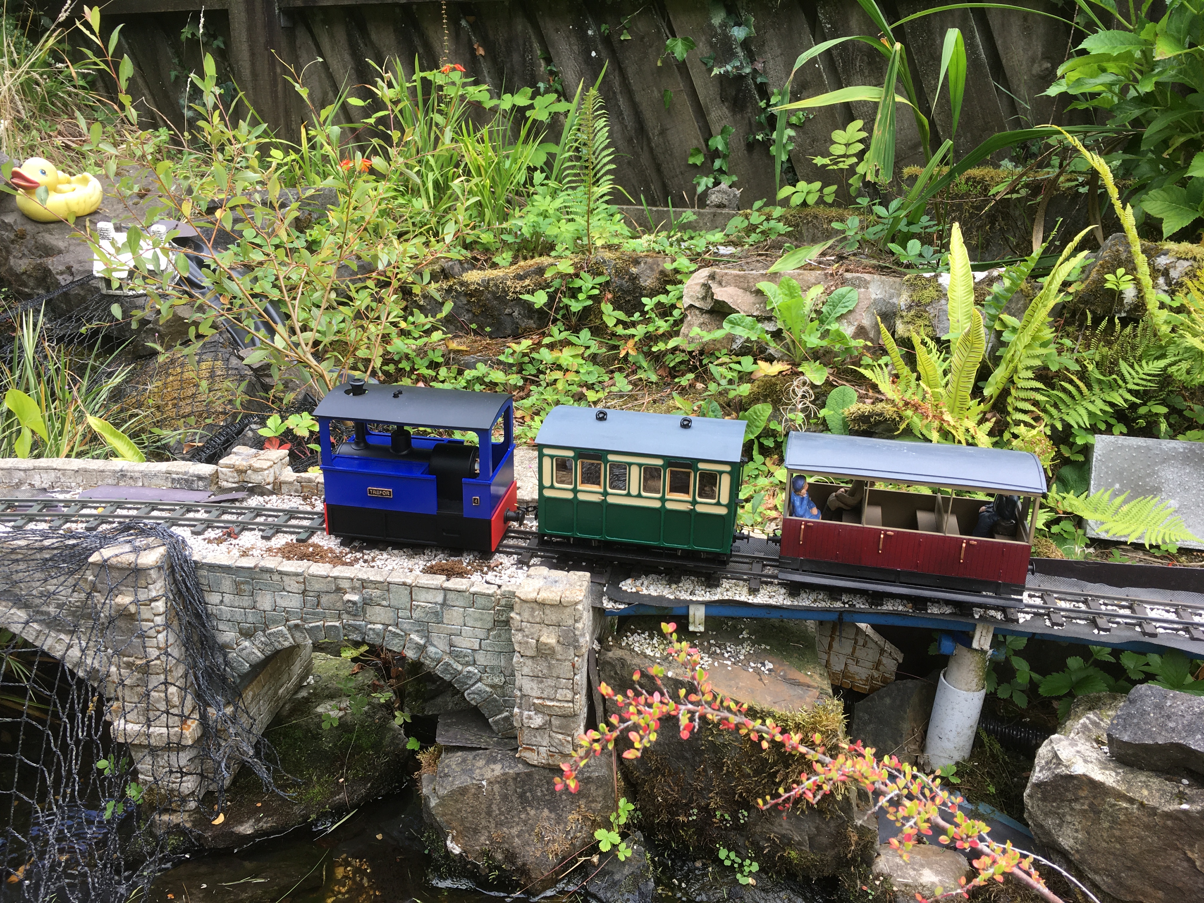

an update on Trefor the Tram:-
He had his first proper trial run yesterday when we visited the Rhos & Betws Tramway with our local 16mm NGS group
Having added a further two NiMH cells, making six in total, he ran very well pulling the two coaches shown. I had originally used four cells but the cut-off voltage of the new Micron MR603 is 4.5v so there is very little headroom for running with only four cells. When left in a siding for a time the MR603 turned itself off after a period of non-use. The new Micron receiver works well but has some behaviour differences to the now unobtainable Deltang based version.
Many thanks to Alan and Syndy for a great day out.

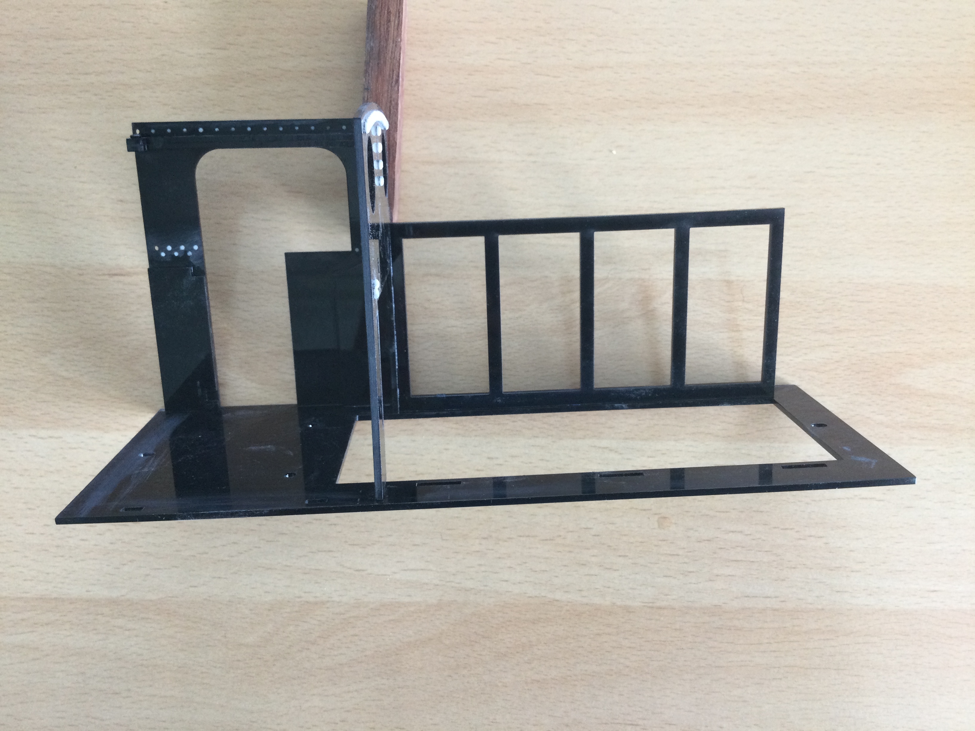

Today I have straightened the cab end of the bonnet moulding which was slightly curved and thus too long to go into place. An easy way to do this was using a shooting board, the emery board included in the kit and one of the scrap blocks of hardwood that come in handy so often:-
The emery board was held against the block as it was slid back and forward using the rougher side. A couple of minutes work saw the curvature removed and the bonnet then fitted lengthwise well but with a little side to side play. A strip of 0.5 mm black plastikard was glued to the inside of the bonnet frames on both sides, this ensured a better fit.
