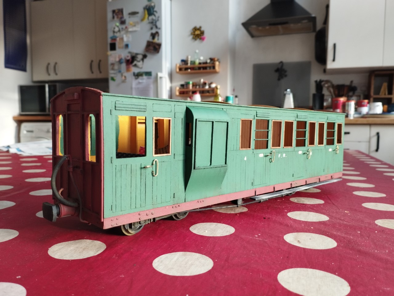

Ffestiniog Van 4's been in progress for a long time now, but is getting there. I've recently added lettering, beading around the windows, door handles and grab rails, footboards, and some light weathering. It's had a coat of varnish, so now I think the exterior is complete. Droplights, interior sides, interior painting, glazing, and detailing with figures etc to go now. That will take place over the winter so that the carriage can enter service next Spring.

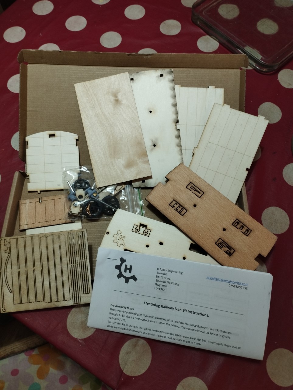

I ought to be focusing on finishing that, but I came across an "H Jones Engineering" kit for the FR's Goods Van 116 (or 99, as it's known these days) and couldn't resist. It's only Β£40, which includes running gear and fantastic replicas of the little couplings used on FR goods stock. I'll be constructing it in my own idiosyncratic way, including overlaying individual planks etc, but here's what it looked like when I opened the box:

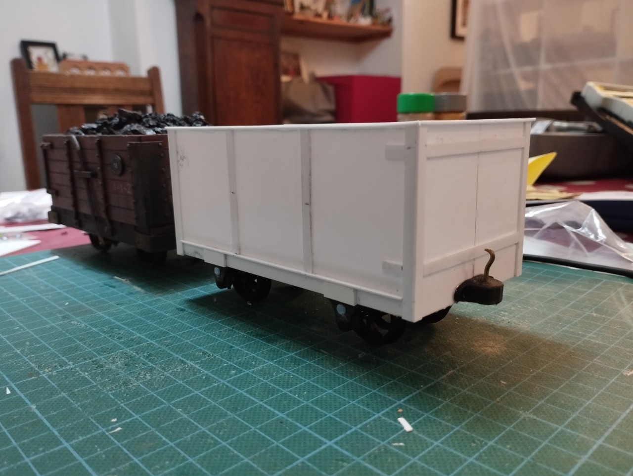

And, by 10 o'clock, I had this:
Not quite finished, but it's got wheels, and couplings, and so I could take it for a spin around the garden, so I'm calling that a success! I'll continue this evening with some more detail... It's a case of "more haste, less speed" really, because this morning someone contacted me with the actual dimensions of the wagon. I'd guesstimated them from phots, with the result that my version's a little big all over, but better over-scale than under, I always reckon...

Looks good to me Andrew, no-one else would notice the difference I'm sure.
- Posts: 6033
Re: (WH)WHR Rolling Stock
I agree with Peter, it does look good so far. As for the size, it looks OK alongside the coal wagon behind.

I like the coal wagon Andrew, I guessimated the dimensions for it as well when I did the 3D printed one - not quite right the first time (too narrow for a start), and then redrew it to try and get it a bit more like the prototype. There was a few bits in one of the Ffestiniog moving pictures (number 59) going through the new stock storage shed which IIRC caught a few glimpses of this wagon, which were handy for the end door detail. Look forward to seeing how this goes.

The Ffestiniog Van 4 is looking superb as usual Andrew, how you hand cut all those windows so accurately is beyond me.
Oh! and of course it has step boards as well.

Thank you! I should have said, it was your model that inspired my to build mine!Red Star wrote: Wed Oct 26, 2022 5:36 pm I like the coal wagon Andrew, I guessimated the dimensions for it as well when I did the 3D printed one - not quite right the first time (too narrow for a start), and then redrew it to try and get it a bit more like the prototype. There was a few bits in one of the Ffestiniog moving pictures (number 59) going through the new stock storage shed which IIRC caught a few glimpses of this wagon, which were handy for the end door detail. Look forward to seeing how this goes.
Size-wise, I think it's about a scale foot too long, and perhaps six inches too tall and wide, and I can live with that. What I can't live with is that the way I'd added angle iron to the opening end meant that the doors on the real thing wouldn't have worked! My line's miniature coal merchants would probably be quite pleased at the extra capacity of my plus-sized wagon, but not at all happy that they couldn't get the coal out of the wagon without climbing into the thing!
I've applied a couple of hundred rivets and will add more detail this evening, then I can paint it. It's a bit cold for spraying really, but i don't mind a slightly ropey finish on a goods wagon which i'll be weathering anyway...

I don't, they're all different - I have to make a bespoke droplight for each door!
I knew you'd like those! I think of you whenever I do them - funny the thing's we're known for, isn't it? A fondness for weathered foot boards on 16mm scale carriages is pretty niche...
