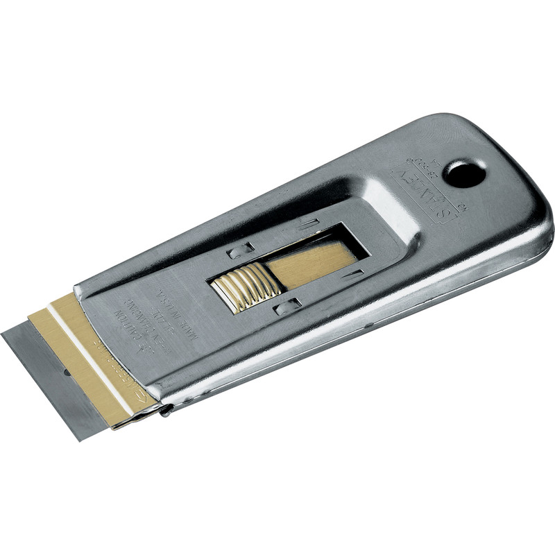

I must admit I use glass on all my FDM printers now as it gives, by far, the best finish on the first layer. I swapped them out from flexible plates as they left quite a rough first layer, despite sticking to it really well. I use 3DLAC Plus now to give a very powerful adhesion, often a little too powerful and a scraper is required to remove them. Something like the picture below.
As Rik posted while I was posting, I have to say I agree with him, I rarely get away without some sort of "glue" in a glass bed, it's not worth me trying without anymore, especially on large flat prints. I would personally avoid Pritt though. I used it successfully for quite sometime. It should be noted though that the layers do build up unless you wash it off every time, which is a PITA in itself, but also can give a very rough first later as it builds up. 3DLAC, does not do this and is brilliant, though expensive, but worth it IMHO.

I note the Stanley scraper Steve, that looks very good, never seen one before. I used to use a Stanley knife blade held almost flat to get prints off the Qidi, this would have been a lot easier ( and less dangerous!).

Glass is actually very very difficult to scratch with a scraper such as the one above or similar. I have tried, many times and never managed to make a scratch on them as yet let alone break one and honestly I have given it significant force, more than I would if I thought about it while doing it. I use the official Creality glass (from Amazon), simply because it does the job exceedingly well so I don't see the point in changing it. What I would say is never try to get the print off before the glass has completely cooled and feels cold to the touch, it is extremely well attached and you will end up taking the extra adhesive layer off the Creality glass. I have done that a couple of times now and have managed to make a couple of annoying holes in it, I have since replaced the bed as they are not all that expensive in the grand scheme of things and am just more patient in taking the prints off.philipy wrote: Sun May 29, 2022 12:51 pm Thanks chaps.

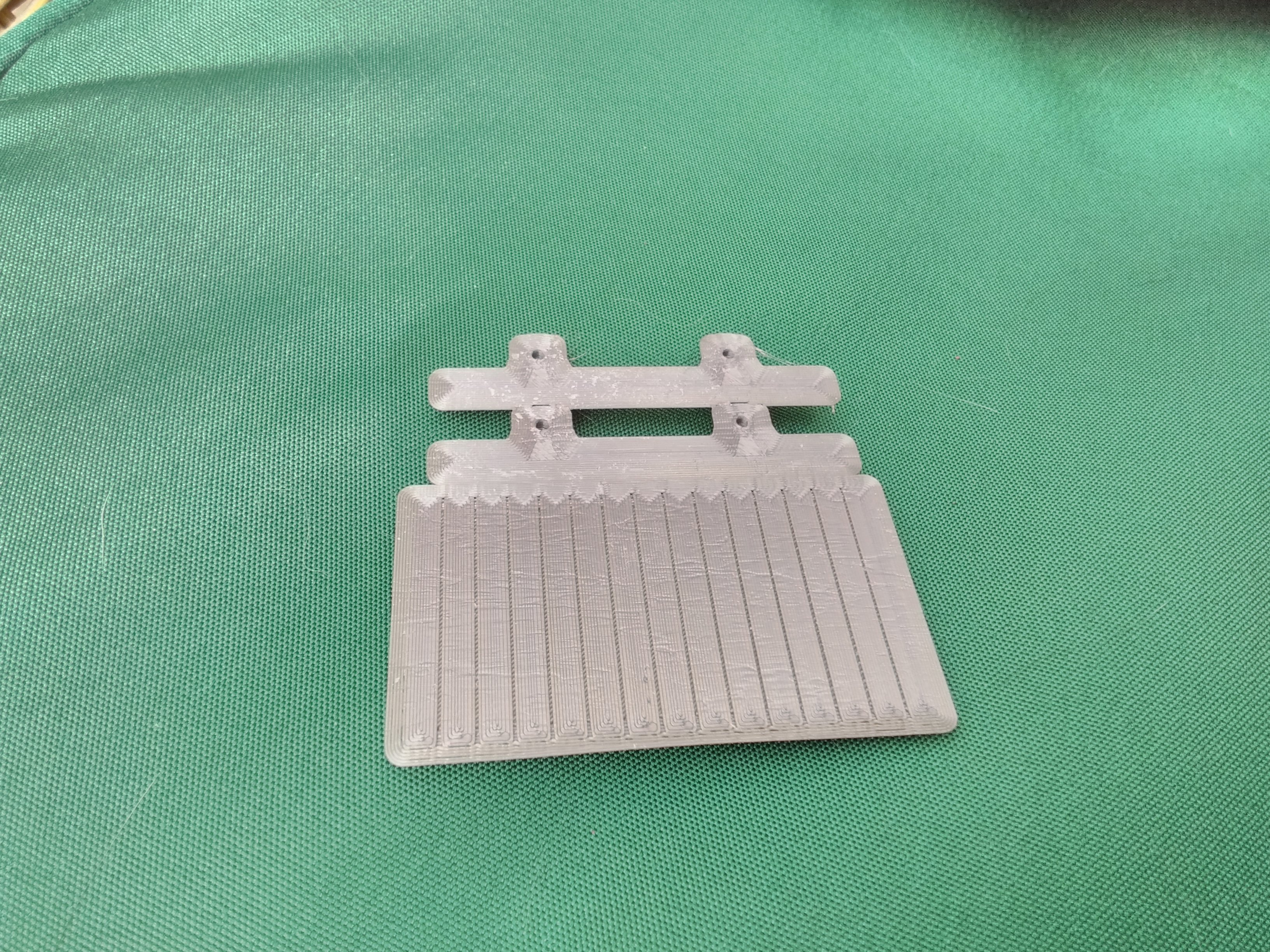

I scrape off the prints and the old Pritt with a broad-bladed chisel. I've not noticed any scoring or scratching of the glass. As it's heat resistant, it's quite tough.
There is a very slight unevenness on the lower surfaces of the print, but I don't think it's obtrusive. This is the print bed side of a 7mm scale chassis (with five-layer brim) I've just printed. As you can see, to my mind, it's fairly smooth. Rik
