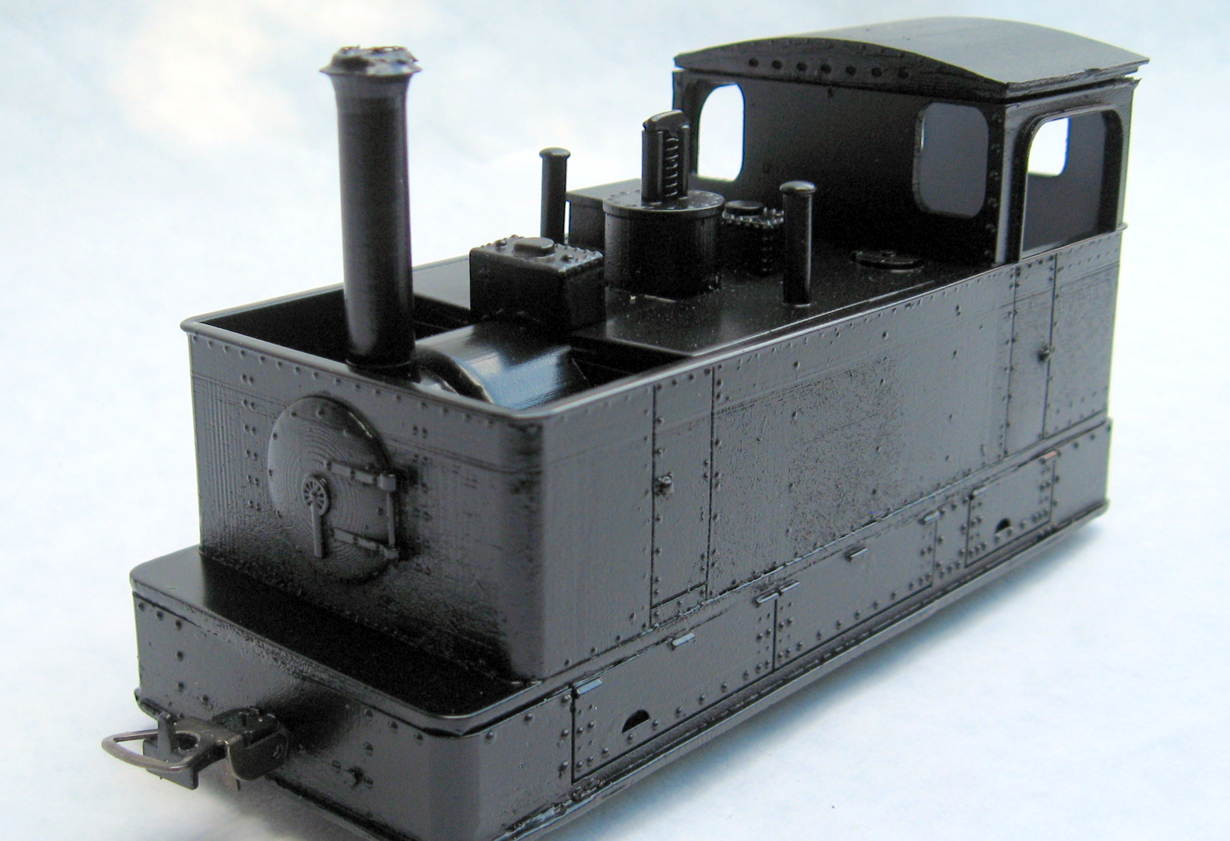

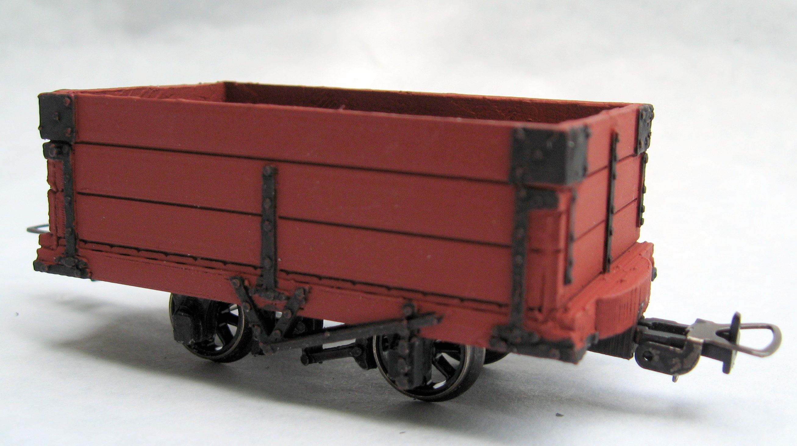

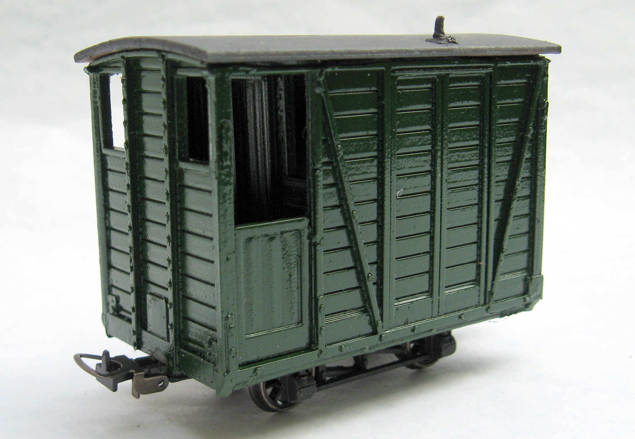

It's been a while - fitting a new kitchen and various family events have taken their toll - but the 0-16.5 GVT stock is nearing completion.
There is an 0-16.5 GVT mineral wagon on Thingiverse but I was disappointed with it and so drew my own version which is a slight variant on the other design.
The brake van
The open coach
Third class coach And the loco
They are a lot fiddlier to construct and paint than 16mm or 15mm scale models!! I am in the process of converting them all to 16mm scale and will upload them here in due course - but rescaling is a bit more complicated than it might appear. Things sometimes go a bit strange when they are rescaled.
The brake van
The open coach
