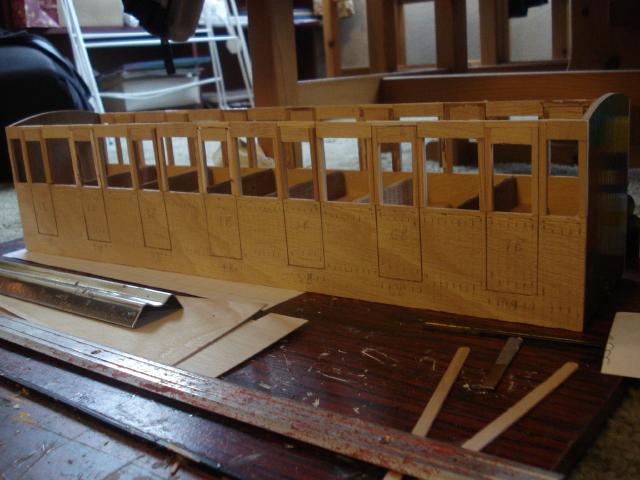

Anyway, cut out the sides today, and then cut the doors out of the sides, all 14 of them. Also started building up the full height of the doors using stripwood recovered from the old body. The construction technique is similar to the buffet car with the sides going up the waist height, and the windows being built up from stripwood. With 14 doors this is not going to be the fastest of builds!

A production line of new doors, 14 are needed in total, but I ran out of stripwood after I had done 12...
The doors and the side panel. The doors are numbered so that they get glued in the right place, they had been previously been cut out of the side panel
The side panel, with planking scribed, although the doors are not yet glued in place. I'm hoping to start on the framing for the windows tommorow, but that depends on how much stripwood is salvageable from the old body

Still carrying on with fixing wrecked Ashbury number 4, and managed to finish the first side today. Also managed to reuse a few bits off the old body, as SB said in one of his garden rail articles "Recycling can be fun"
The first new side. Recycled is wood is white mostly, the remains of paint
Planking detail, once again all hand scribed with a compass, although didn't seem so tedious as it was for the buffet car or the Gladstone car

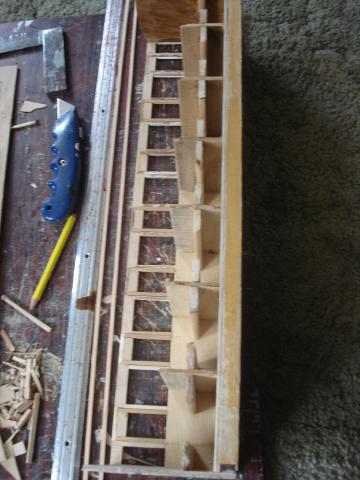

Anyway, apart from that exciting *cough* development i've been working on the interior. As ever, something that should of been simple wasn't as all of the seat backs had to be lowered in height because the new coach bodysides are lower. This meant breaking off and refixing in place all of the seats.
Also, to the left of the body (on its side) can be seen 2 lengths of 1/8th square stripwood, purchased today, allowing me to complete the other bodyside. Hopefully I've now got all of the parts required to finish the coach, I'm hoping for completion in mid June for official unveiling at an NWAG steamup.

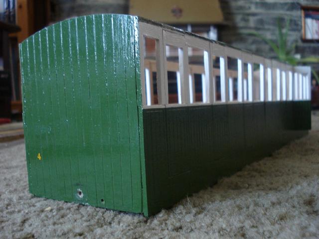

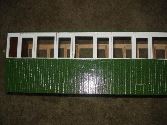

I've now started painting number 4, all of one side and most of the other have been primed, and i've given the primed side 3 coats of the off white used for the upper half of the carriage. I did take a pic but the photo didn't really show up the white paint, as the primer is also white. Hopefully, I'll start on the green of the lower half over the weekend.
I managed to get the 3 coats of green paint on the first side, somehow squeezed around steamups and student finance applications over the weekend
One of the doors has not been glued in, so that with carefull posistioning the door can be put in the open posistion for photos.
This side is done, the other side still needs painting. Then the interior needs to be stained. I have started the droplights today so that they can be put when the painting and staining is done. As usual some will be left in the open and semi open posistion. The glazing can then be fitted, and then the old roof modified to fit the new body. I'm hoping to temporerally fit the coach with the bogies off the workers coach, as one of number 4's bogies was destroyed in the crash.

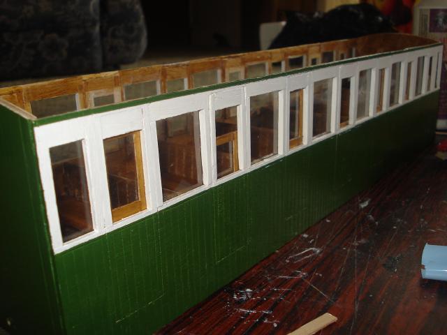

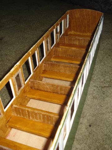

A week further on, and the exterior painting is just about complete. The interior has also had a coat of wood stain, and the droplights have been fitted, as usual, with a proportion either half or fully open
The completed interior
Today, I fitted the glazing which is a bit of a mash of various plastics that I had available, including some left over from the IMP workers coach and the IP FfR coach. It was fitted with epoxy resin, which I tend to use for glazing now, although I resort to superglue if epoxy fails.
I am hoping to have the carriage on its borrowed bogies soon, followed by re-attaching the couplings, vacuum pipes and door handles and grab rails. The roof still needs modyfying as well. Re-entry into service is hoped for Saturday...
