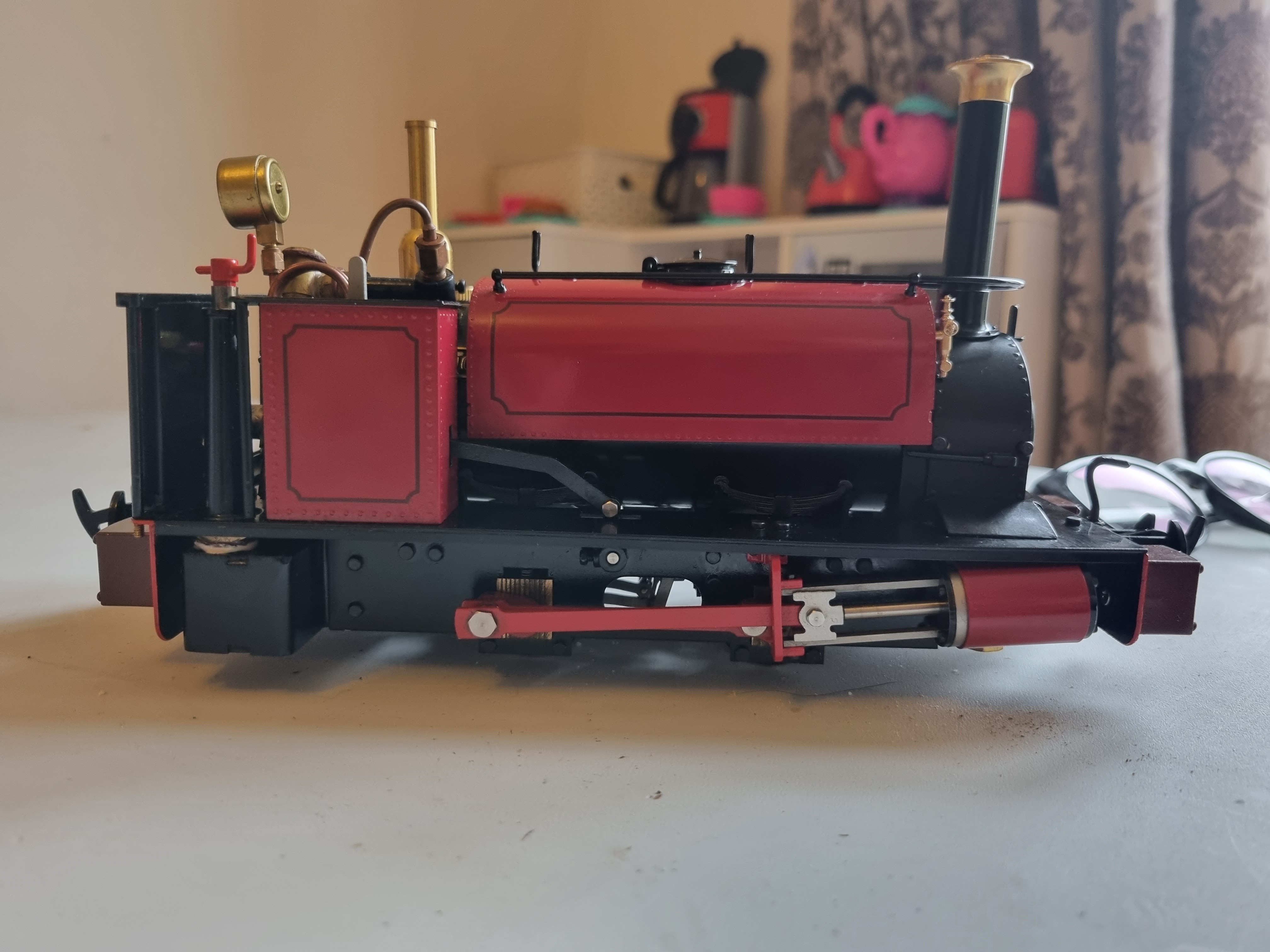

As an early 40th present to myself I decided to get a GRS/Bowande quarry hunslet.
It's arrived today & all is not well. The chimney & safety valves are at angles rather than straight. The saddle is also not sat straight with the tank going uphill towards to the chimney & the smokebox doesn't close properly.
I'm very disappointed as its a model I've wanted for a while. Has anyone else had this issue with one of the models?
The photos don't show the saddle angling up properly.

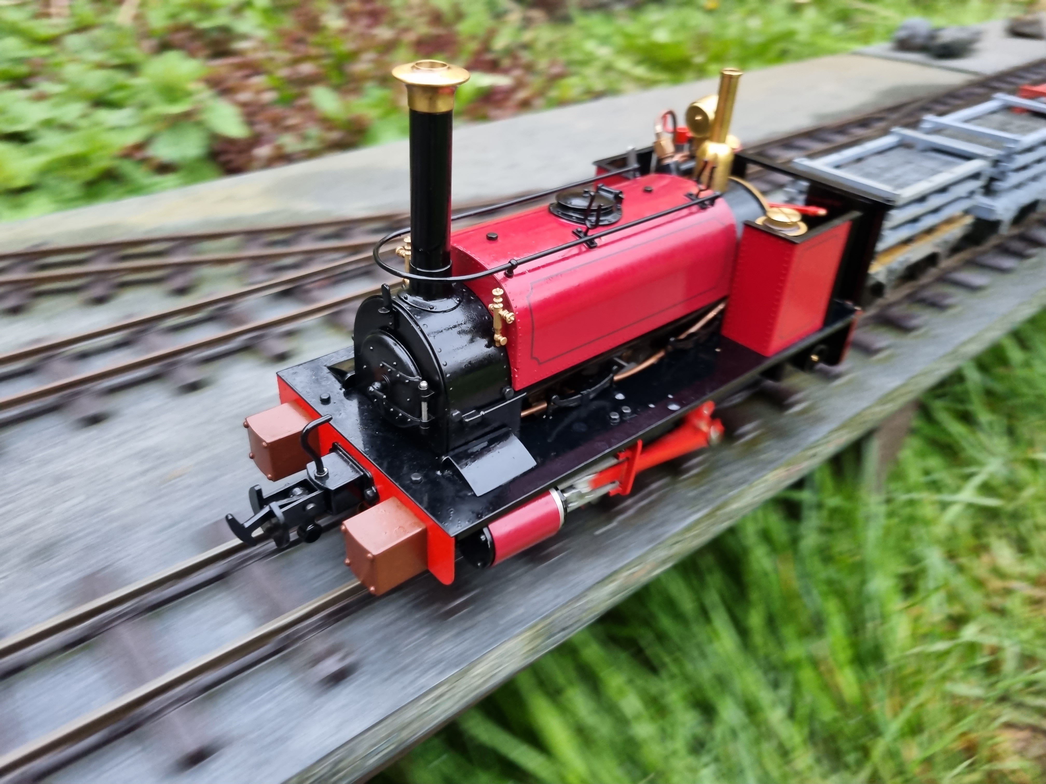

Well my little hunslet arrived today for the second time.
This time Alice arrived unharmed & in 1 piece. I have had a horrendous day at work today driving lorries up cart horse tracks to farms.
I drive artics usually so this drove me Insane to the point I nearly quit as I don't do this. The hunslet was a welcome relief when I got home & so I decided to have a steam up & relax after the stress of the day.
Still needs more running in but my observations so far are that it runs well for a small engine. Having steamed it twice I have found that the boiler runs dry before the gas the runs out.

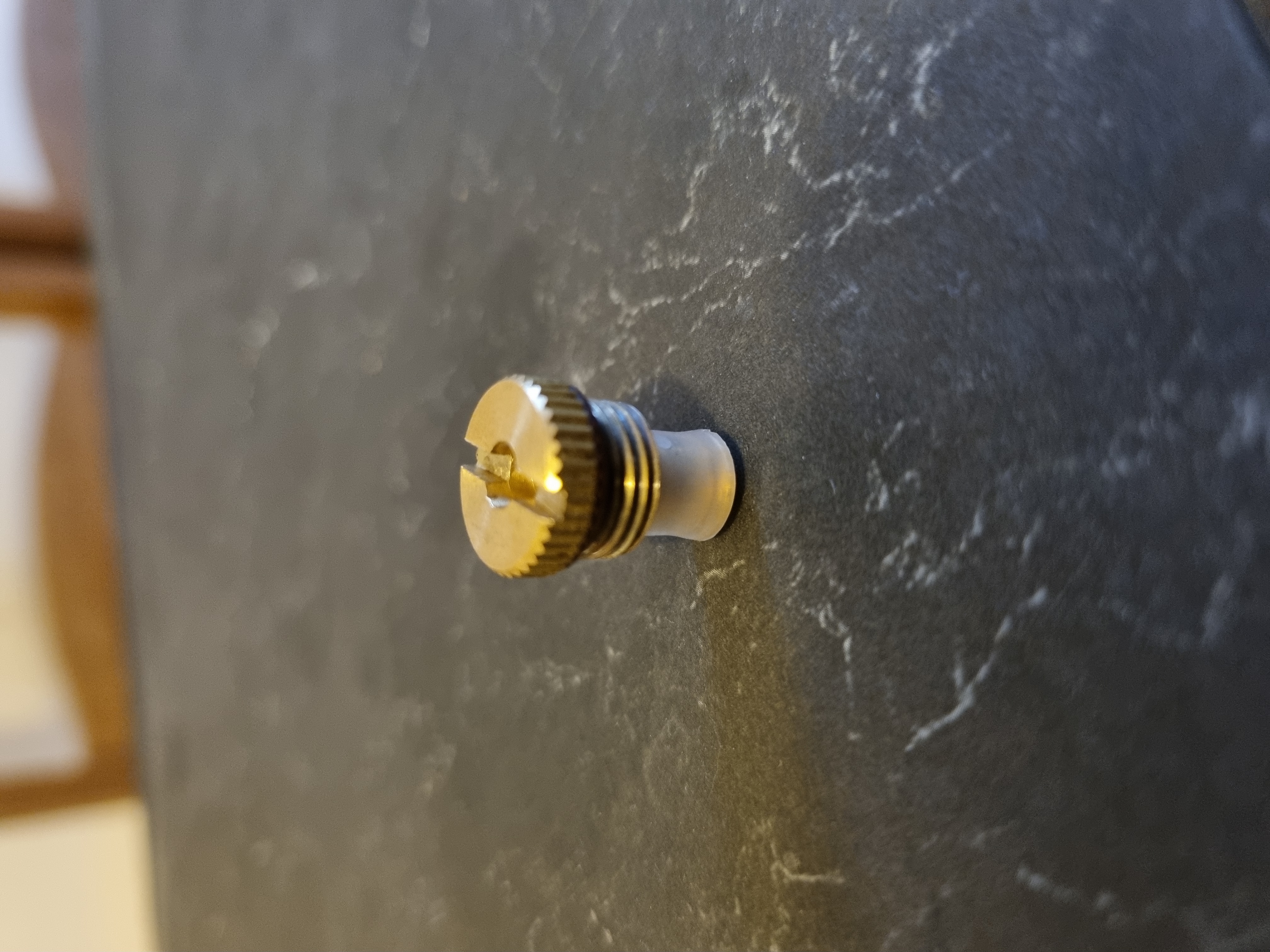

The loco is fitted with a goodall valve however it doesn't work with water just spraying back in your face.
The goodall valve has a large rubber sleeve on the inside but if removed I think it will not make the boiler airtight as I cannot see it working correctly.
The other thing I'd the lubricator with steam oil. Both roundhouse & accucraft locos are empty after running them, this hunslet hardly uses a drop of oil, I'm sure it's fine but again not something i've had before.
It has run though & I think it'll improve with more running in. Tomorrow I'll be calling GRS to speak with John regarding my issues as I need to clarify if these issues I have are meant to be like this or not.

You need to find a hose from your top-up bottle that is a good fit for the Goodall valve. I struggled as well with a generic water bottle, so cracked and bought a Regner top-up bottle. The hose on that has proved to be a good fit for both my engines fitted with Goodall valves.

I've spoke to Mark at GRS & he has told me to cut some of the silicone tube on the goodall valve to shorten it. Its tight sometimes & makes the goodall valve stops working.
The oil issues isn't an issue as such. It uses very little oil so that's a bonus.
I'm going to give the valve a cutting tonight & see if it can make it work any better.

Right, following Marks advice at GRS I've done a modification to the goodall valve by taking off a slice of the silicone tube. Unfortunately at the moment I cannot take a picture as my phone died & it's now here on charge by my bed. Basically the tube is too long & needs to be shortened so that water can just squeeze through. I will add a few photos of my modification tomorrow. I have steamed the hunslet a couple of times this evening to get her run in & whilst I still get a spray off the goodall the mods seem to work.

Interesting. Definitely keep me posted how you get on. John had mentioned the same to me before I had steamed mine, that many of the valves had the tubing cut too long & just need trimming slightly.
Clearly I don't fully understand how the valve works. I figured the tubing seals the hole in the brass plug when acted on by boiler pressure, but that applying a greater pressure from the other side, with a filler bottle, overcame this pressure and allowed water past the tubing and into the boiler.
My tubing is cut slightly longer than in your pictures. If you manage to get it working please post pictures of your cut tubing & I'll do the same!

I cut mine last night & it's working, I still get spray back but it's filling the boiler, you can tell by the spikes on the pressure gauge & water gauge glass.
