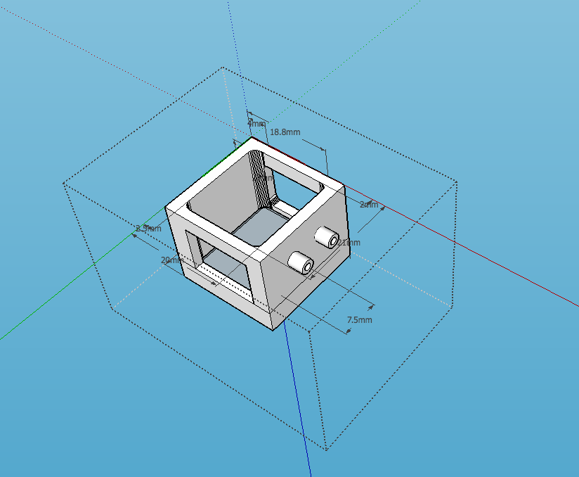

The holes in the frames where the cylinders fit allow the valve port face, which is part of the cylinder, to poke through into the valve chamber on each side of the locomotive. This will allow me to polish the valve faces before final assembly. That requires both sides of the valve chest to have a hole in them - matching the hole in the frame. It seems to me a good idea to keep the steel frame separate from the steam - and this arrangement also allows that. It also allows for bolts to hold the cylinders, frames and valve chests together to pass through a flange above and below the cylinder, through the frame and thread into holes in the valve chamber. The screen shot has the valve chamber cover hidden, and it will cover the hole through which you can see the valves on their faces. The right hand valve is seen "double" with one at the full forward extent of its travel and the other at the full rearwards travel. The left hand valve is in mid position.
So if this is to act as a frame spacer its width needs to be accurate. Here is the drawing for the valve chamber:
Screen Shot 2022-01-21 at 09.54.50.png (49.86 KiB) Viewed 49447 times
So I will be making the valve chambers next - as soon as I have the boiler components for 4420 cut out!
