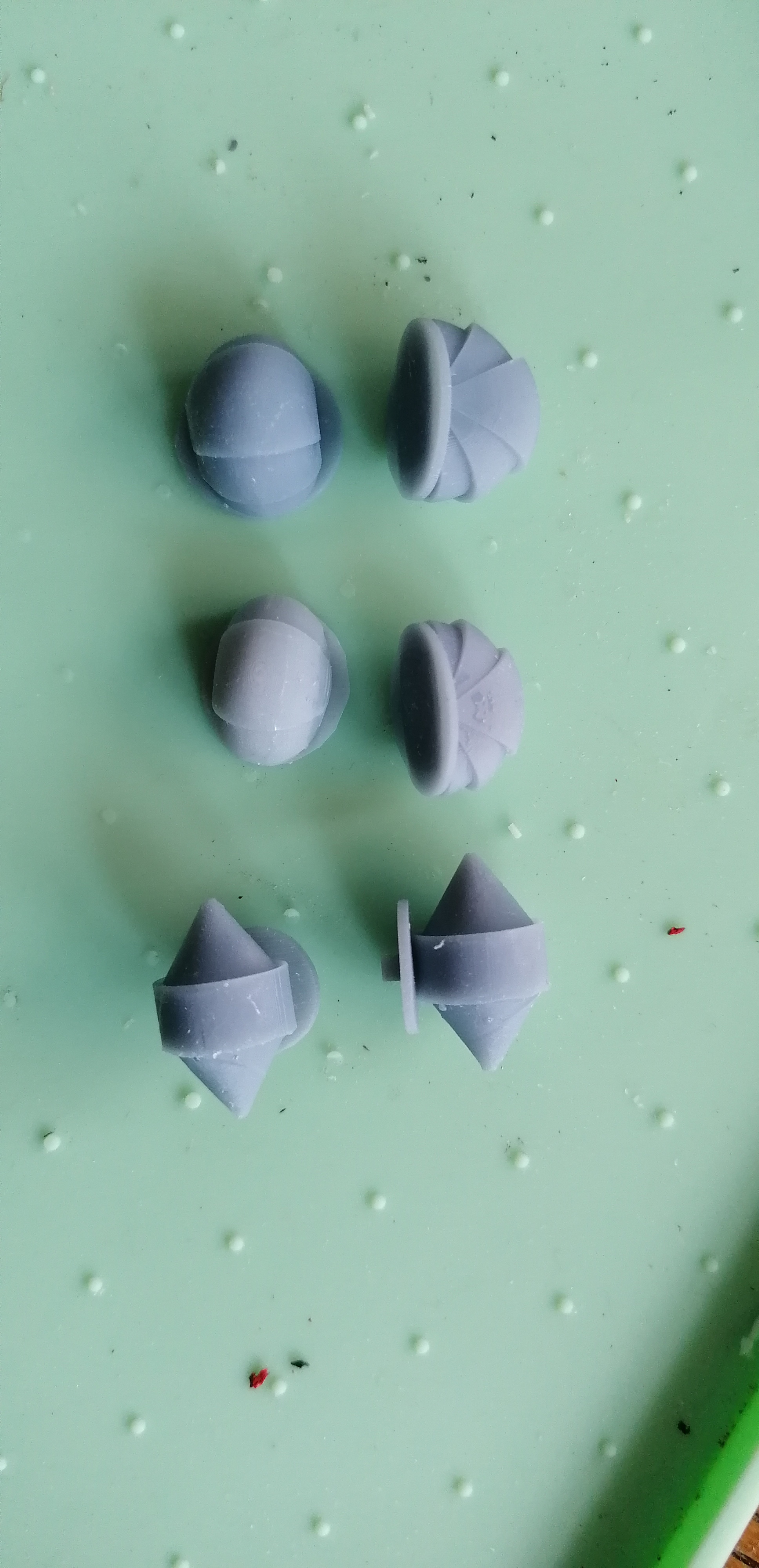

What I can say is they print brilliantly in resin as I have already done some.
The picture shows the vents printed and supports broken off, but no cleaning up has been done. If anyone wants the torpedo vent stl file, just let me know. The shell vents were done in openscad using the code provided and tweaked for size, hence the 2 sizes. :thumbup:
I also printed a dome, it came out very well on the top circle it, but the flare was very bitty, but workable.

-steves- wrote: Thu Jan 13, 2022 9:18 am What I can say is they print brilliantly in resin as I have already done some.
Excellent! That's fast work - and they look great, better than I thought they'd turn out!

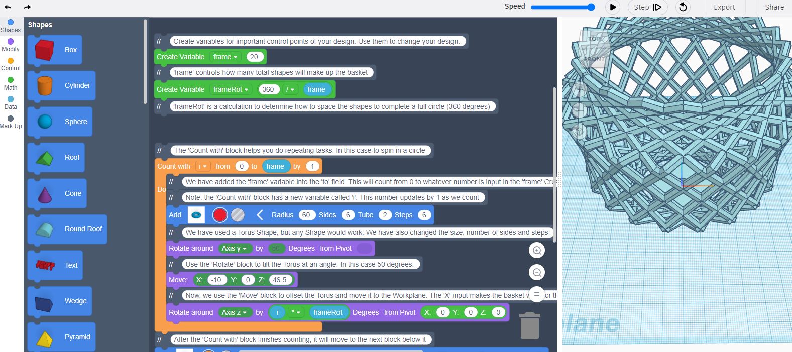

I don't know if anyone has tried it, but Tinkercad also has a code type way of doing things called codeblocks.
This is a screenshot of an example one that I was playing around with.

-steves- wrote: Thu Jan 13, 2022 9:41 am I don't know if anyone has tried it, but Tinkercad also has a code type way of doing things called blocks.
Didn't even know about that - that looks really useful, especially given how easy it is to quickly get something together in TinkerCAD, and it looks like this could enable progression to quite precise refinements.

Well done to both of you as a collaborative effort. The prints have turned out pretty much as I thought they would.

Post by -steves- » Thu Jan 13, 2022 10:01 am
This is an example of CodeBlocks working. It has differing speeds, I went from medium to fast after a couple of runs through.
