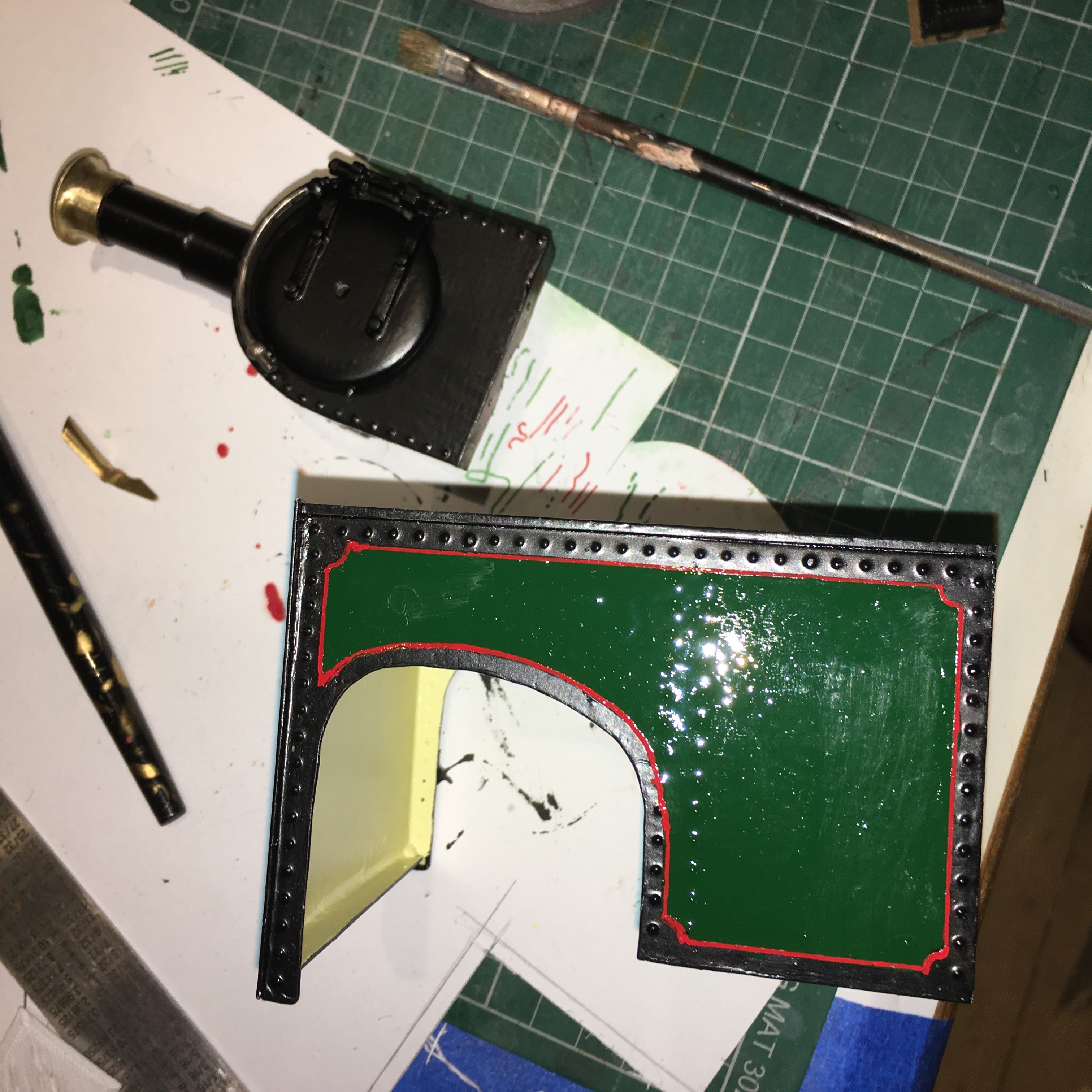

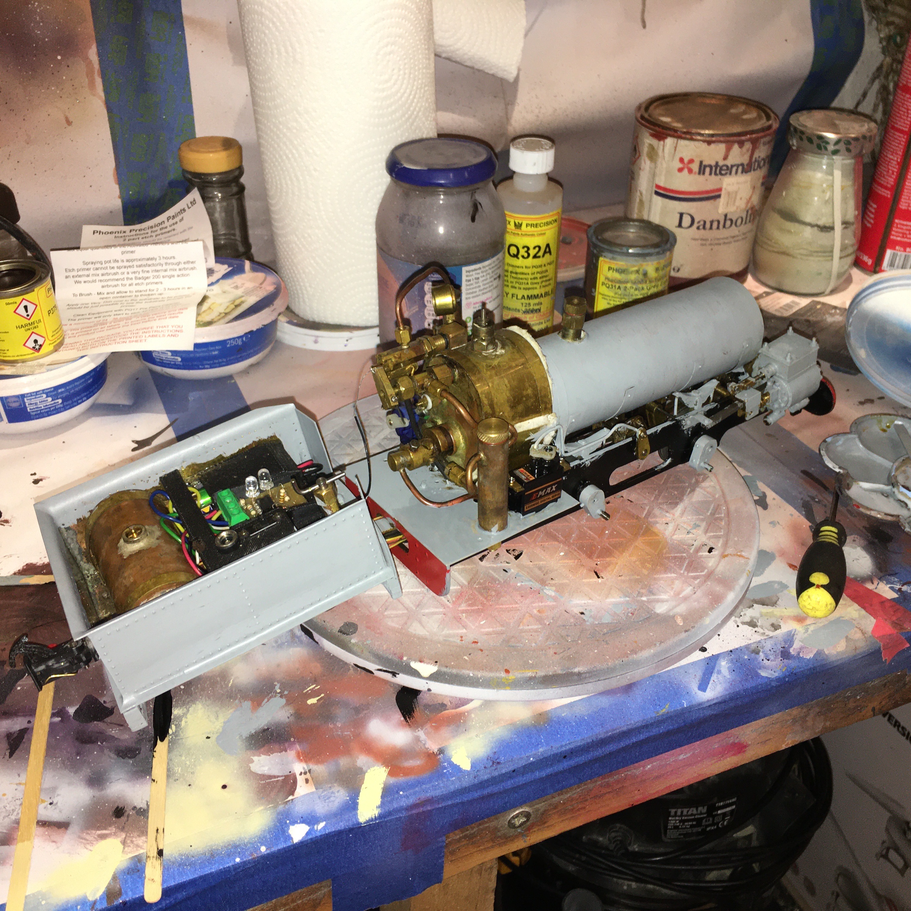

Partly dismantled, removed cab water tank coupling rods and smokebox. It took some cleaning to get all the oil off, but then etching primer:
And then high temperature black all over, and the green where the photo of the real thing showed it needed it such as the cab sides:
and of course the red lining, much easier to do when it is flat on the bench.

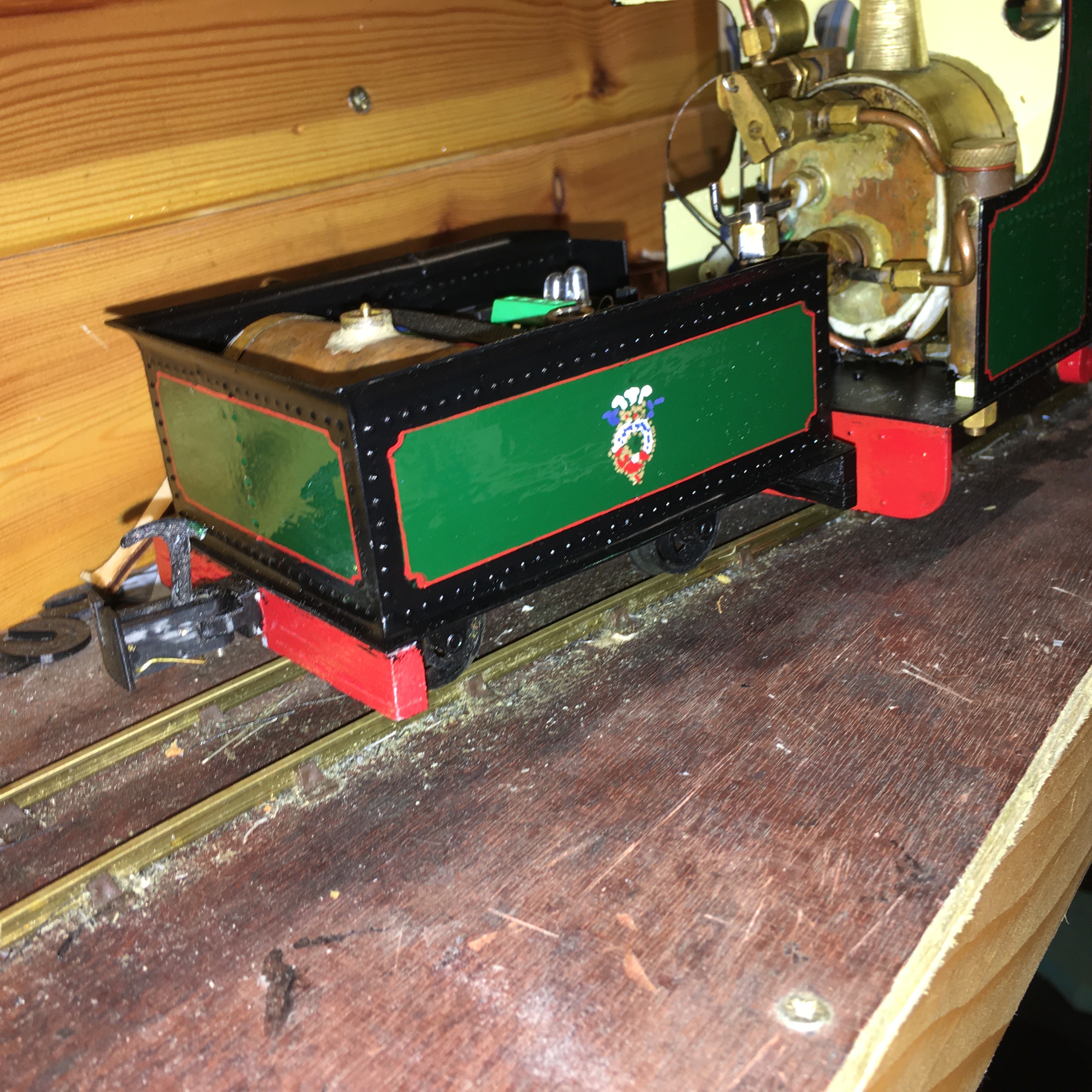

That is the crests finished and the tender lined:

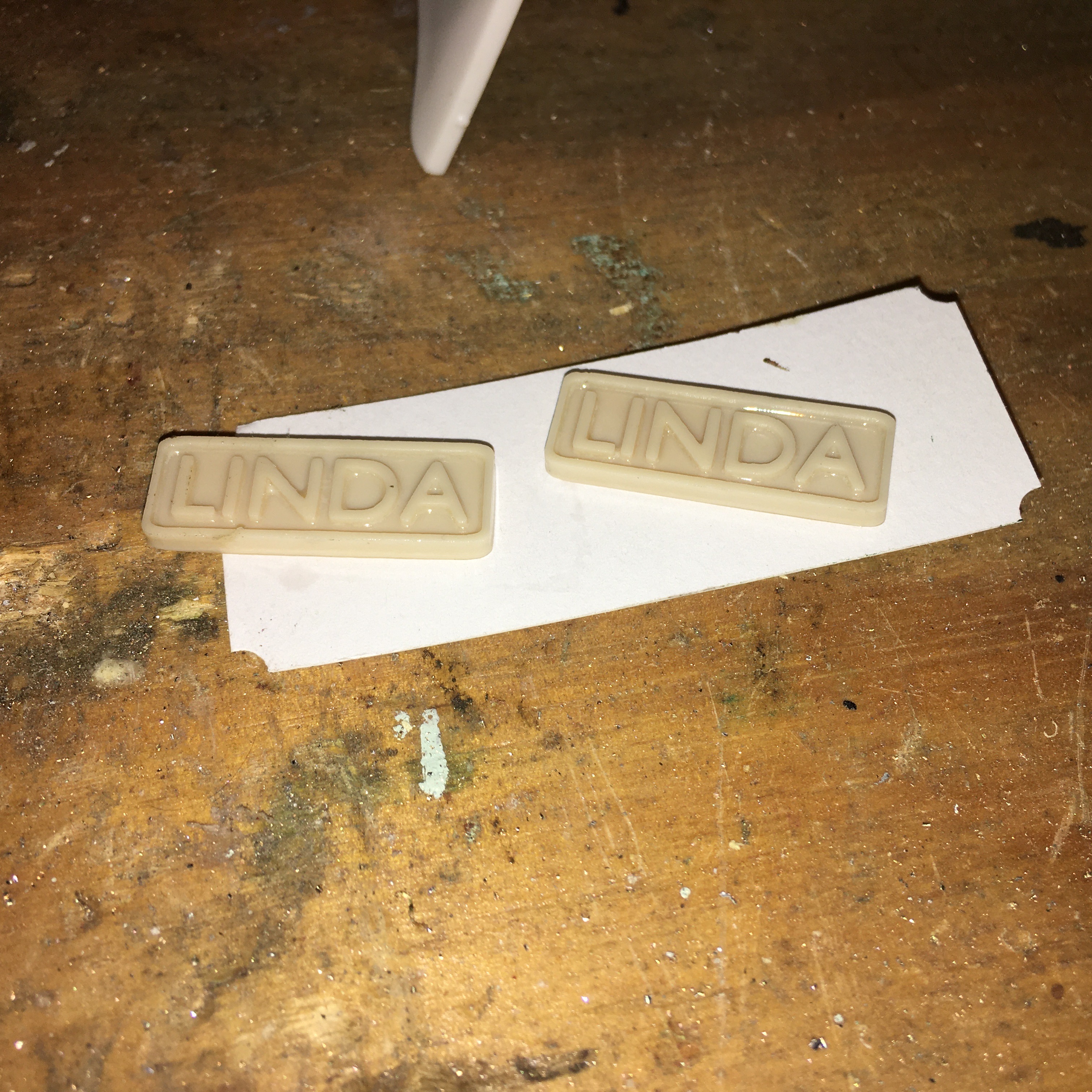

The dust in the green paint isn't actually in the paint - I looked after taking the photo. I have now printed some name plates on the resin printer. I looked into etched brass ones, but the delivery and price sent me back to my own resources!
These have turned out better than I expected. So I will try makers plates which are a bit more difficult.

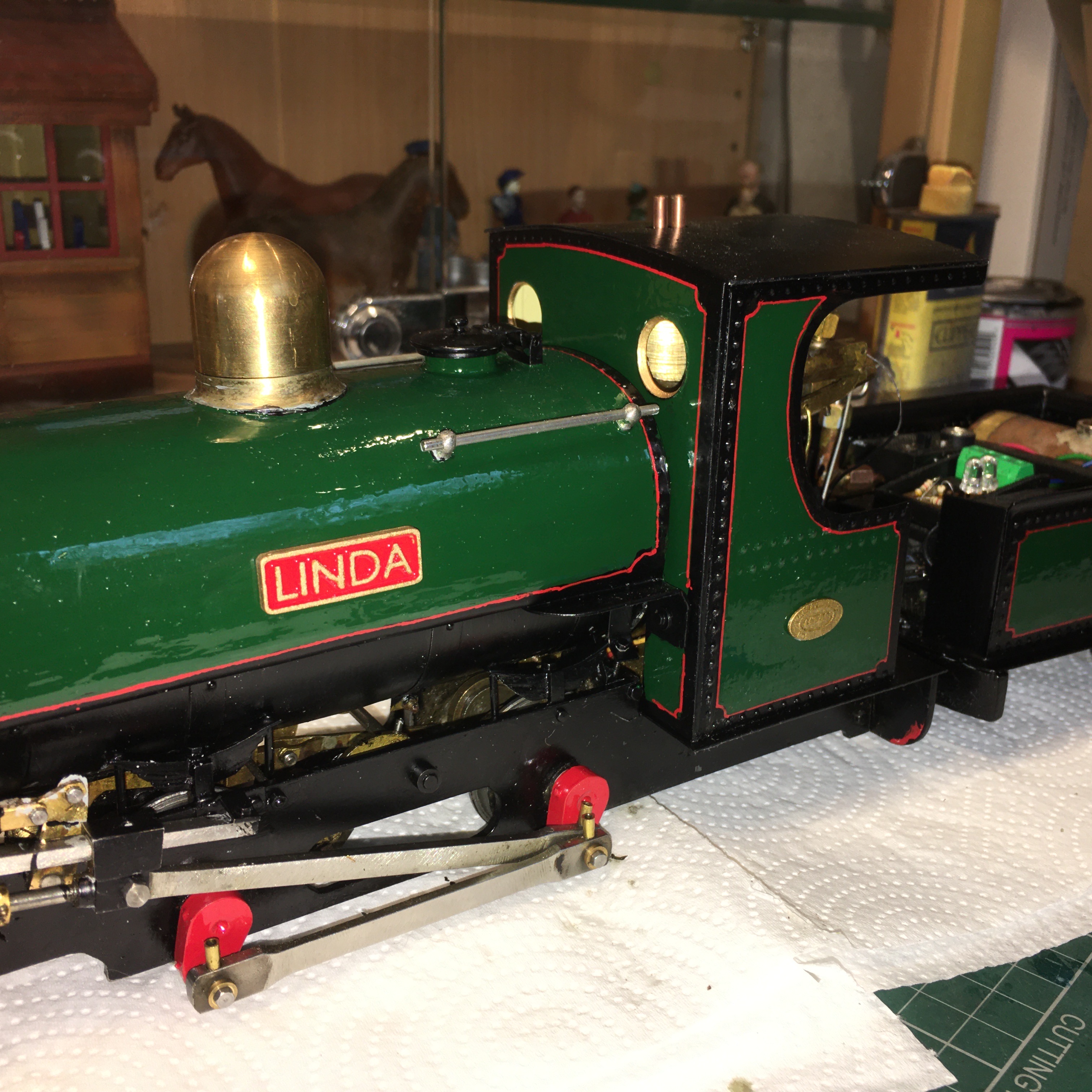

That is the rear facing buffer beams painted black, and the cab front painted and lined:
I have also fitted my 3 D printed name plates and makers plates.
I know the lettering on the nameplates is bigger than on the original, and the chimney should be painted black. But there comes a point where it is a reasonable representation of the original, without becoming pedantic.
