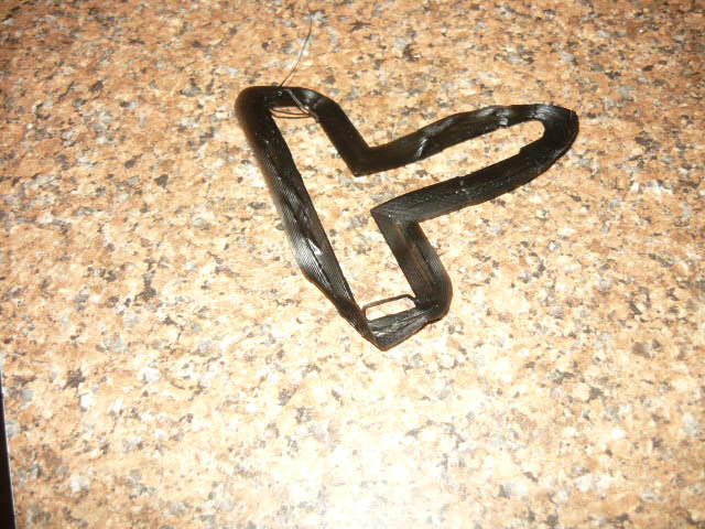

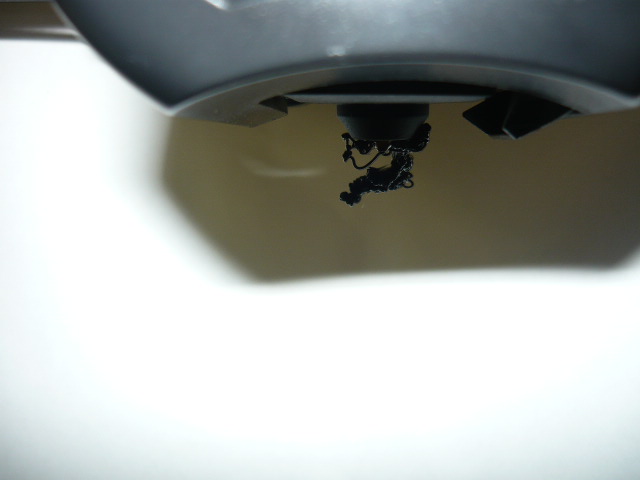

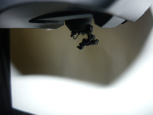

As requested a few pictures of the nozzle with the PLA build up.
This is after about 5 passes after the start of the print. there was nothing on the plate except for one pass down the side.
Out of over 20 attempts I have managed to print 3 items successfully so lack repeatability is a major issue here. This is another attempt it started out as a brim then curled up and tangled the nozzle

Looking at the split on the LH side of the leg of the T on the last picture made me wonder about the print speed you are using? If it is too fast, particularly on the first layer, it may not have time to 'stick' either to the bed or itself?
My software suggests a default speed of 50mm/sec but I find 60mm/sec seems to work well.

Are you sure the printhead is only a sheet of paper's width from the bed? I got hit and miss first layer problems like yours when I first set up my cheapo printer. Eventually I found the bed was distorted and so no matter how hard I tried to level it, there was always one corner which was either too close or too far from the head. Adding a glass bed helped, but I still get occasional problems with first layer adhesion.
Philip and I both make fine adjustments sometimes to the levelling screws while the head is making its first few passes of the brim. Rubbing your finger lightly from side to side over the deposited filament soon shows if it is sticking to the bed. If it isn't, loosen off the screw on the nearest corner.
Some people suggest the first layer should be slightly squished on the bed - ie closer than a paper' s width. Better a bit too close than a bit too far.
