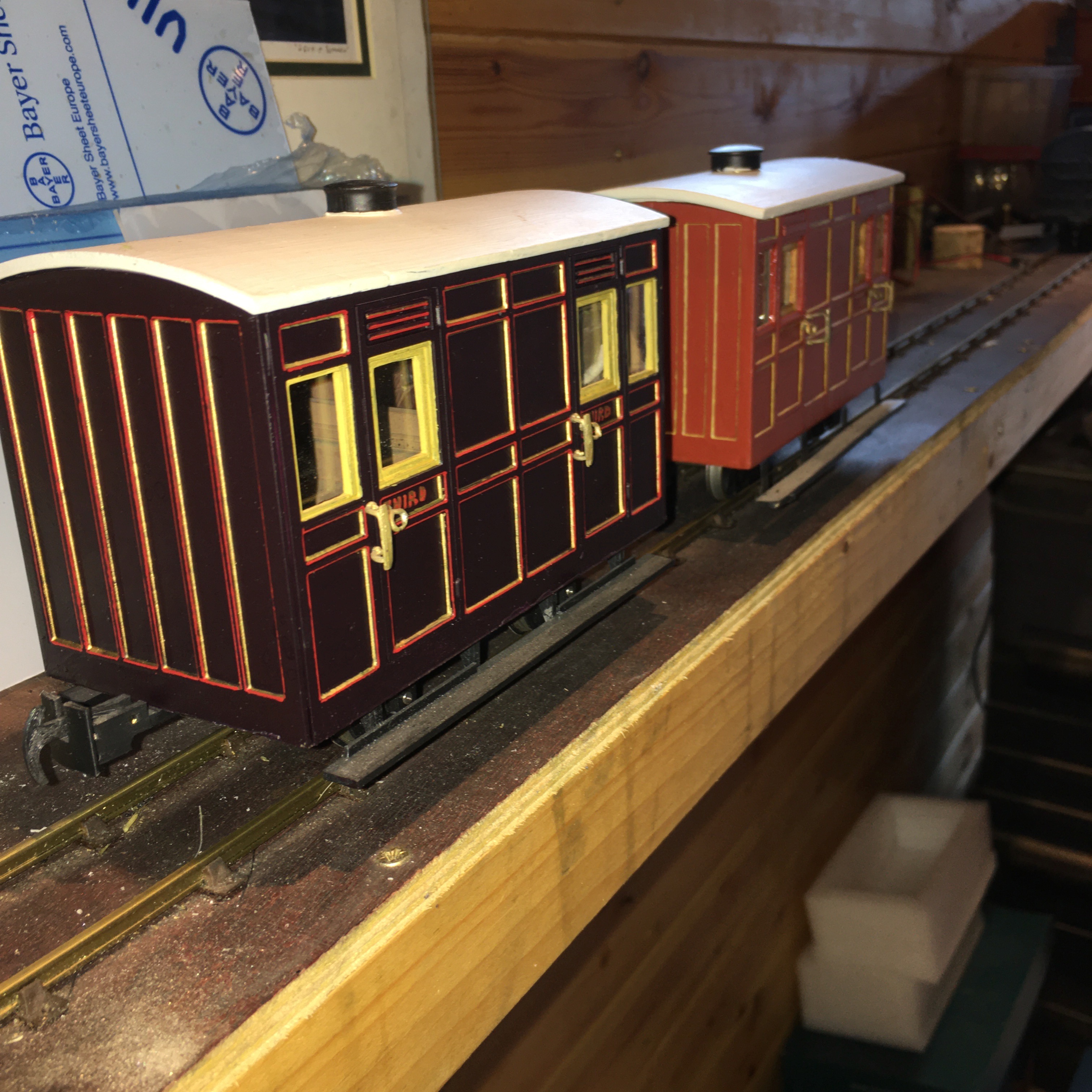

The photo shows two of my Ashbury 4 wheel coaches. The red one is scratch built from plywood. The one in the plum livery is 3 D printed. Can you see any of those marks in the flat sections on the 3 D printed coach? I cant even when I have the real thing in front of me. I think that one has the slightly better finish - perhaps because all of the external framing is square and even (which is difficult to do by hand but easy on a computer).
I did not do any sanding or take any material off to get the finish. I use paint as a filler primer. Specifically I use an airbrush and an oil based paint to fill those imperfections.
In detail:
Coach on its side on a turntable with the side to be painted uppermost
paint thinned until it successfully goes through my airbrush (about 15% thinners in my case)
Spray the side from all 4 sides carefully to cover all of the frame edges
concentrate on each of the flat panels in turn - spraying from side to side until each panel has sufficient paint for it to "pool" making a flat layer
because i am using an oil paint I can keep coming back to specific parts of the side as long as I allow the paint to become "skinned" first.
When I have covered it as thickly as I dare I leave it to dry for 24 hours - then I can start again. It might take 3 goes to get the right finish. Remember that the side I am painting must be upright because I am applying enough paint at each go for it to run.
As to paints. I have successfully used Humbrol and Precision Paints products this way. I don't find acrylic airbrush paints work as well in this way, although I do use lots of acrylic paint on other things. The thinning is important - I want it to firstly go through the air brush and secondly provide a small area of paint on the model - covering about a 1cm diameter area of the model. Then spray it as if it was a full size spray gun and a car I am painting. It then tends to dry as quickly as if I was painting a car.
A last point. I buy things like door furniture - hinges can be printed but handles need to be strong so I favour lost wax castings. Rivets are easy a basic rod shape is softened by painting - but it doesn't look overpainted. I have also successfully incorporated lettering which is easy to get accurate on a computer but at the limit of my ability by hand.

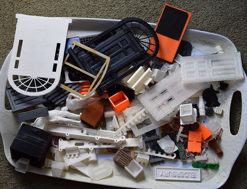

A random sample from my 3D Print Failures box! Some are true failures of the print process and some are simply prints that I was unhappy about for some reason and re-did. I think you'll find that everyone has a box like this.
Age is irrelevant and nobody on here will criticise you for having a go, even if it doesn't work. Somewhere,( I can't remember exactly what it is called) there is a thread of epic failures that folks have posted to publicise theirown errors.Phil.P wrote: Wed Aug 04, 2021 12:38 pm 2. Expectation :
