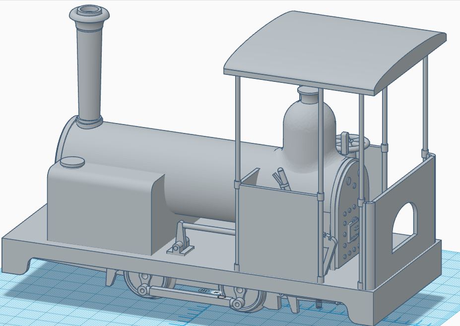

A friend of mine asked me to make him a Bagnall 284 which is quite a small loco.
I produced the CAD work and he is more than pleased with the result :thumbup:

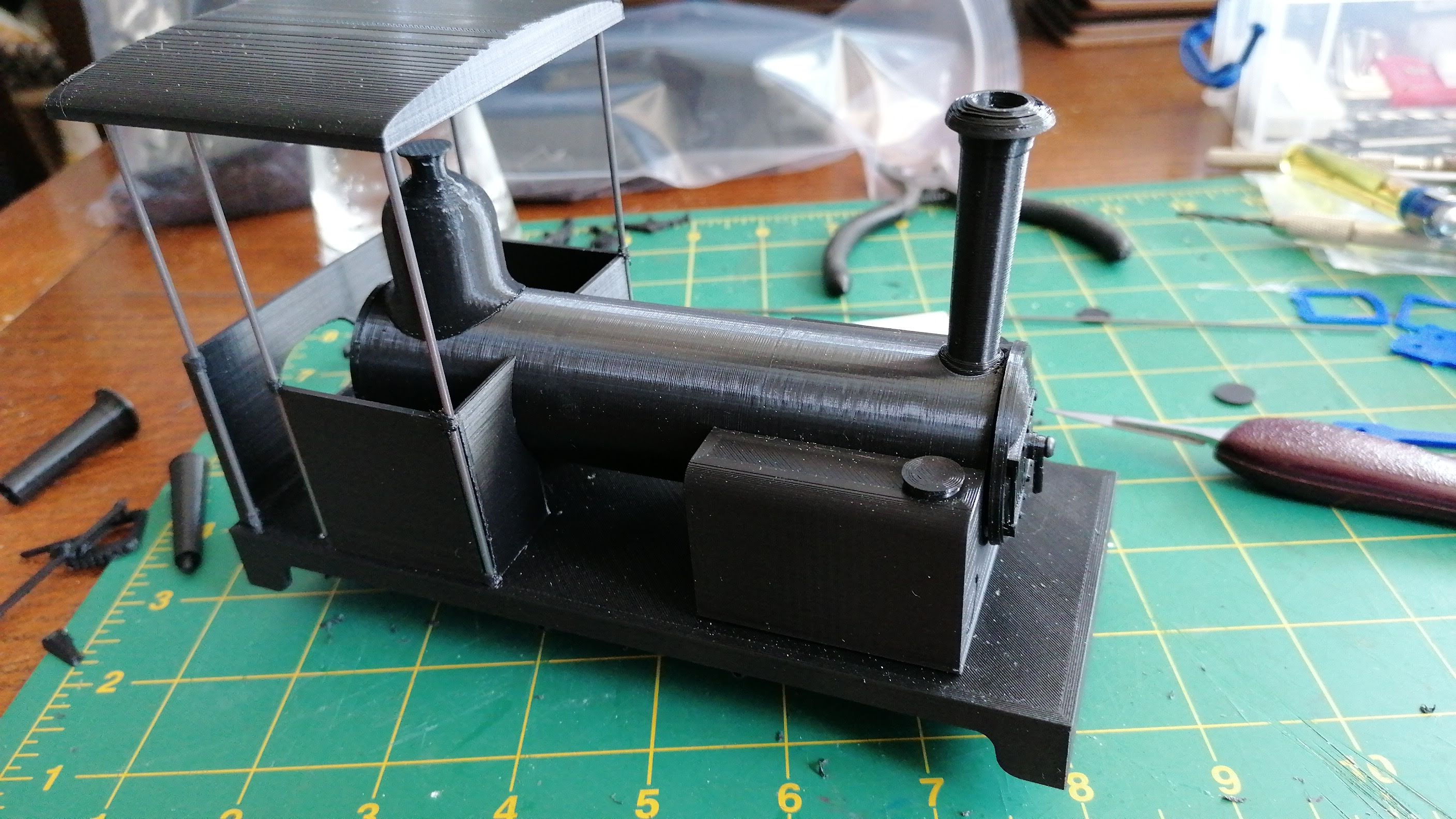

This is how it looks straight from the printer, no filing, trimming, no sanding or paint, no brim or raft, just literally remove from base of printer and put together with about 5 small drops of superglue to hold some bits in place. Most of it is either press/push fit and 5 bolts including the motor bolts. The second picture is what I was working from, and no it wasn't to scale I have to work that bit out, lol.
I could have put the boiler bands on, but they can look a bit messy when printed so I will just add something once painted. The guy I designed it for papers all his models so wouldn't want it on there anyway. The pipework will be made from various bits of metal to what ever degree he chooses :thumbup:
