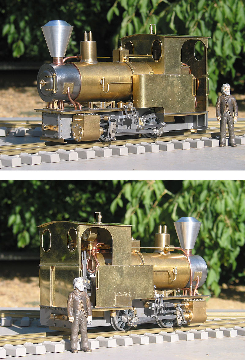

The loco could have been steamed at this point, but I now wait until a model is painted before steaming it, as it it difficult to remove oil residues, especially steam oil, before painting.
By this time it was early February and it took another month or so to add the cab structure and complete all the necessary detailing.
There was a 'La Nina' event in the southern hemisphere this summer, so it was cool and wet by local standards. We escaped the floods that northern parts of the country suffered and I was able to put in more time in the workshop on most days and work went quickly.
The two following photos show it in the brass sitting in early autumn sunshine to have it's portrait taken.
........ and there progress stopped. :roll:
I haven't work up the enthusiasm to paint it and I went back to spending most of my time reading for a while. The model paint brands I use are currently in short supply I'm told, but I did an audit a while back and I have enough paint in stock. I just can't be bothered at present to go through the usual fight to get a decent result with modern paints.
The model will probably be assigned to the Mt. Delusion Timber Co. who paint their locos green, so the following photo shows the model standing in the TVT exchange sidings along with the Timber Co's. Krauss. The Krauss is in the same shade of green that the O&K will probably use, so the photo is a placeholder until I find the right size 'round tuit' and finally paint the model.
There's an unopened tin of Humbrol dating back before Hornby screwed up Humbrol paint formulations and colours, but I still need to find an etch primer that gives a smoother finish than I've been getting lately.
I'm not a great fan of the aesthetics of german steam locos, but the O&K has grown on me while it sit's on the bench waiting to be painted. It has a certain upright and hardworking look to it, compared to the squat and somewhat untidy look of the Krauss sitting behind it in the yard. 8)

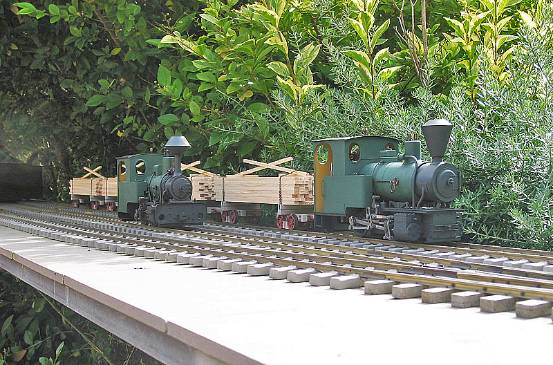

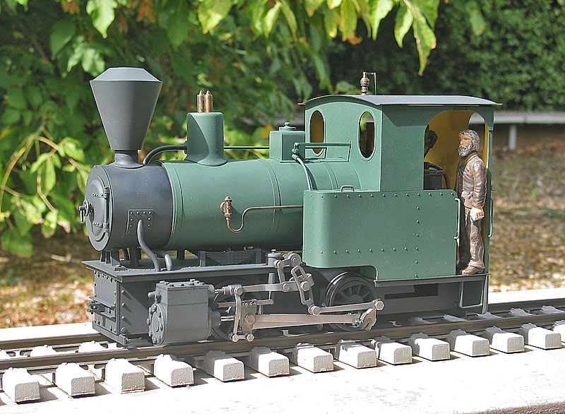

This model has been sitting in the paint shop queue for far too long, but it has finally received a coat of paint...... :oops:
As predicted, it has joined the Mt. Delusion Timber Co. fleet. The sun has reappeared temporarily between cold fronts and the photos below show the O&K sitting for it's portrait. As usual, the TVT engineer has somehow managed to include himself in the shot.
The final shot shows the timber tram's new O&K loco in the mill yard with a load of sawn timber to be delivered to the TVT interchange sidings. The tram's little Krauss loco is also pottering around in the yard.
The model still needs a week or so for the paint to harden a bit more, before I start running it in on the bench.

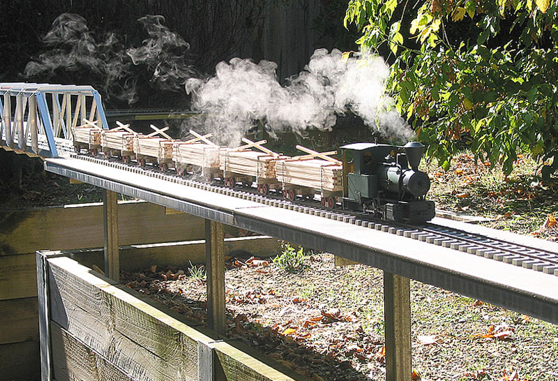

The weather here is well down the slope towards winter, but yesterday dawned clear and calm, and as cold as charity. A good day to boil some water...........
The O&K has been running in on the bench and had one test run on the track. The only speed bump on the road of progress was that somehow I had made the gas tank a little larger than planned and the water was running out just before the gas. Not my desired state of affairs when running a steamer, so a new tank was fabricated and fitted. A bench test showed that now there was still about 20ml of water left in the boiler after the gas had run out.
The model was now passed for track running on the timber tram, so all the bits for steaming up were assembled and the loco oiled, watered and fuelled. The burner lit OK, but the temperature was low enough that burner output was limited by the gas pressure until things started to warm up. Eventually the needle started to climb and we were in business.
At this time of the year the track is in shadow for most of the day, but this shot shows the O&K ambling along with six loads of timber and trailing a nice long exhaust plume not long after noon, before the shadows started to lengthen again.
The southern end of the track stays in sunlight for longer and the next shot shows the train a bit further along in it's journey.
The timber company has a sideline in gravel and sand and the O&K was rostered later in the day to return some empty side dump cars to the gravel pit site and bring back the day labourers. The photo shows it later in the afternoon waddling along cab first with the side dump cars and what the timber company laughingly refers to as a passenger carriage........
The last shot shows it heading north with a plume of steam running back over the train. There are no clouds about, no wind and the sun is out, but it was still brass monkey weather.
These were the first track runs with a full load and performance was more or less as expected, but the length of run was shorter than you'd get from a Roundhouse Billy, as the O&K has a smaller boiler volume. The burner lights easily and there are no oil droplets landing on the boiler cleading, so the smokebox and oil arrestor are working as intended.
The loco had no problems hauling six loaded timber pairs and when running chimney first it managed 15 trips round the track at a fairly steady pace of 15 scale mph. The gravel train was lighter and the Bachmann side dump cars are free running, so the loco managed 16 circuits on this run, but ran a little faster as well.

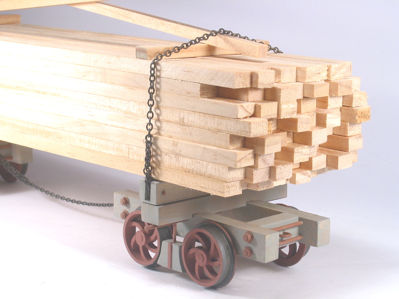

I'm intrigued by the diagonal timbers on top of each load. Are they used to tighten the straps, somehow?
Posts: 1720
Re: TVT - Mt Delusion O&K
Post by GTB » Tue May 16, 2023 3:18 am
ge_rik wrote: Mon May 15, 2023 7:18 pm I'm intrigued by the diagonal timbers on top of each load. Are they used to tighten the straps, somehow?
The period I model is the late 20's, when Aust. was in a building boom, just before the Yanks lost the plot as usual and dropped everyone into the great depression. No straps back then AFAIK, just chains and ropes.
Loads were usually chained on timber trams as far as I can work out and back then they either didn't have, or didn't use, chain tensioners. The 'twitch sticks' are used to keep the chain tensioned and the load more or less in place as the train jogged along through the bush. The VR had a different practice and used rope lashings twisted by twitch sticks to tighten the lashing, but that doesn't seem to have rubbed off on the timber companies.
The photo shows the arrangements I use, but I gather it varied.
