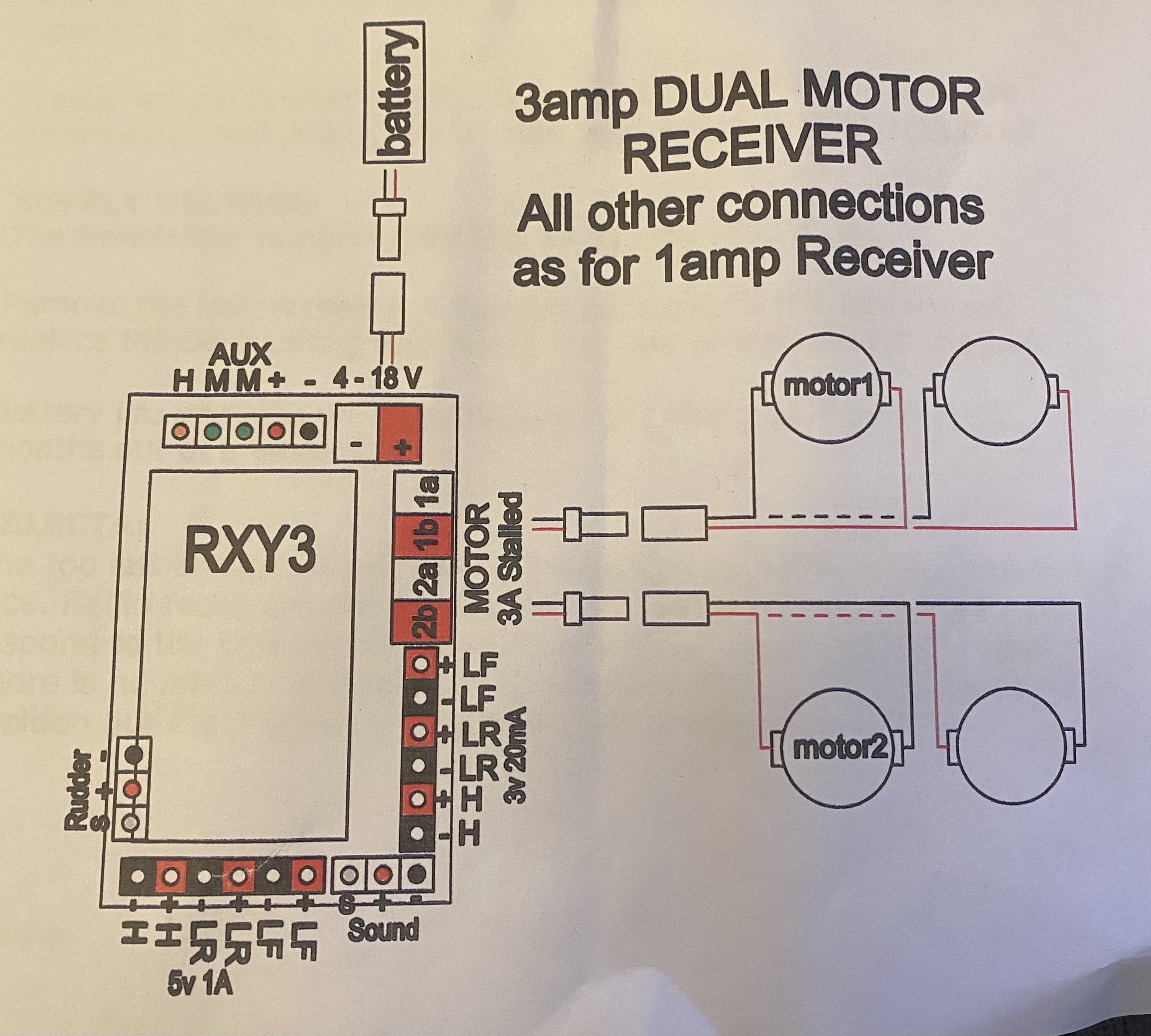

I've spent some time going through Rik's blog posts which have been really helpful! I've decided on li-ion batteries but I'm now confused at all the options that presents! It seems I might need to consider balance charging, but the pre-made packs I've seen don't seem to have enough wires to support that? Just red/black.
In terms of power requirements, I'd like to include:
2x motors
8 LEDs - 4 x forward, 4x reverse, so only 4 on at a time. There is scope for another 2 x LEDS in each direction, but not sure if that will be overkill.
Soundboard
Screenshot 2021-05-02 at 19.22.08.png (661.38 KiB) Viewed 13480 times
I have a Yatton Models receiver, which provides 3V 20 mA pins for the forward / reverse LEDs and can accept input voltage for 4-18V. I was thinking maybe this pack from RS? https://uk.rs-online.com/web/p/recharge ... ks/1449414
To save myself a little effort soldering I thought about ordering the Basic loco wiring loom from rctrains.co.uk. As for sound, MyLocoSound looks good but I've not had chance to do much research as of yet!
