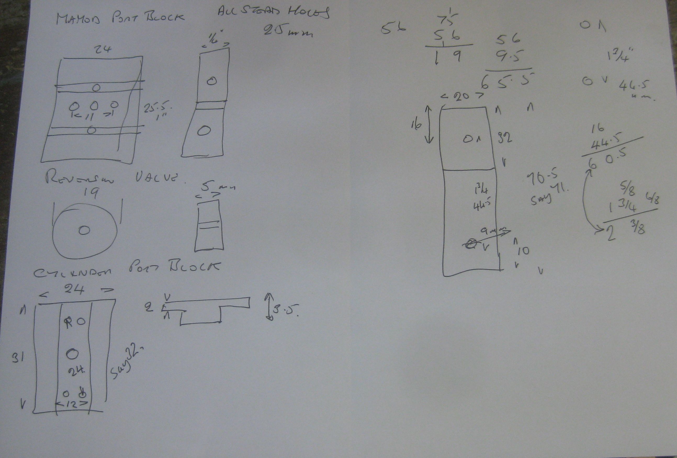

A really good video which makes me want to get on with my Ellie. Is there any possibility of you posting your engine dimensions, bit difficult to see on the video.

I made only two drawings making the engine both of which are attached.

The dimensions are the same as Mamod use on their locomotive: Trunnion to axle 1.7/8" (48 mm used), Steam Port centres 1" (25 mm used), Stroke 3/4" (18 mm used). If their are any specific dimensions you would like please ask.
Take care Tony.

Sorry looking at drawing I used 1.3/4" trunnion to axle.
